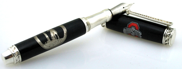

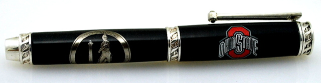

I still make them but just not often. My son called me about making a pen for his contractor who is a huge Ohio State fan and had helped get his remodel finished after the first contractor left him unfinished.
I called Seamus and he made me two Jr. size blanks with two different Ohio quarters.
I used the first one on a Tuscany1 solid sterling silver component set. It had to be a fountain pen as the shorter bottom barrel of the Jr blank used on the Tuscany is to short for a rollerball refill.

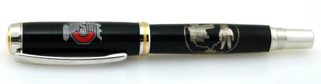

The second one is a Jr. Gent Rollerball
DSC_0010-001.JPG​

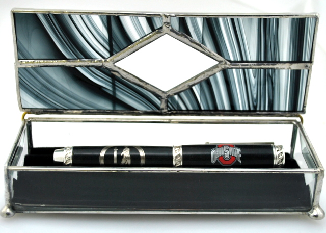

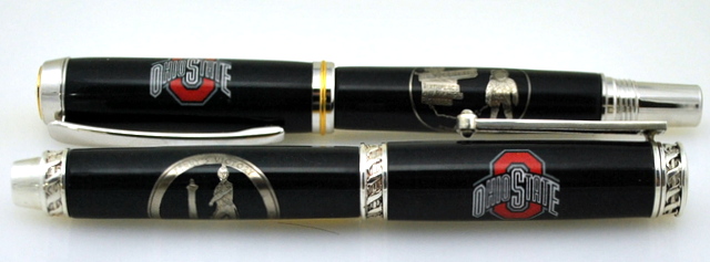

You haven't lost it Roy. Both are pretty damned cool and the box is very snazzy too!!
For me, I'd perhaps have chosen a Jr kit without the gold trim though. Maybe all chrome or even black ti. :wink: But hey...my opinion is only worth what you paid for it...:biggrin:

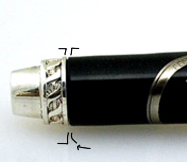

Seamus does quality work, nice contract job. The only faults that I can see, with out leaving the topic of the two pen kits, is the ends are not square. On the 2nd (the gent clone) it appears the cap end of the blank is slightly over turned, however that could be misleading from the photo. Perhaps a better picture of that kit is in order?
I took the liberty, this time, to show what I am referring to, just to rule out physics and so forth ;)

OOhh Boy...maybe the final isn't pressed in all the way...

Ed, once again your half right. These components are made as a slip fit not a press fit and the photos were taken of it before locktite was applied so the final was not set all the way in. Thanks for your critique.

As seen in the image about I am talking about the 'END CAP'. I said from the photo it APPEARS that the finial is over turned and smaller than the metal.
Perhaps you are indeed correct. For historical and educational value to those who have been in this industry for way less time than we have perhaps it would be wise to show another photo or two that was taken after, that way no one could look at this and say "Seamus does sloppy work, just look at that ugly gap there".
As for the 'slip fit' vs 'press fit' I will save that one for the bushings post. Also see first quote and image I linked, it's the 'end cap' not the finial.

Ed, wish I could post a photo when it was complete but the pen is on it's way to Texas. Now as to SLIP FIT, they are made that way intentionally because the parts are all solid sterling silver and if you were to have to press fit the components into the blank you would have the possibility of crushing the components, and yes you are correct it was the end cap but still not set up with locktite.
