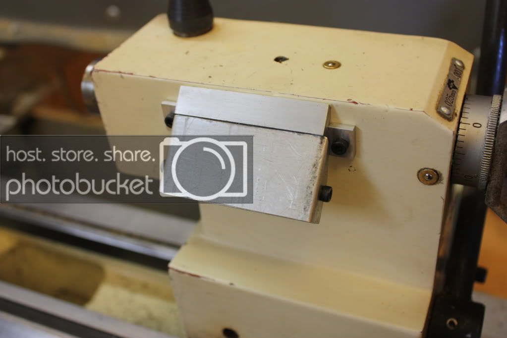

For some time I have been wanting a DRO on the tail stock of my metal lathe, particularly after adding one to the quill of my DM45 mill.
I have been saving various links of how other people have done it and my main inspiration for this one is a thread on HSM.

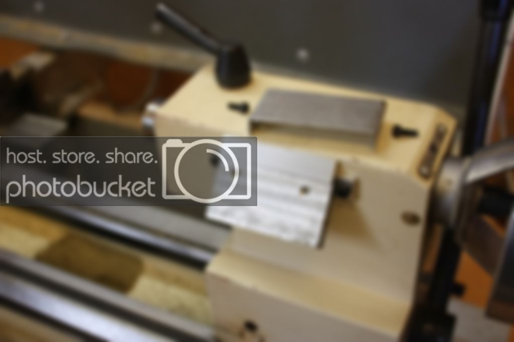

Ideally I would have liked the DRO to flat on top of the tailstock, but this is made impossible by the tailstock locking knob and the oiling point on top.
So I opted to go for the approach in the above link, but used a 45deg angle.
I wanted to be able to remove the DRO easily, so bent up a piece of aluminium to fit on top of the bracket.
Because of the angles involved I opted to make a template out of some 3mm MDF first.
This proved to be an easy approach and gave some precise measurments, time well spent.

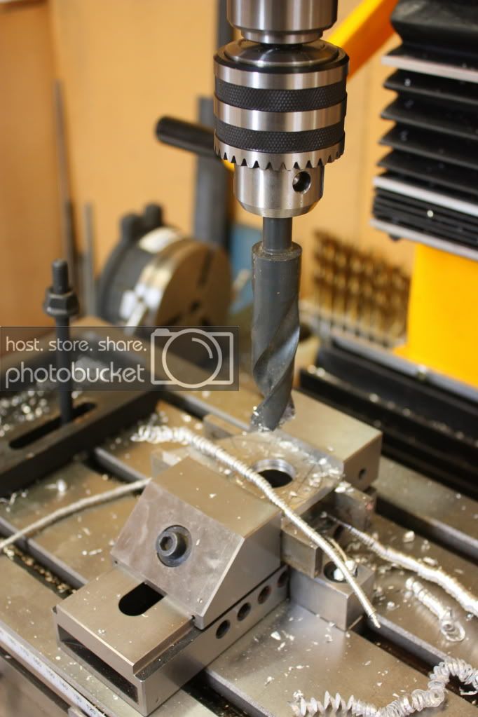

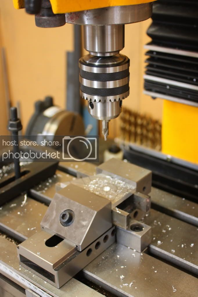

Once the template was made and the pattern transferred to some 6mm aluminium, I could start on making the 26mm hole for the tailstock quill.
Most of the metal was removed with a 7/8" drill, which proved rather quick.

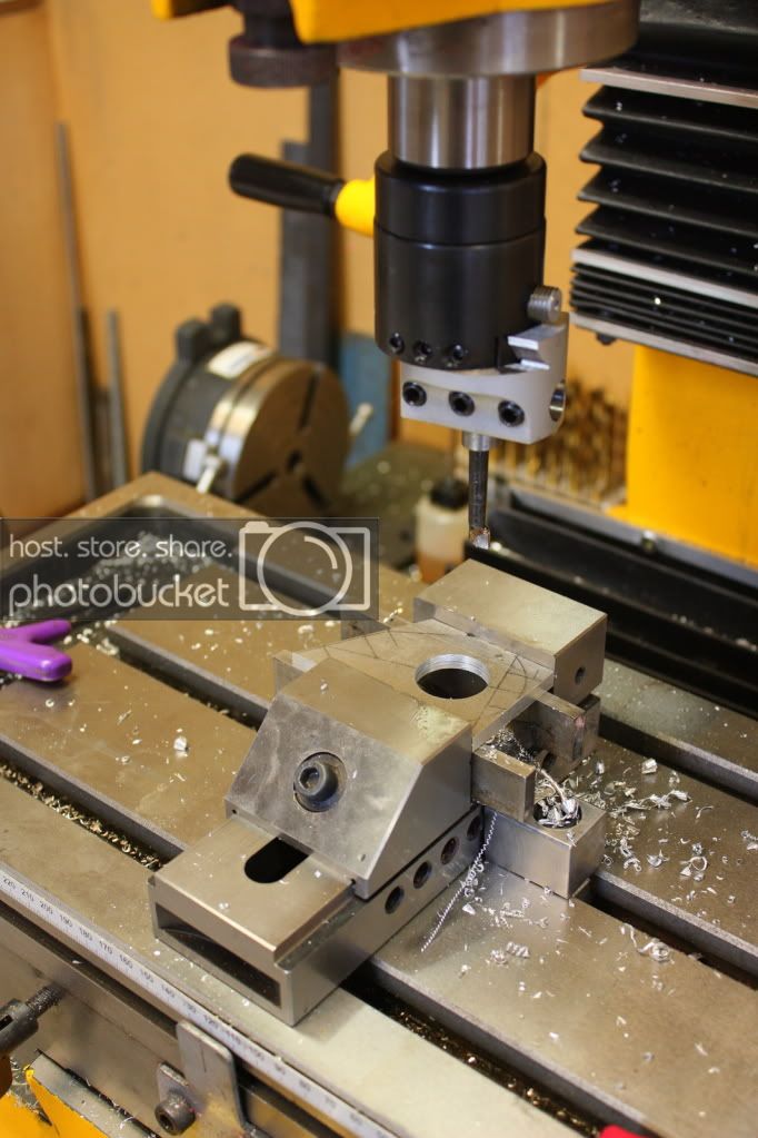

The on to the 2" borng head, first time I had used this tool, and what a great tool this is and so easy to dial precise adjustments to the hole diameter.

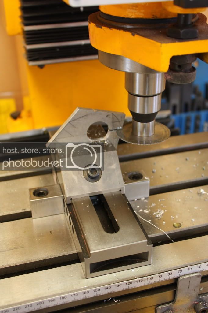

On to the slitting saw to make a clamp section.
After cutting away the waste material (on the bandsaw), we finish up with this
Attach the DRO to the loose bracket with 2 pack epoxy and attach to the fixed bracket
Made up a clamp by milling out a scrap of 6mm aluminium.
After drilling and tapping some holes for M3 socket heads, the monet of truth arrives
Happy to report it all works as expected
Would I do anything different if I had to do this again?
Yes, I wouldn't cut the slope on top that goes down to the clamp until I had made and attached the clamp.
But, I can always make another one at some stage, probably when it really starts to annoy me. But it is only cosmetic, doesn't change the way it works.

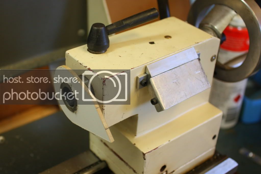

Whilst the setup shown above worked, it was prone binding because of the rotational force from the tailstock quill.
I had seen another way of connecting the DRO to the front bracket, but wasn't sure about the RC ball links and how they worked.
Went to the local hobby shop and bought a set to try, quite nifty and relatively easy to install.
This new setup allowed me to reduce the size of the front bracket as well.
I also shortened the DRO slide a bit further so now it acts as a stop so the tailstock quill doesn't run off the internal thread when I don't think about it, very annoying when that happens when you are drilling and the quill and chuck all of a sudden starts spinning
