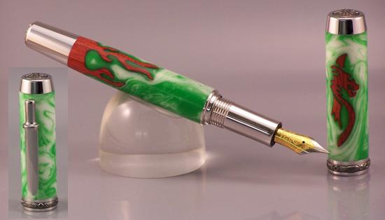

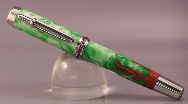

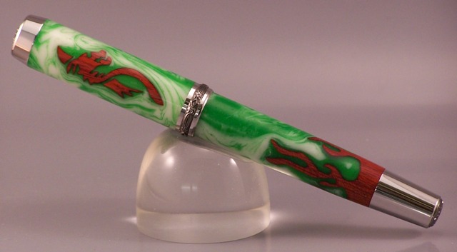

'Y Ddraig Goch' is Welsh for 'The Red Dragon' , the symbol used on the Welsh flag. I asked Jeff Powell to make up some 'Welsh' blanks recently after seeing his cool work. Although he made them to fit on a Jr sized pen, I decided to try one on a full size Statesman first. I'm looking forward to doing one on a fully custom kitless pen one day.:biggrin:

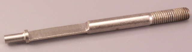

I made a the 'Dragon Slayer' clip from a stainless steel bolt
Thanks Jeff, they're all great!!!:biggrin:

Amazing pen, not only the blank but the clip too. How did you mount that to the tube? Or is it mounted directly to the blank? Interesting find on that bolt also. When I see stuff like this I think I should stick with peppermills...

............ How did you mount that to the tube? Or is it mounted directly to the blank? Interesting find on that bolt also. .......... Dale
LOL, Dale, the clip wouldn't last five minutes if just stuck to the blank.:wink:

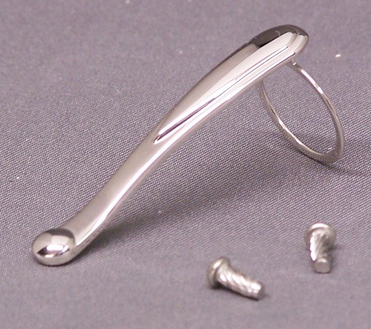

After I got the shape right, I filed one side of the handle flat to sit on the blank, leaving a (about) 1mm space under the blade. Then drilled two 2mm holes in the clip 'hilt' and two in the blank. I then had to press 2 Stainless Steel Hammer Rivets from the inside of the tube. I had to put a notch in the finial so it would pass the top rivet.
The bolt was a standard SS bolt. I cut the hex head off and turned the hilt. The rest was done with a file and %&£* ages with wet'n'dry.:redface:
Here's a pic of the the type of rivet with the original clip for size comparison
