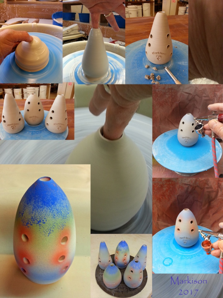

The Xun is the earliest known end blown vessel flute, dating back to the stone age in China, falling into final form and pentatonic tuning for palace orchestral music within the Shang Dynasty (1766-1122BC).
This commission was for 5 hand thrown harmoniously tuned porcelain Xuns for a musical family of 5. The challenge is to turn the thin-walled vessel slowly on the potter's wheel with just the right amount of water in order to create an acoustically proper and correctly tuned form, allowing for 10% post-kiln firing shrinkage - lots of trial and error. The holes are cut when the clay is leather-hard, positioned to play pentatonic intervals. Airbrush glazed outdoors (with a fan and a respirator mask), bisque fired, lightly clear glazed, then final fired at cone 6. Fun project, happy family:
attachment.php
I continue to enjoy slow turning of musical mud - deeply indebted to the musical ceramics Master, Barry Hall.
Happy Tuesday - Bob

WOW!!!!!
Thanks for sharing your talents Bob! Reading your posts/projects/techniques has been enlightening and a learning process.
Thanks, Sandy and Michael!

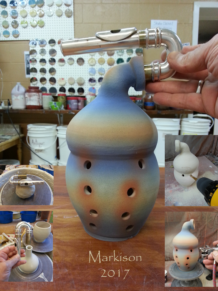

Never knowing when enough is enough, I then made a Xun 2.0: sweat soldered a flute head joint onto a knuckle of tuba tubing, then turned and joined 2 forms to create a larger/deeper pitched vessel flute capable of 2+ octaves with overblowing:
attachment.php
Eager to try it with some wood.
Happy Thursday! - Bob

Very unique! Never heard of those before. Thanks for the history lesson. Very creative. Now you can say that you can toot your own horn.
