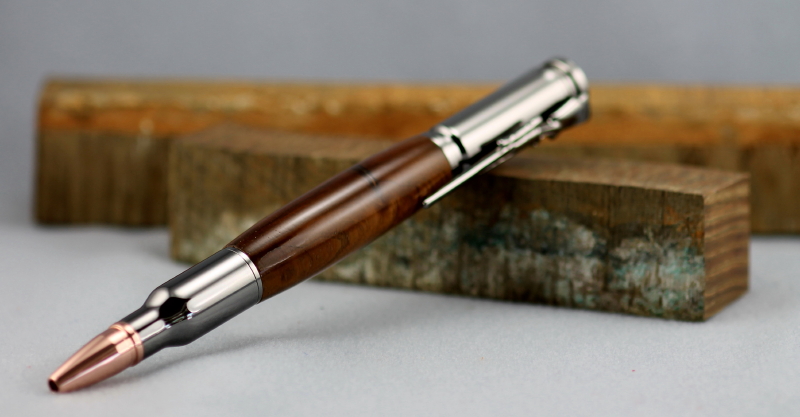

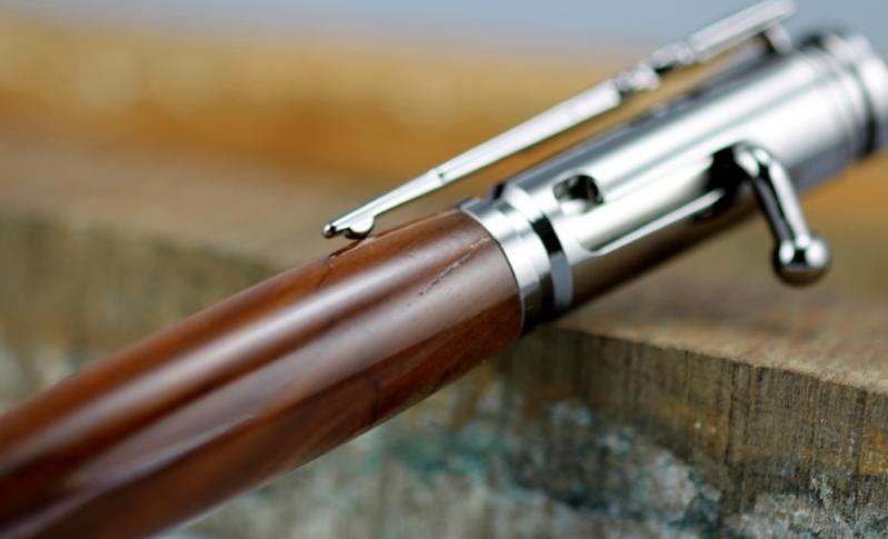

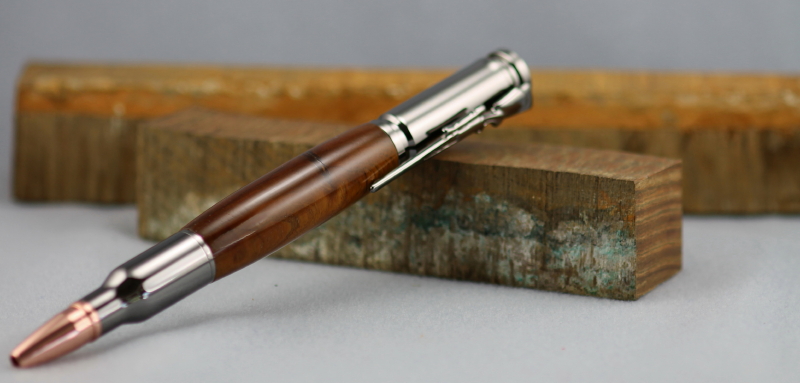

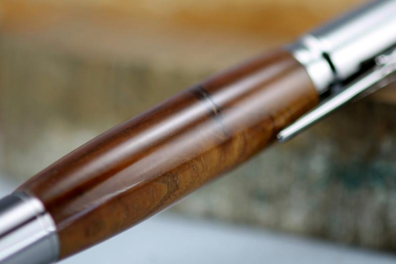

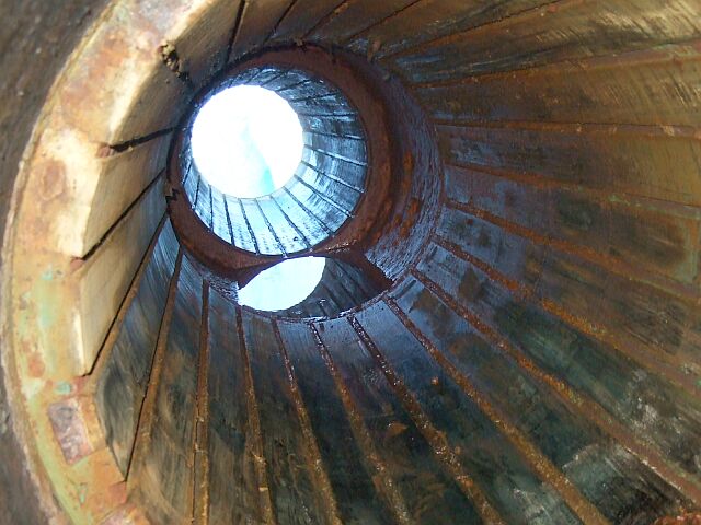

This is a rifle pen made using a piece of Lignum Vitae that was used to wrap the propeller shaft of the USS Mariposa. It was built as a cruise liner in 1931 and served in WW2 from 1941 in the Pacific ocean as a fast troop transporter.
The wood actually broke into three pieces as I was turning it so I repaired it with epoxy and wrapped it in twine to act as a clamp. I only have two full pieces of this historic wood, so every piece is precious.

I didn't know they used a wood for such a purpose, but I don't know much about that wood or ship building. Regardless, I think you did a great job in preserving a piece of history for someone to enjoy.

Beautiful pen and wood there! Believe they used it in ship building beacause of its self lubricating properties, made them basically maintenance free, for those who wondered...

I love LV! All of mine turns a cool green, but then mine doesn't dome from the USS Mariposa! And I agree with the others. That aged stuff has a great color!

Dave (et al) - It's my understanding that lignum vitae was used for a long time as bearing material in ships - like the one in the pic... even up to and including some nuclear submarines.

The Lignum Vitae that Steve used from the USS Mariposa was harvested some time inin the late 1940's Its a much deeper color than todays havested blank of Lignum Vitae.
Steve did you use a oil to finish her?

I used MM to 12,000, two doses of BLO and heated it up so it would sink into the wood well then CA to 12 coats.

Your purchase is a product made of authentic Lignum Vitae from the shaft bearing from the S.S. Mariposa. This product was taken from the bearing shaft when the ship was in dry-dock in Bethlehem shipyard, San Francisco. SS Mariposa was a luxury ocean liner launched in 1931; one of four ships in the Matson Lines "White Fleet" which included SS*Monterey, SS*Malolo and SS*Lurline.
