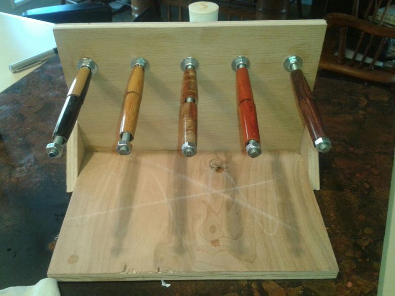

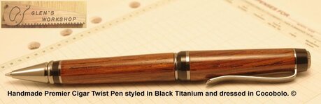

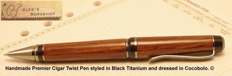

I started using WTF recently. At first I did it on the lathe wiping on per the directions on the bottle and then waiting for it to dry. This shut down the shop until the finishing process was complete; not at all efficient. My solution was to build the rack pictured using scrap plywood, all thread, nuts and washers. The rack is down the hall from my basement shop on a bathroom counter. I apply at least 6 coats of WTF with paper toweling sanding with Abranet 600 after the first two coats and then using MM 4000 between each of the remaining coats. I like the results to date and get much more done in the shop. Also shown is a Cigar pen in Cocobolo finished using this method.

Don, I really like that finish you got on the cocobolo Cigar...perfect in my opinion!!
