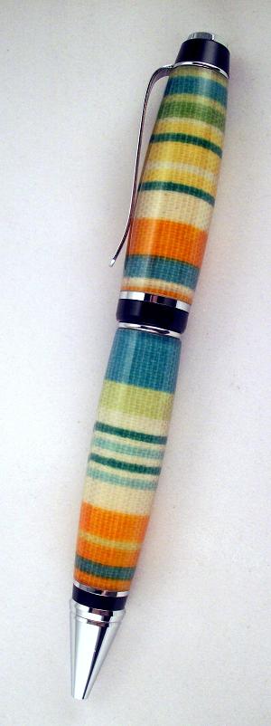

It should be just fine, as long as you give the CA enough time to cure and degas. I always wait a couple days before I cast, but Ive read where others give it 24 hours. I did some fabric pens a few years ago with no problems. Here's one that I still have a picture of. I would suggest spray painting your tubes before you glue the fabric on to it so the brass doesn't shine through. Good luck!

thanks. John, that is a really pretty pen. I was also thinking of trying this with epoxy. I can brush it onto the fabric layers as I go, and it has a longer working time than the CA does, especially if I use a 10 or 15 minute epoxy.
