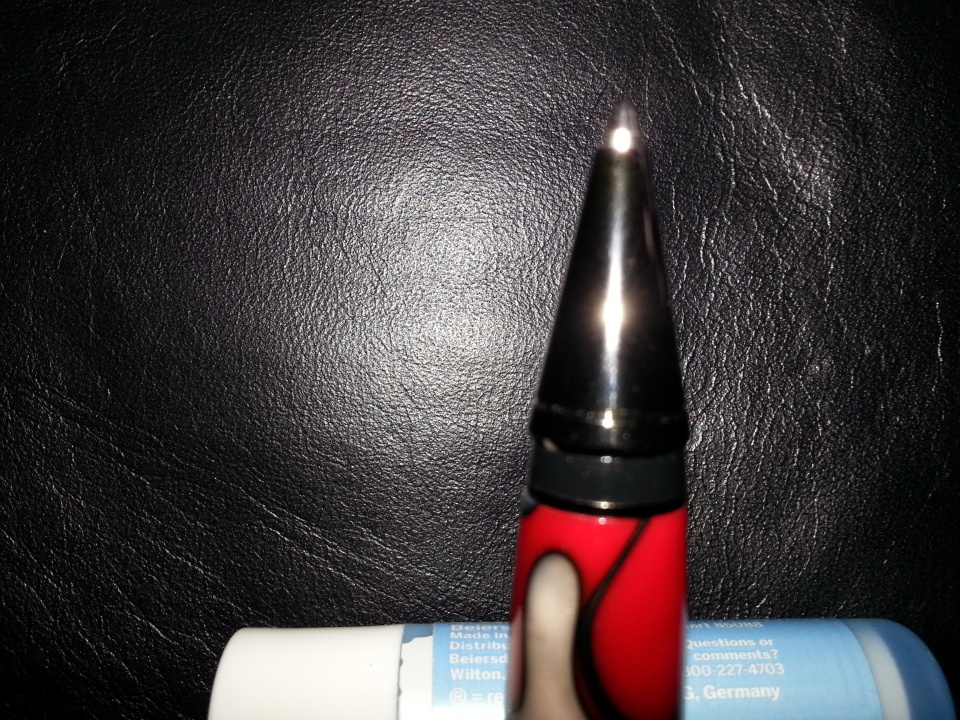

What do you think of the point length?
Thank you! All excellent advice. I trimmed the barrel without incident and probably picked-up a "hair" in length. My good friend and pen turner, thought it was fine before the trimming.
Here's a picture of the point. The flash actually makes it look a little taller. It's not easy to take a pen point picture with a cell phone (at least for me).
Thanks again!
Thanks again!
Looks great Tony
Harry
Then, it is just my sharp writing angle. I feel like the end of the nib is too close to my writing surface/paper. Thanks for the feedback.
I think you should jus make another one and trim a little more of the next barrel. Pens are like people, each one is uniquely perfect.
