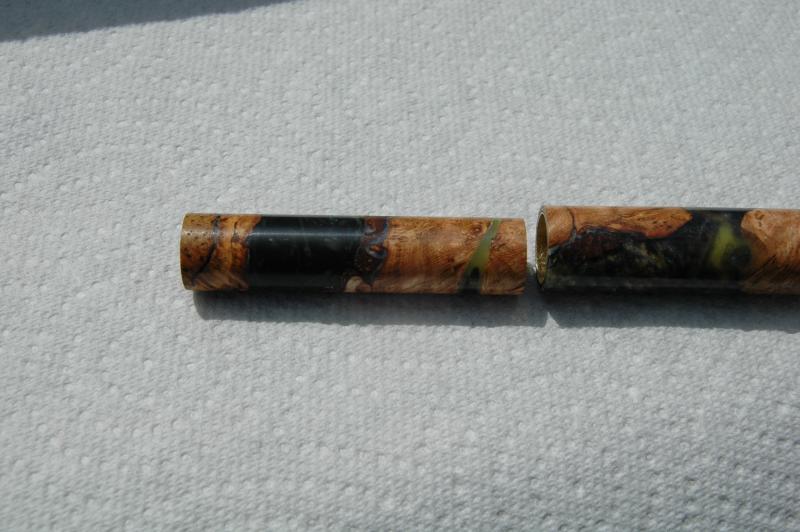

I've done two worthless wood blanks and they both have milky/cloudy spots
in the alumilite in the smallest nooks of the blank. This has happened when sanding. Is there something I am doing wrong? What is the best way to sand one of these blanks?

No, Curtis they aren't your blanks. These are my first attempts with WW and Alumilite and I noticed the same milky spots on both blanks, but I don't notice those spots on other peoples pens. I would like to get into casting my own, someday:tongue:, but not if I can't get them right!:mad:

Where are the milky spots? It is hard to tell by the pics. Would it be possible to take some close-ups of the area in question?
David, It is most definately not Alumilite that has not cured unless you did not get it mixed thoroughly. Without seeing close up pictures, it is hard to say for sure.
To both of you...always make darn sure you are getting itujjkpo;/ mixed thoroghly. Throw away Alumilite's direction on dye...mix your parts A and B BEFORE adding any colorant of any kind. Use a clear plastic cup and you will be able to see when the 2 parts are thoroughly mixed. When you first pour them together, they will be cloudy. Mix until it is completely clear with no streaks. Then add your colorant.

Still can not really see it that well but I am wondering if it could be tiny air bubbles up agains the wood? Is you wood COMPLETELY dry?

I'm fairly certain the blanks are dry and its possible they are air bubbles since the only place the spots show are in the tight, small crevices of the wood. I'll just keep trying. :rolleyes:
