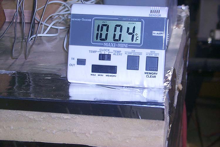

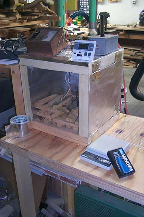

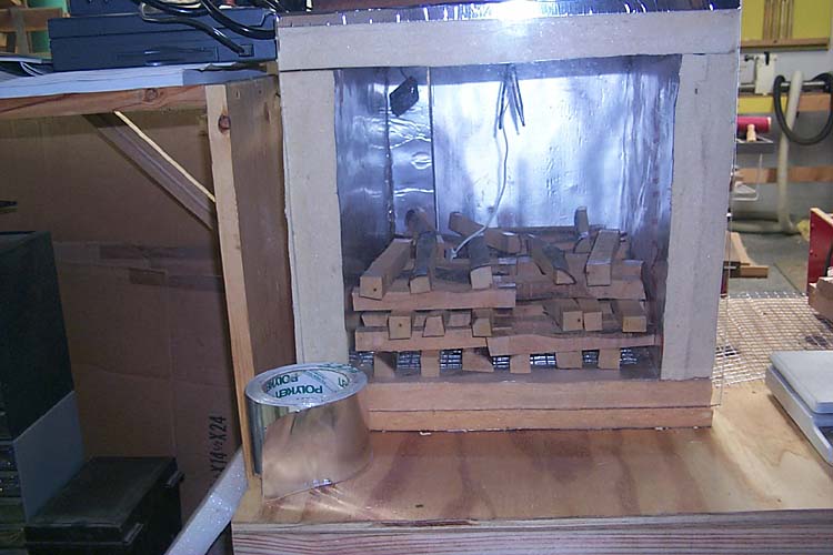

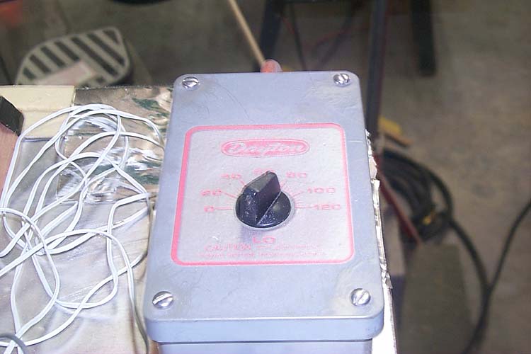

Here's mine I have been using for years to dry blanks, speed cures, and most anything else I need about 100 to 200 degrees F for. It uses a 100 watt bulb from the bottom and a little pancake fan in the upper corner to keep the heat even.
