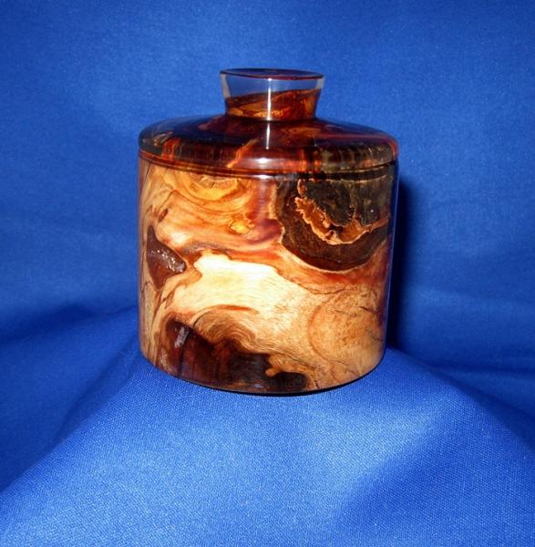

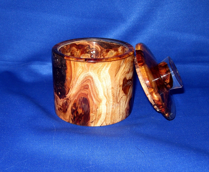

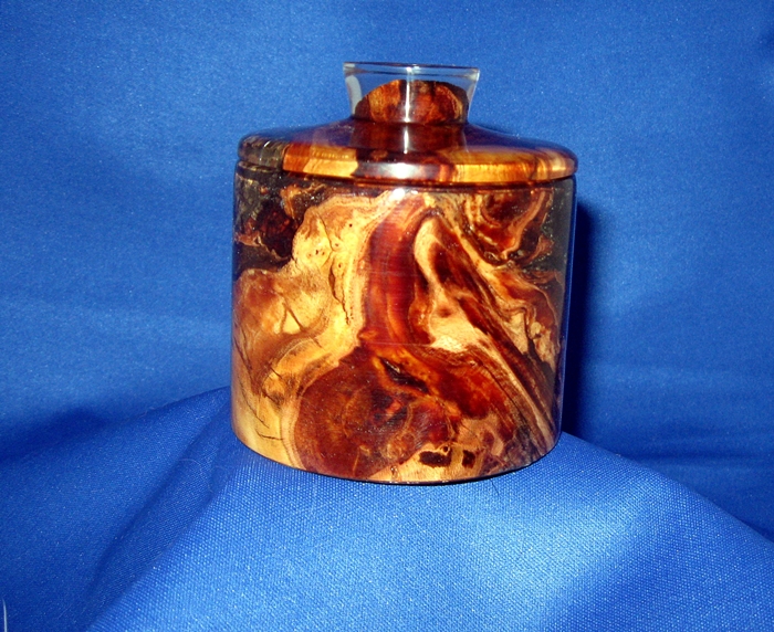

I had a piece of wood that was soooo punky I just couldn't hold it together, but it is so pretty I just couldn't give up on it. So, I decided to give a try at casting it. I roughed it out as best I could, made a mold out of a plastic container. I put a small container inside (pill bottle) so I would waste as much Alumilite. Poured it and stuck it in my pressure pot for a few hours. Than I did the same with what was left of the lid. Then I turned it. I ended up with this little plastic box! My wife doesn't like it. I haven't made up my mind yet. No matter it was fun.

Well thanks for all the nice comments. It is finished by sanding 220 through 600 sand paper and then all the way through with micro mesh, followed by Hut plastic polish and a coat of Res. wax. On the lid I used Brasso for polishing. It seemed to work better than the Hut Plastic Polish. I don't know why.
The shaving mug is a good idea. If I had more of this wood, I make a shaving set out of it.
