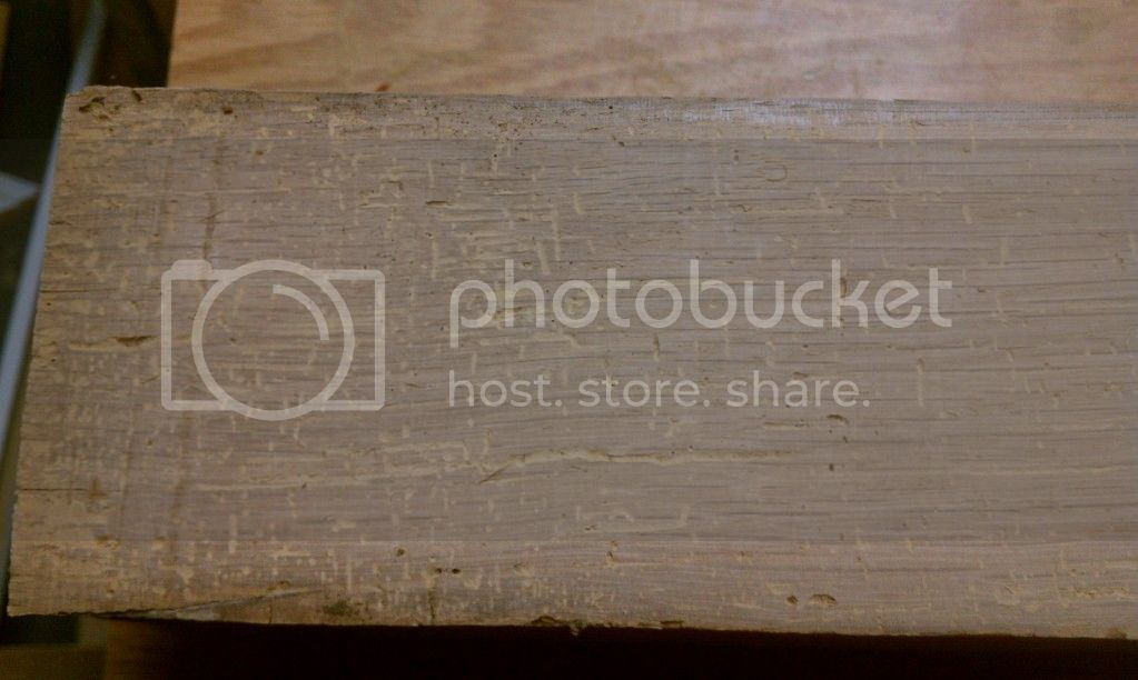

Wormy old growth oak. Usable?
gomlin
Nov 22, 2012
12
Findlay, OH
A friend gave me a bunch of wood from his barn. I have this block of wood I would like to make a pen from as a gift for him. The block was a chunk from the barn itself. I am new to pen making. Is there a way to capture the wormy look with the saw dust in the tunnels in the wood? Seems like when I turn it, it will not retain the look. Thanks,
Jim
a>
a>
You can turn it, then before finishing, fill the holes and trails with sawdust and coat with thin CA. I do this while the lathe is on slow speed. Then sand back to smooth, repeat if necessary, finish with normal finishing technique.
