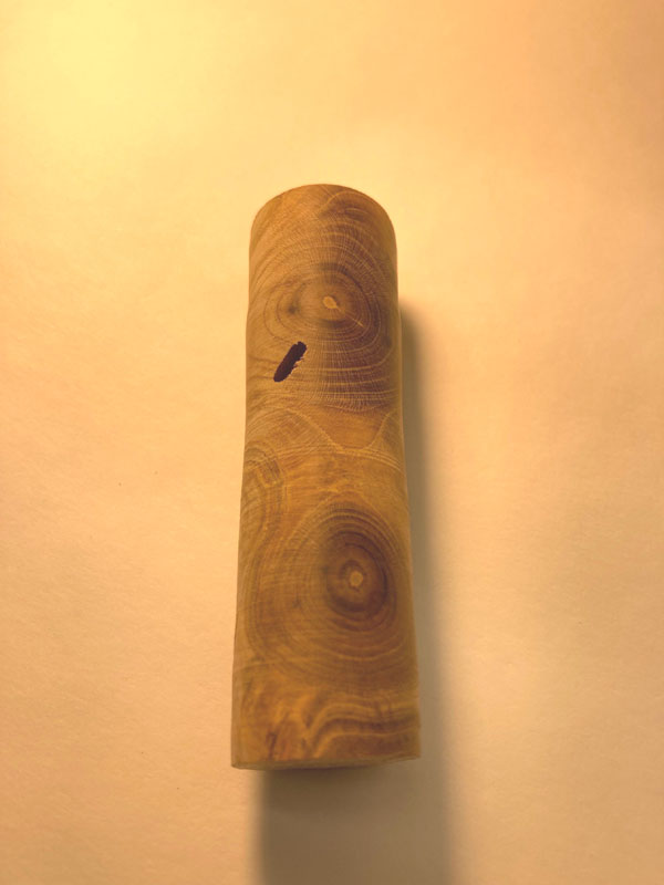

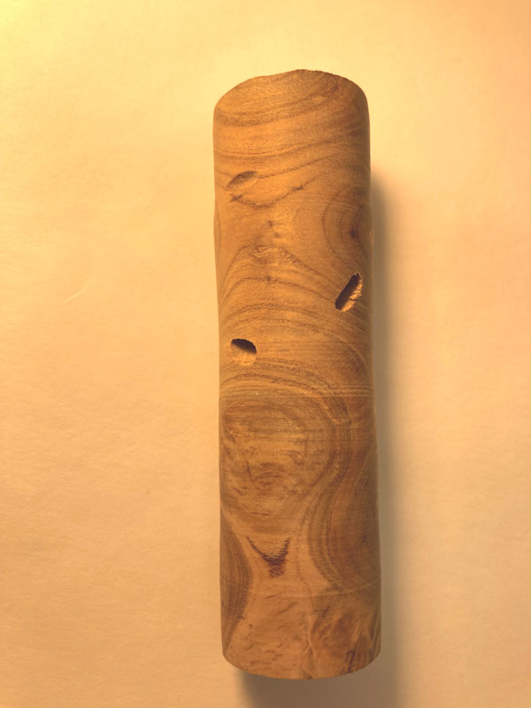

This blank is from an apricot tree my boss tore down. Before rough turning it looked like it had potential. After rough turning, these worm holes appeared. Any suggestions on what to fill them with to salvage this beautifully figured blank?? Or any other suggestions are welcome. Thanks in advance.

That blank didn`t really need any additional features . My choice would be clear cast , if I wanted to emphasize the wood grain as the most important feature . If you want the holes as a secondary feature . I think the best choices would be casting in black , turquoise , or ruby red . The type of finish you apply will also affect the impact of whichever you choose .
Kenny Durrant
Sep 11, 2012
2,498
Sachse Tx. 75048
Here's my two cents. If they are already tubed I'd put them on the lathe and sand the blank to get enough dust to fill the holes. Then pack the dust into the holes and seal the dust with thin CA. Don't use any excellent to avoid foaming. As you turn and/if more holes appear just fill with the dust and keep going. They will still be visible and should flow with the rest of the blank.

It's hard for me to judge the state of the wormholes from the pictures.
If the edges are clean and no darker than the surrounding wood, then I would agree with Kenny and use sanding dust mixed with CA or epoxy. Frankly, my experience has been better using epoxy for filling voids compared with CA, but others may have different experiences.
But my experience is also that holes like that are often also discolored a bit, and using sanding dust can creates donut-like circles. So in those cases, I prefer coffee grounds and epoxy. A light-colored infill will only accentuate any discoloration that may exist, while the discoloration won't be noticeable next to something really dark like coffee grounds.

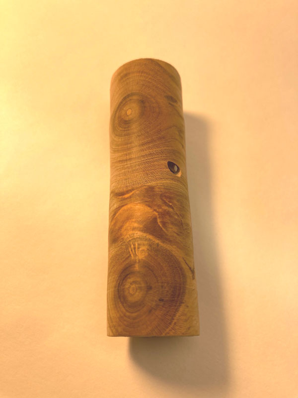

Here's one that didn't turn out like I expected. Filled with sawdust and then CA. Obviously, the wormholes in your blank are different and may look better, but getting it to match the surrounding wood is going to be tough.
