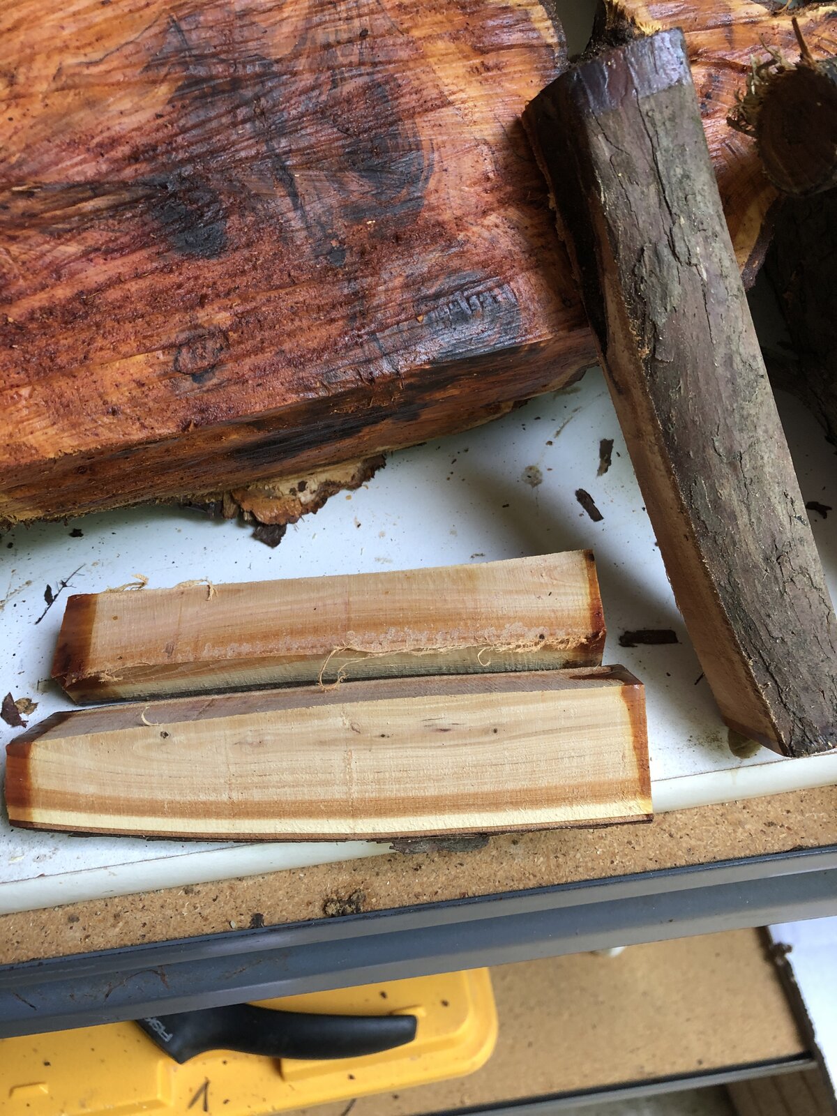

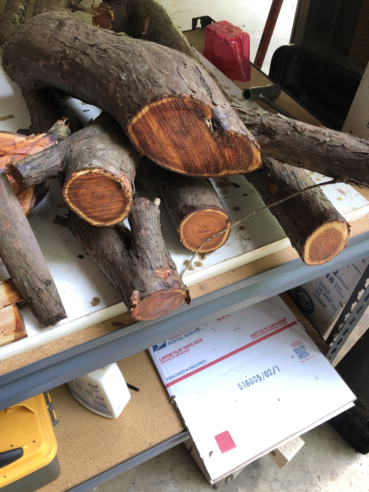

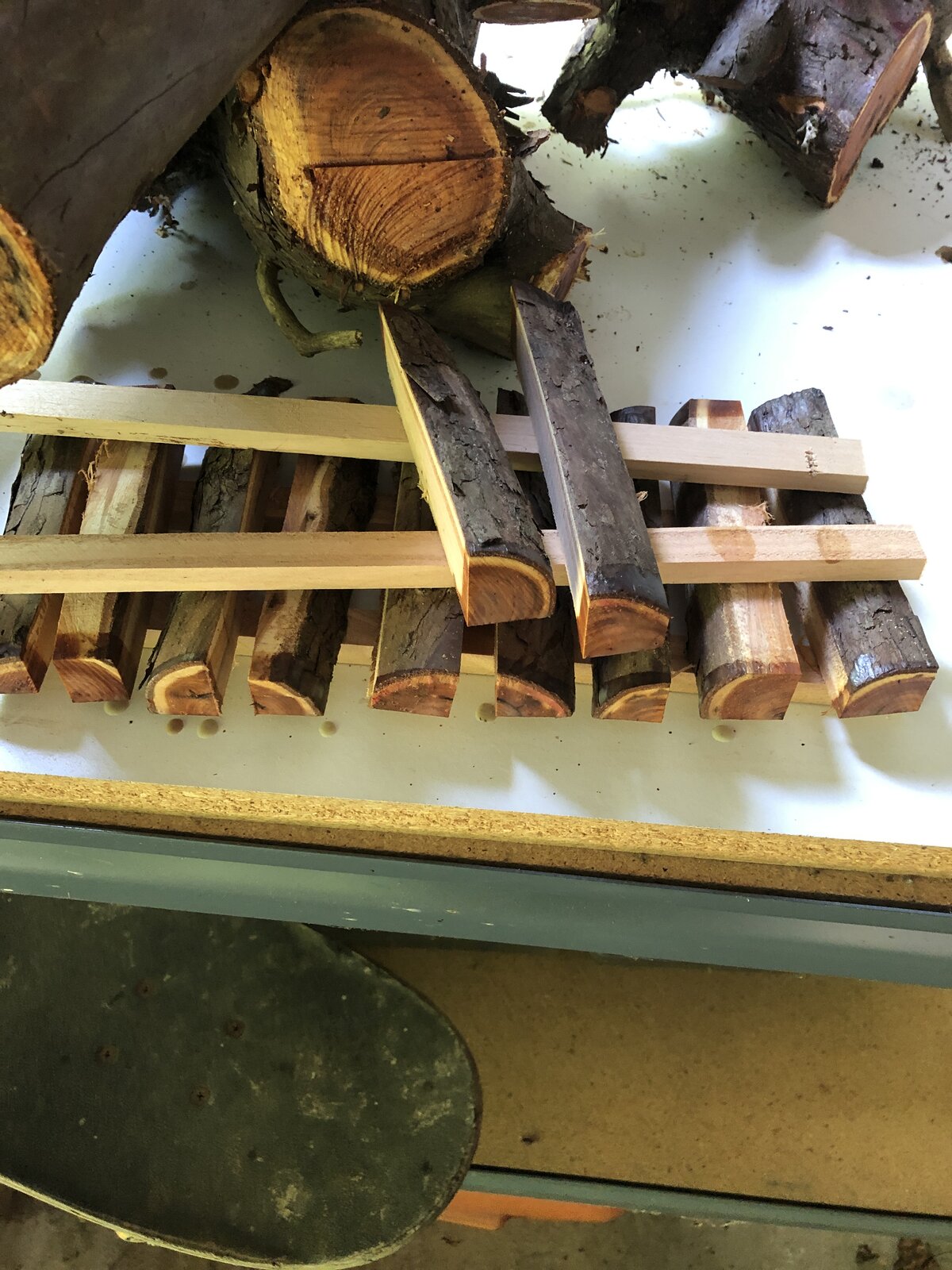

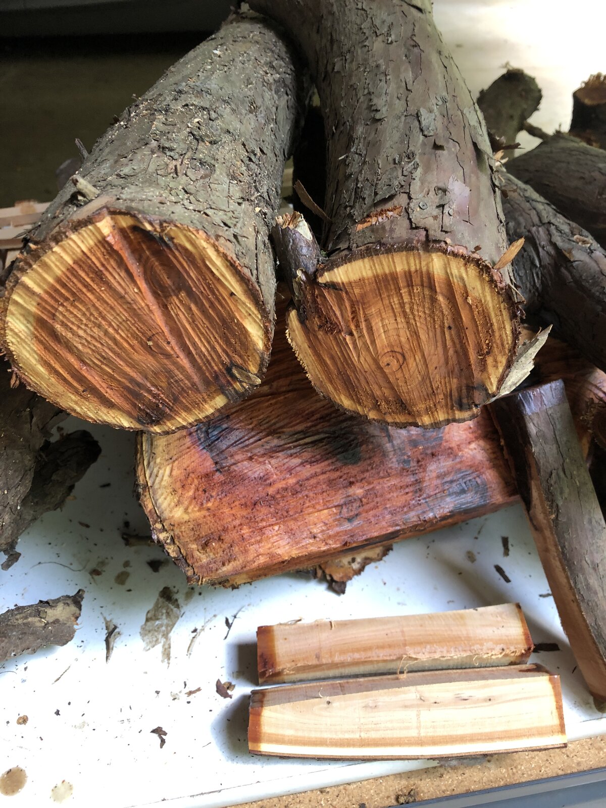

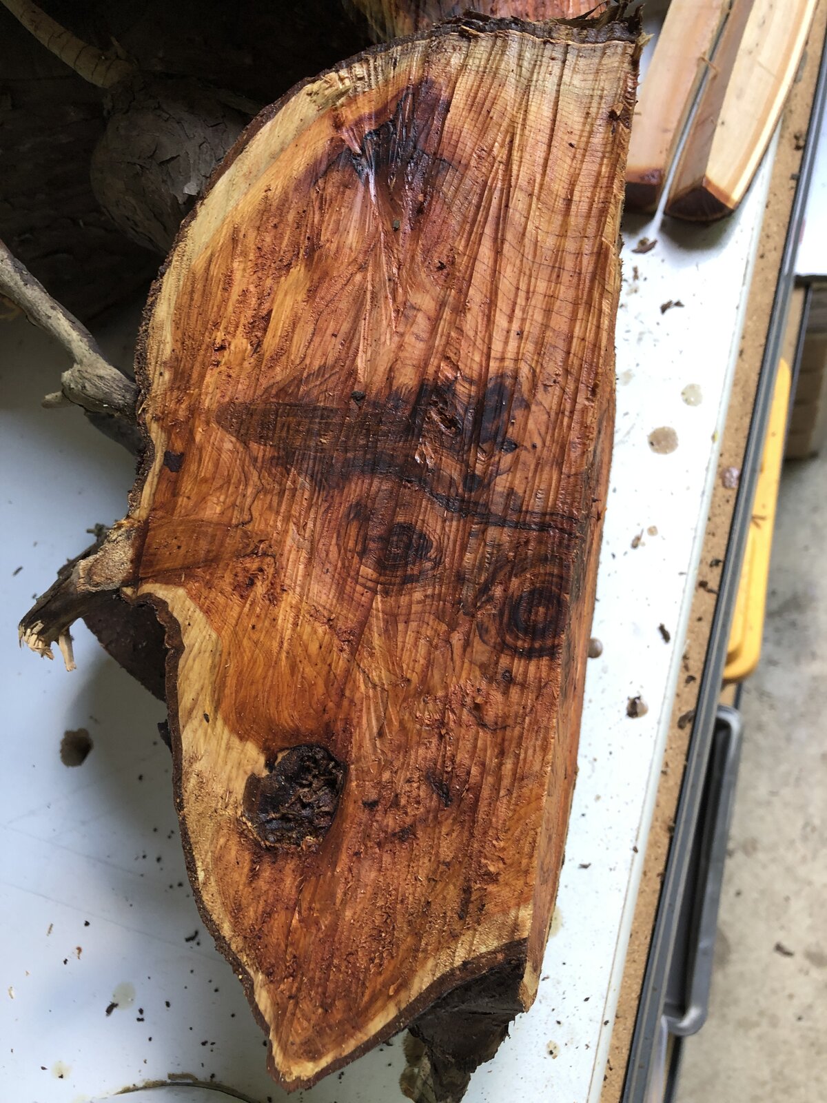

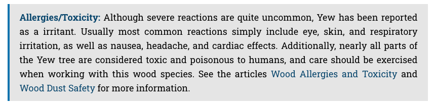

A recent 'chore' I was assigned 🤣 was to cut down several dead and essentially dead bushes alongside of our driveway. My best guess is that they are 'Yew'. The exact species I am not certain of. Just a few red berries with a dark 'pip.' Needles are flat and horizontal, not circling the twigs. I live in Northern Ohio. They were most likely planted by the previous homeowner possibly in the 1970-1980 range.
I cut the largest one first and was delighted by the colors/grain. The stump will be interesting, and several of the limbs will get some pen blanks. During my search for information, I read repeatedly about the toxicity of the needles, berry pips and the bark; as well as extra caution for the dust. I usually do not eat my raw turning materials, so I'm OK in that regard... But, has anyone had adverse reactions? I have seen many turned objects with Yew, so I assume with my typical precautions (Cyclone dust collector, overhead air filter, respirator, tight long sleeve turning smock) I can proceed after things dry.
Just looking for any negative experiences. The pictures show what I have, the ends have been coated with Anchorseal.

I think you would be fine with those precautions. Yew contains many seriously poisonous compounds , taxanes which are used ( derivatives of the original compounds ) to treat cancers. It is possible to get a severe allergic reaction to it if you are sensitive. Once dried it is far safer so if thats fresh wood treat it with GREAT Care
I would NOT use them for anything which might tempt someone to drink out of it ,although once sealed in contact with fruit etc it should be safe, emphasis on SHOULD as if fruit oozes juice, finish gets damaged etc then theoretically there maybe a risk. I made a large bowl for my mother to display fruit in but it was well sealed .
For pens it should be fine BUT for bowls be warned it can , and does fracture without warning often. I wear a face helmet and my first one saved me from a serious head injury when a " final cut " was one step to far and the bowl split . Half bounced off my protective face shield, off the wall behind the lathe, cleared the car and left a deep indent in the heavy fire door. The other half, razor edged span rapidly as I hit the off button in shock. I still have the bowl, epoxied back together to remind me !

If you do not know if you will have a reaction to Yew, my recommendation is don't take any risks. I've heard some people, and most likely myself (although I've not been exposed to Yew yet) as I have had some severe reactions to other woods so I'm particularly careful when it comes to PPE, do indeed have severe reactions to it and it CAN be potentially deadly. It is toxic, as it produces Taxine alkaloids, which have caused death in humans.
Even if some people have not had reactions, it just isn't wise to disregard the fact that this tree IS toxic, and CAN be deadly. I would protect yourself. At the very lest make sure you wear sound breathing protection. Our skin can absorb toxins as well...on numerous occasions when I've watched people turn Yew, they have completely protected themselves...lightweight long sleeve jacket or shirt, gloves, to make sure they don't get too much dust on their skin.
I just feel it would be a terrible situation to be told "Its fine, you won't have any problems" on an internet forum, and have someone have a severe reaction to the wood in any way, or even more horrifying, die as a result of poisoning. 😨
