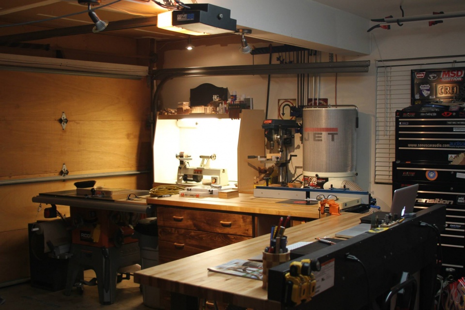

When I got my lathe April 11th this is where I stuck it - on the kids' workbench.
I have a 8' fluorescent in the garage and three LED spot lights so I can direct light where I need it, but with the garage door up one of the LEDs (the one above the dartboard) was blocked by the door. I wanted better lighting so I could more easily see scratches and low spots during finishing so I came up with a solution.
Tonight I started working on a contained, better lit spot for this lathe. Used some 3/4" and 1/2" MDF I had left over from a car audio project and picked up some melamine to laminate the interior portion with. Also grabbed a 2' dual-tube T5 fluorescent that's rated for 2400 lumens. The front will have a lexan shield on a piano hinge.
Raw MDF
And with melamine rough cut and stuck in place.
Will laminate everything tomorrow then break it down and send each piece through the router to flush trim before final assembly.
Forgot about this thread. Made quite a bit of progress.
Picked up a JET DC1100VX-CK and moved the table saw and router table to that side of the garage while leaving nice, wide walkway between them and the lathe area, dust collecter, and little Craftsman toolbox.

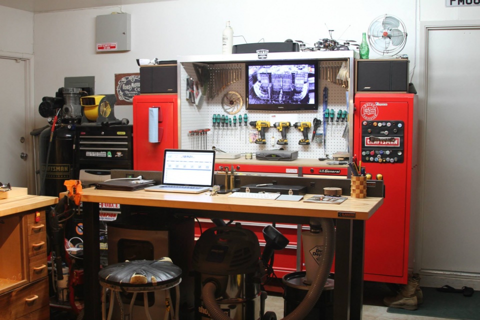

The other table is situated in front of the big toolbox. When I want to take a break and get on the computer I'll take a seat here. (I know, the stool needs to be recovered:redface:) That toolbox is a 56" unit from Harbor Freight (awesome deal when they're on sale) and I added the side lockers for their 44" box then built the upper hutch with pegboard storage for commonly used tools (so wife/kids/neighbors don't have to rummage through the drawers) and made the steel reinforcements in the back wall spaced for VESA standard TV mounts.

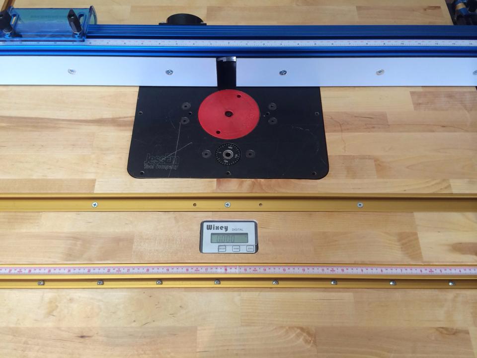

The router table was made from 3/4" birch ply. I already had the lift (was given to me by a buddy that owns a car audio shop and bought four new lifts when he built the new shop. He kept one of the old lifts and gave me the other. :smile: I ordered a couple of replacement parts and it's good as new.

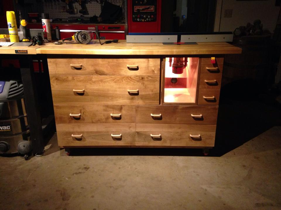

Anyway, I wanted a router table with good dust collection, a large work area that would allow me to have pieces hang over each edge yet still be clamped down, and plenty of storage. Woodcraft had 1 1/2" birch worktops on sale so I picked one up and got to work.

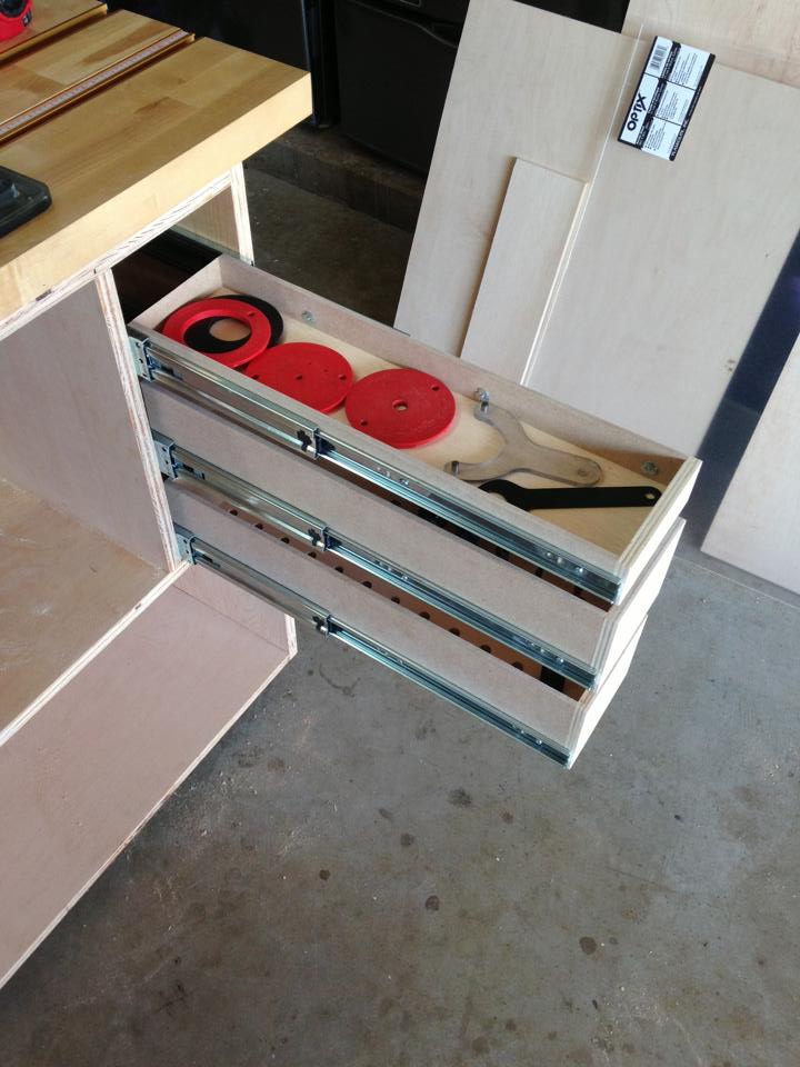

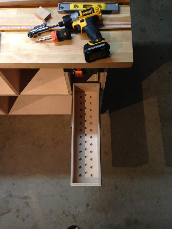

I'm right-handed so I made three 19" deep storage drawers to go on the right side of the router chamber. The top one holds various inserts, collet wrenches, and Allen keys for raising and lowering the lift. The middle drawer holds 1/4" bits, and the bottom drawer holds 1/2" bits. I laid them out and drilled with appropriate sizes Forstner bits. I also stuck a short piece of dowel in the front of each bit drawer to hold the proper collet. All of the drawers are on 18" full extension soft-close drawer slides. A Wixey remote router readout is flush-mounted in the middle of the router table - between the Incra miter track and T-track. I made a plexi insert to allow me to access the Wixey's buttons but still protect the display.
I used a Kreg router switch (gutted it) and ran cabling so that I can plug the workbench into the wall and when I flip the Kreg switch on it will turn on the router, internal router chamber light, and a power outlet that's installed in the rear wall of the table. I use this outlet when I use the router with the Shop-Vac. Leave the Shop-Vac on and just flip the switch. Since the power switch and cabling are above and behind the drawers, I made a L-shaped channel for cabling.
The other drawers are all on full extension soft-close slides and hold all of the major power tools, router templates for car audio, Dremel and Kreg storage boxes, and other large items. Drawer fronts are 3/4" maple with 3" wooden pull handles from an Ace Hardware that was going out of business. Finish on the maple and birch ply is a Dark Walnut Danish oil with some clear (forget what) with natural finish Danish oil on the drawer pulls.

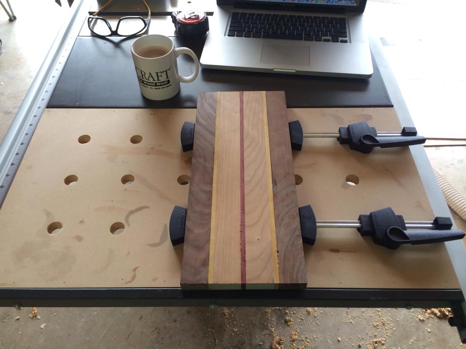

The other main tool in the shop is the table saw. I picked up a Ridgid 4512 out of necessity - I needed it for a car audio project and the circular saw just wasn't going to work. In the table extension I drilled a series of holes so I could use Festool clamps to hold projects in place.

I clean daily and everything is wiped/vac'd down or blown off with the compressor and put back in place when I'm done. I've found it's easier to be efficient when things are clean and organized. Memory problems kind of forced me to be more organized. :roll eyes: I vacuum the floor daily.
I have a Mac Mini that stays out there in the hutch (to the left of the cable box). It's connected to the TV. I chose the Mac Mini because it's small and doesn't have open vents for dust to get in. Bluetooth keyboard and trackpad have been reliable in the garage. I much prefer the trackpad over a mouse out there.
I'll bring the Macbook or iPad to the garage when I have something on the TV that I want to listen to while I work or - when I'm doing car audio or maintenance stuff - I need to plug into a car for diagnostics. The iPad is nice when I'm in a car and need to pull up schematics. Typically, though, the Macbook stays in the house.
