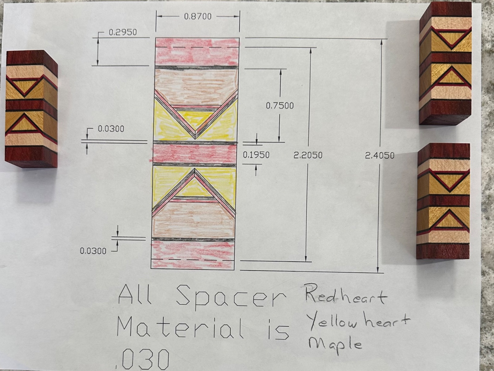

Going to offer this design on Etsy, once I get several color variations done. Another relatively easy and fun blank to make. Comments and critiques welcome.

I love how detailed your plans are. I need to start spending time to doing stuff like that - helps prevent mistakes.
Do you use a table saw or bandsaw for segmenting?
Coloring them in helps a lot too. All these cuts were made with a table saw but I also use my bandsaw in some other designs.
The superb attention to alignment and detail - I admire your precision. (Back in the day... doing the detailed diagram was almost as fun as the actual construction, and vastly important for a successful blank). Folks may notice the alignment on four sides, but the alignment as you rotate a final turned cylinder will reveal any flaws. Your precision is artistry. 👍 👏 👍
Thank Mark. Yes I enjoy doing the drawing too.
