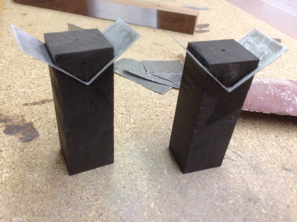

My little helpers ...

I think you are finding out how fun it is to experiment. The hardest part for me was drilling. That is where you need very sharp drills. No brad point drills.... I use just twist drills and sharpen often. Do a little and wait do a little and wait. I never tried any of the popsicles stick or wrapping with string. I would figure out the center, turn between centers to knock off the edges then that would establish the center of the blank so when I drilled on the lathe things were just at center. Hope this helps you out. Don't give up either...
Speaking of drilling when segments with metal pieces are involved: I have found that if I can visualize how the bit will "bite" or slice unto the thin metal, then reposition the blank (end to end) if need be to achieve a less aggressive entry into the metal, I have better success. Less chance the drill bit grabbing the metal.

Those little minions are the bottom half of a matched pen/pencil pair with a striped ebony top that I wanted for work. I think if I can get them drilled successfully, I will be home free. I am doing the drilling on my lathe now. You can see the center punched on the top of the minion's noggin. I wanted so much to dive right in and drill tonite but I thought it would be better to wait a couple days to make sure everything was set.
