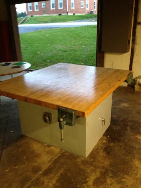

Mine came out of a school shop. I have several others with plywood tops as well.

Nice bench Dan. They shut down our middle school shop class. Cleared everything out to put a computer lab in.
Unfortunately they left all the benches like that on outside unprotected all winter. By the time of the auction none were salvageable. I even pointed out that they would get ruined in late august when I saw them. Their response was "no one will want them anyway." I said I would take two off their hands but they would not go for it. Lots of people at the auction were as saddened at the waste as I was.
That's a minor tragedy.
They are closing one of the local middle schools this year. I'm just waiting for the next sale.

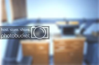

Performax 16/32 drum sander. Believe me the shop looks alot different than when tose photos were taken. Way more tools have been added. Sorry but these photos were reduced some time ago. You will have to blow them up yourself.
This is one of 2 lathes. Since added a dust port and got rid of the cardboard backing.:smile: This is the Jet 1014 that most of my pens are turned on.
The drum/ disc sander was the latest toy I added 2 years ago. That is another one of those tools i wonder how I did without. I need a bigger shop for sure.
