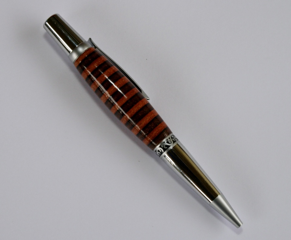

I've been using WTF for some time now an I love the finish I get. I use paper towels (select a size) and use half a sheet I fold it up until it about 3/4' wide. I put 3 to 4 drop of WTF and with my lathe turning at about 700 RPM I wipe it on left to right then right to left. I let it dry for about a minute then use four more drop this time right to left then left to right. I do this until I have 5 coats. I let this dry for about 5 minutes then lightly sand with 3600 MM. I put on another 5 coats and let this try for about an hour and again lightly sand with 3600 MM I add 5 to 10 coats more. After 24 hours I buff with 6000, 8000, 12000 MM. Many people here have ask if my finish was CA. Below is on of my pens with WTF finish.

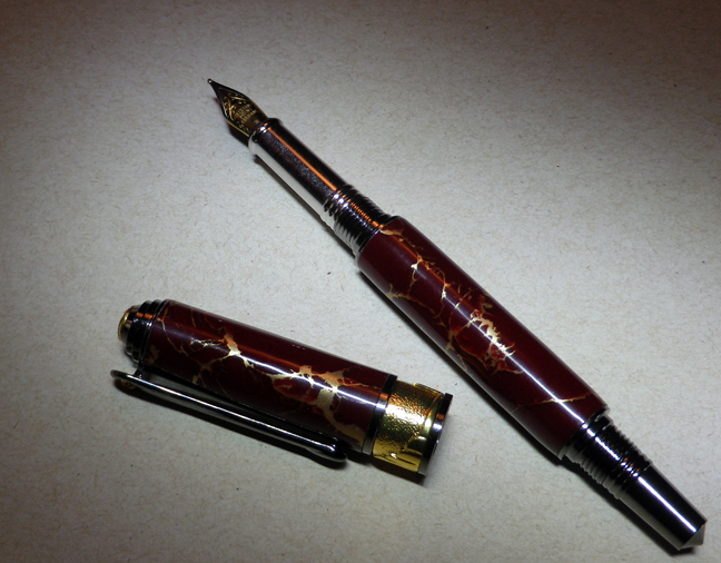

Hi,
I am quite new to pen turning and want to learn as much as I can. So far I have determined that finishing a wood pen is quite different than other materials (duh!). For what its worth here is a Tru Stone for a fountain pen I made yesterday. After turning I sanded to 12000 grit. Then did 5 applications of Ultra Shine and the 5 applications of Renaissance wax, polishing each time with a paper towel.
I like the end result and was wondering if I should have done something different.
Thanks,
Peter
Hi Peter,
I love turning trustone. These are the steps that I do. I have been getting good shines and finishes. Some I discovered just by experimenting.
Before using micro Mesh pads, I will use the Novus scratch removal. Both for fine and rough scratches. I sand down using all of the MM. Once I finish, I use the 4 step Turning Polish from Woodcraft. It is different sets of polish. After I apply the first, I use a rag. I get the 12000 MM pad again. Move to second bottle and repeat to the end. I know it sounds like it takes a long time, but it really doesn't. I am still having issues with my acrylics. I cannot seem to get rid of those small hairline scratches. I followed instructions on this site, but for some reason, I still haven't mastered that yet, so I turn trustone a lot.
Since this was a CA and WTF thread I wondered if it would be appropriate to TruStone.
That is a good question I believe the answer is no Tru-stone (and various resins) don't need a finish put on them Instead they get polished by various methods
I doubt you'd find anybody who would recommend putting either of these finishes on tru stone

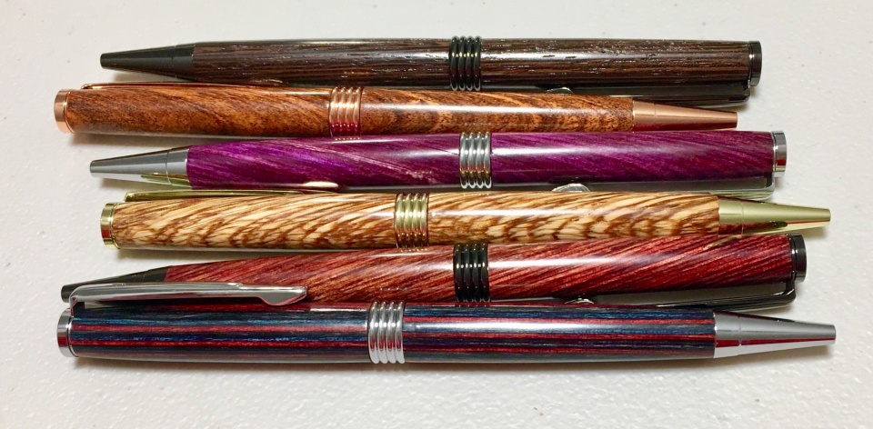

WTF is foolproof and for many CA is not. I use both. WTF is great for a very strong shiny finish without fumes. It retains the "wood" look and is still highly resistant to hands. People like it when they "know" it is wood by some surface depressions. Check out a paper towel the next day after using it to apply WTF; it will be rock hard like your pen's finish. I use 5-8 coats with sanding after coats 1,4 with 400 grit and 1,000 grit sanding before buffing with a Beale buff system. Inexpensive wood pens get WTF as I can apply the finish in the house while enjoying a program or the news. No fumes or almost no fumes. I finished the pens below as a group in about an hour.
The poor photo shows a few pens buffed today after a night to cure. They a VERY smooth to the touch and shiny. They are not CA glossy, but surpass any other of the several techniques I've tried and it stays shiny forever, not until tomorrow. Your mileage may vary.
For higher quality pens, CA rules. I am not perfect every time but I make some very nice pens using CA without white spots or sanding dust.
