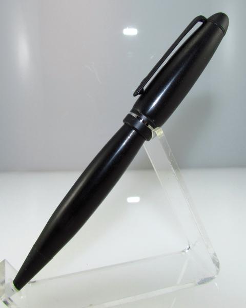

I make a pen using Gabon Ebony and finish to 12k grit, then DNA and finally two coats of BLO heated up on the lathe. Makes for a fantastic matte finish.
