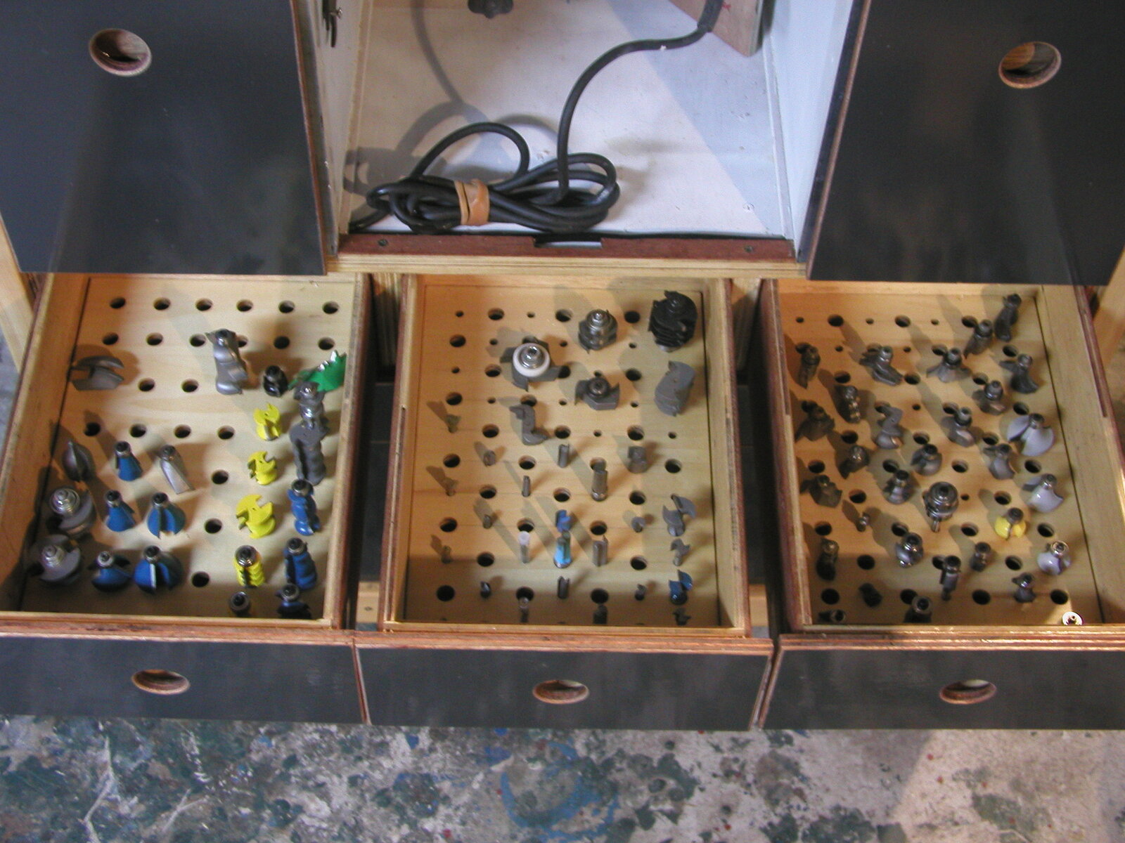

Or make you own. I made those three drawers back in 2002-2003 and had to make 3 more drawers in 2020. The bits below are what I had overseas, and I had that many back here too. I used a 1/2" forstner bit to make the holes for the 1/2 inch bits and then sanded each hole with dowel and sandpaper to let the 1/2" bits fit easily, and I used 1/4 in forstner bit and reamed it out with a 9/32 bit for the 1/4 inch router bits. Works great. Takes a little time to layout, but easy.

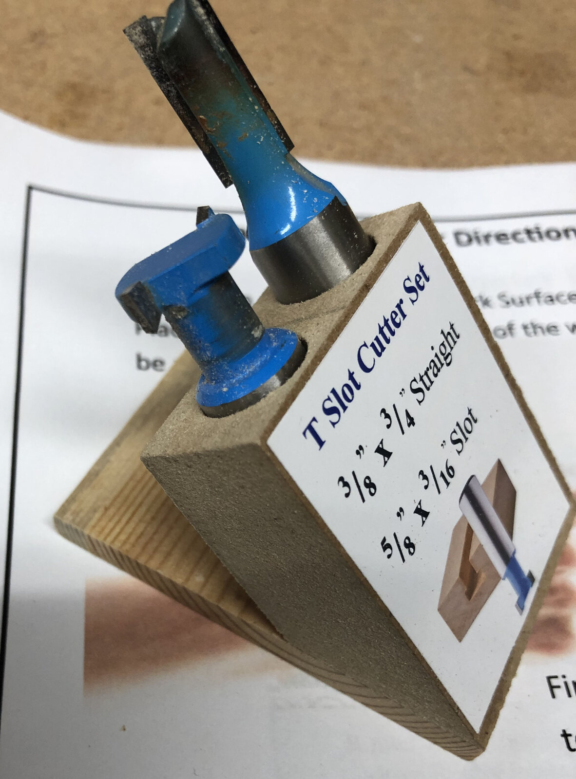

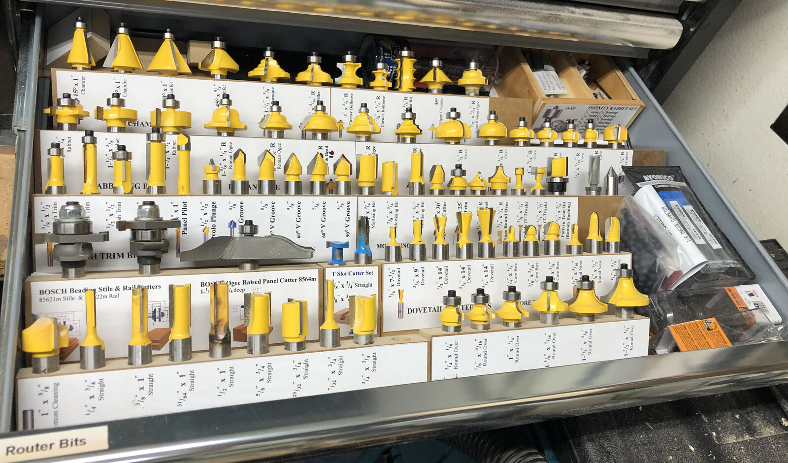

Cool. - Here is mine, sort of modular, made with some bits of MDF and 17/32 or 9/32 drill bits cut and glued on an angle so they would fit inside one of the drawers in my toolbox. - Dave
View attachment 335152 View attachment 335153
Wow, David, that is nice, and labeled too!
