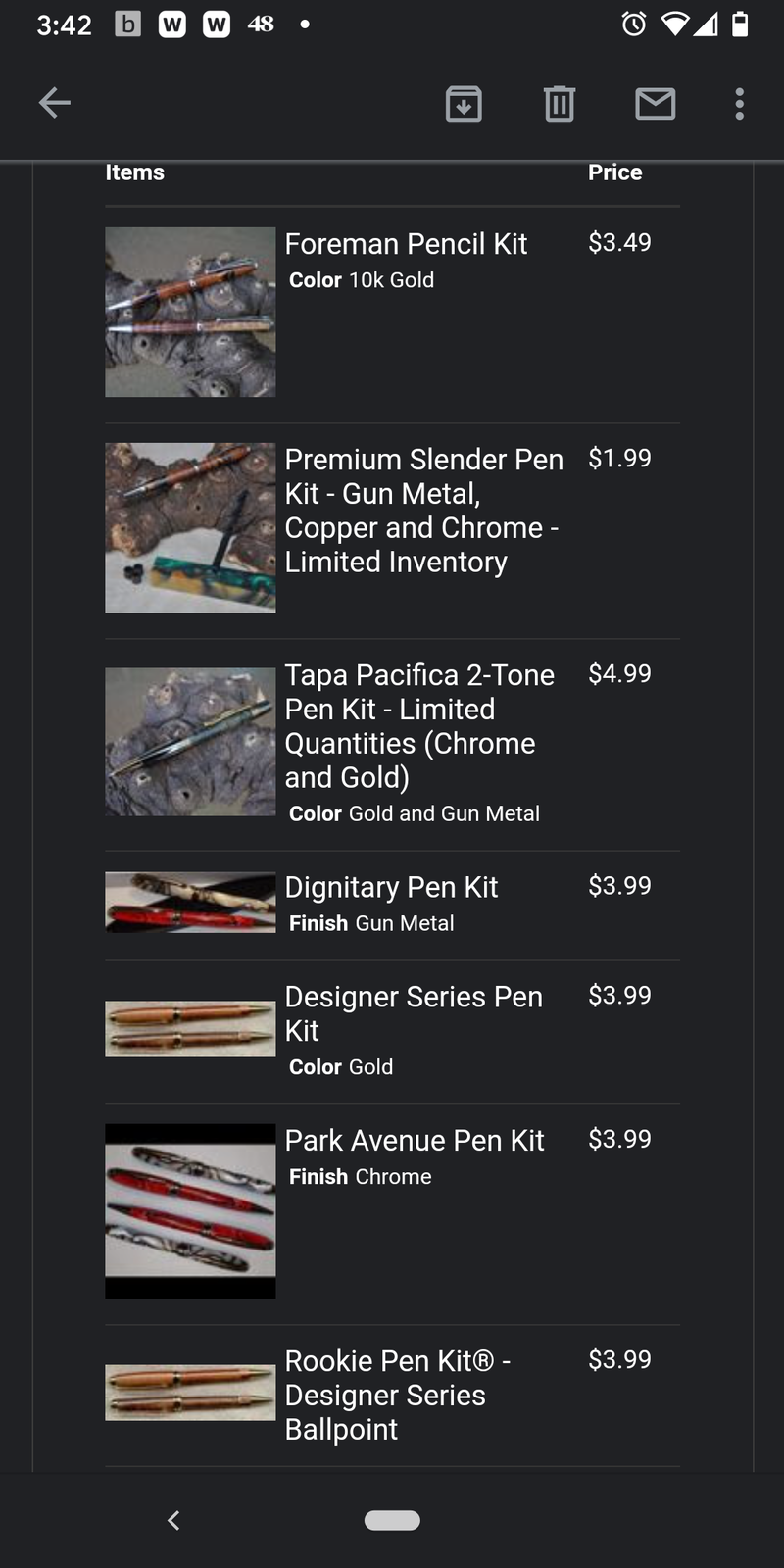

By chance does anybody have woodpenpro bushing sizes?
I looked at 27 complete supplier bushings list and didn't see it listed there .
Best regards,
Johnny

Do you happen to have the foreman pen kit and the premium slender pen kit. Thinking these might be comparable to slimline?
Also, parkavenue, rookie, dignitary and designer are similar bushings, the owner responded back I email confirming this.
Do you happen to have a bushing set of any of those?
And lastly tapa Pacifica bushing set?

My guess is the foreman/slender has a slightly larger center band than the slimline. The website notes that they are similar to the comfort kit without the soft grip. The pic on the website of the bushing shows that the center bushings looks a little bit wider.
