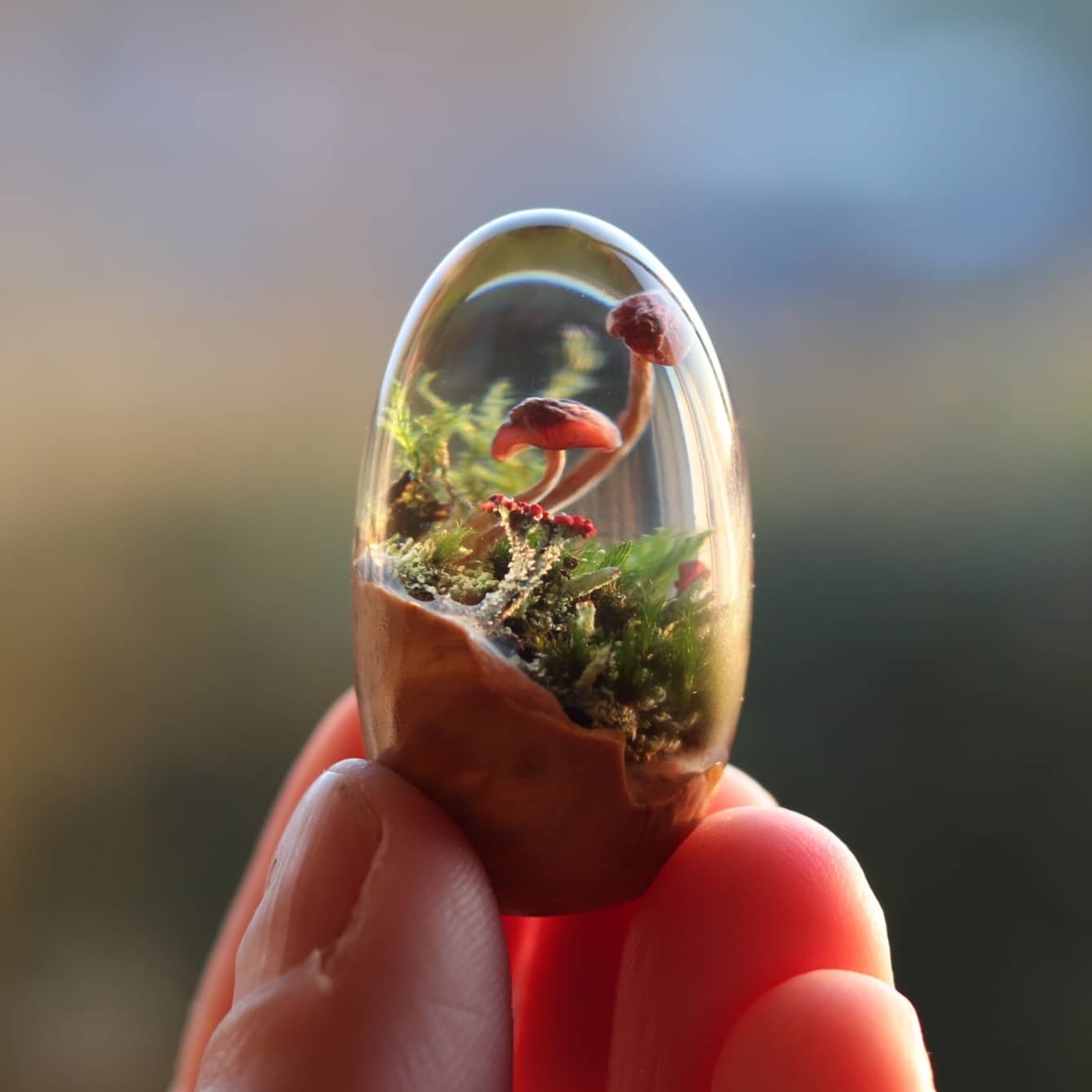

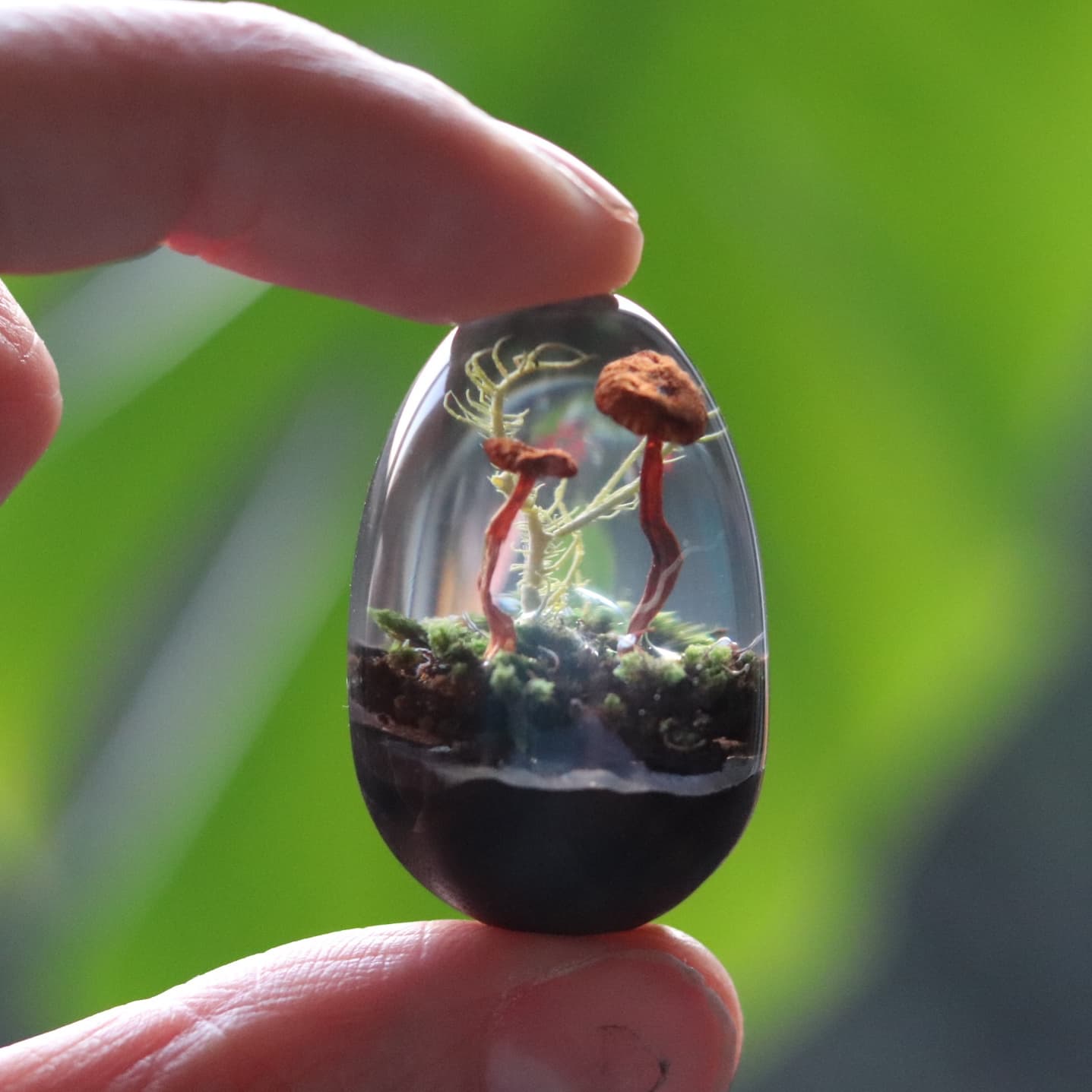

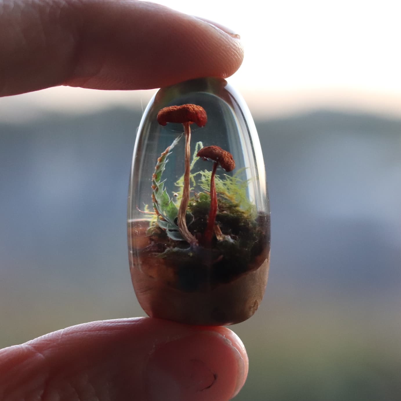

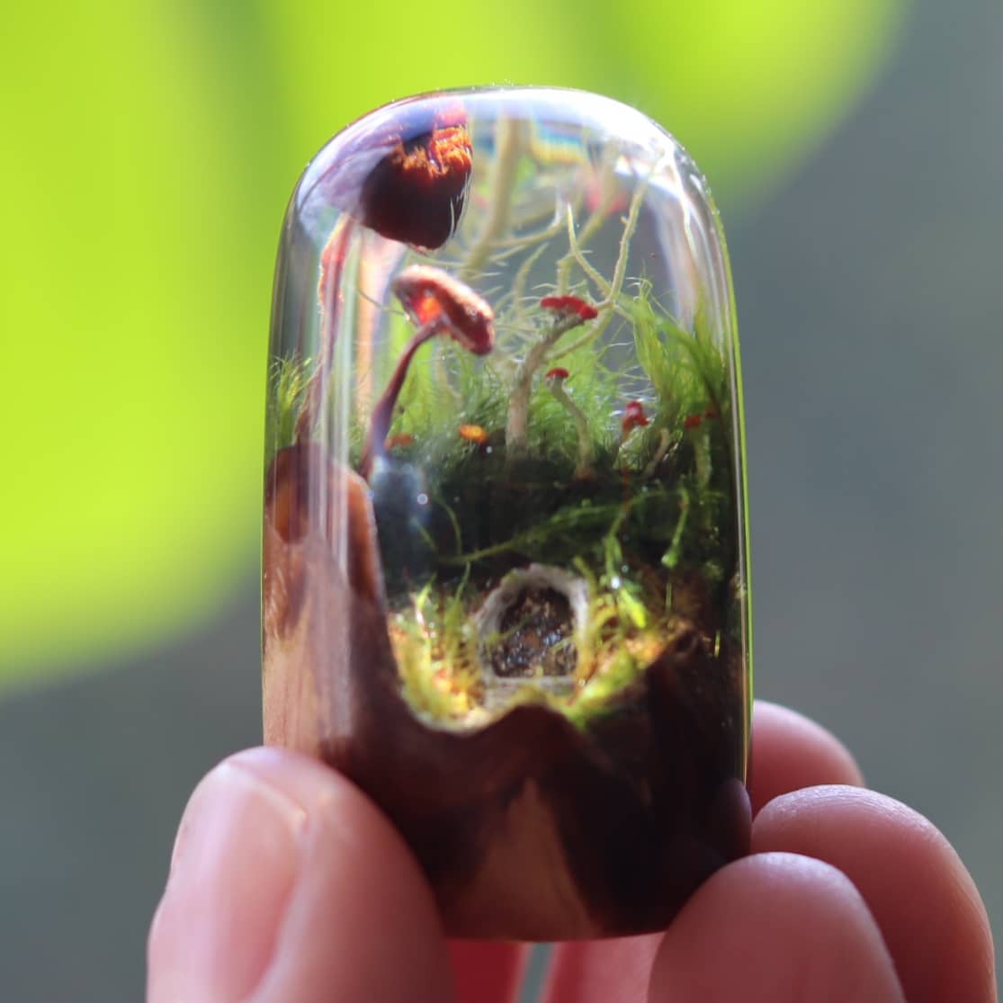

I've pretty much settled on this one, but wanted to check with you guys first... The price is better for me - I know it only has 0.75HP, but at least it has variable speed. It's $649AUD + $30 shipping, which seems very reasonable. The others suggested here I can only find at around $1200AUD, or sold out.
I wouldn't be upgrading for a few years at least. Can you spot any problems with it? I'll attach some pics of what I've been making without a lathe.

And, if you don't mind - after seeing my photos, what attachments would you suggest I buy to turn items this small? What's the most efficient way to do it?
I also want to make pens and tiny boxes/containers eventually as well.
Thanks so much for all your replies!
That seems like a pretty good choice - surprising amount of swing, and with the option to add a bed extension. The motor horsepower seems to be a bit on the light side for the large swing, but you can learn to deal with that. I like the fact that it is reversible.
