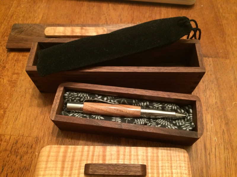

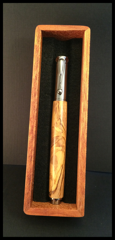

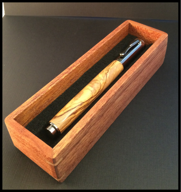

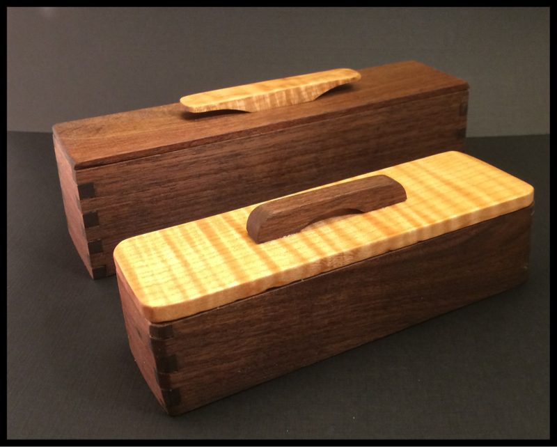

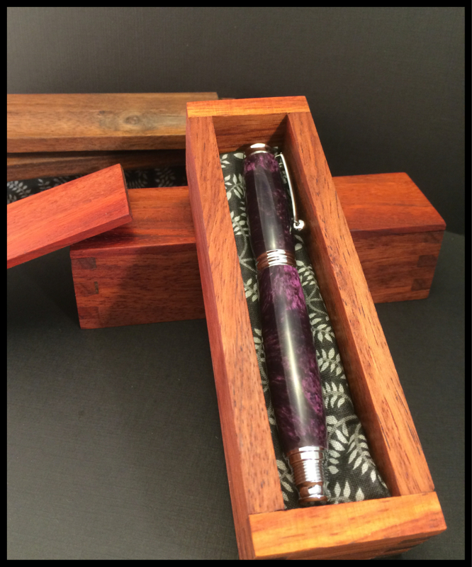

I tried my hand at making some wooden boxes.
I will evolve the process as time goes on and decide whether I want to make an insert. I actually like the idea of using different patterned fabric to hold the pen.
I'll probably also continue to mess around with different kinds of handles or no handle. Maybe try to vary them so they're unique.

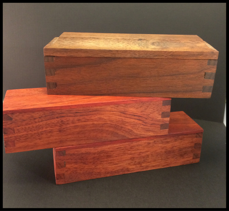

I did invest in a good router table setup late last year and just broke out my box joint jig for the first time for these.
Dan, as I mentioned in the PM, your wall thickness shown here is getting close to what I consider about right. It may be the perspective of the photo, but the taller box appears to be slightly thinner, and looks good. You can play around with different designs and different joinery, and get wide variation in box designs. Also, you can go much thinner in wall thickness (less than .25 inch), and it still looks good. With the right joints, there is plenty of strength in thin walls for boxes this size. Boxes (flat work type) can be a lot of fun.

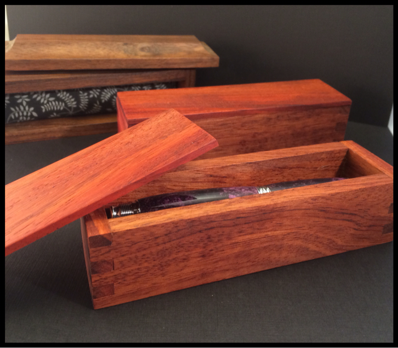

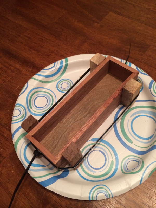

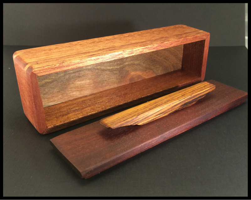

Dan, I am liking the wall thickness shown here on the the latest, your miter joint box. A miter joint is inherently weak, but can be easily strengthened by adding a couple of visible splines across the joint. You might have seen these in some small box designs. I have done them the thickness of the table saw blade. After the box is glued, you cut a slot on the TS, cutting across the joint, slightly less than all the way through the wood. I used a jig to hold the box positioned standing up on the corner so as to get a 45* cut when cut on the table saw. Then cut some contrasting spline stock just thick enough to get a snug-fit glue joint. With splines, you can play with the spacing, thickness and numbers to yield a variety of design accents to your boxes.
Yes, I'm doing the splines. The drawback Is that the thinner the walls go the smaller the spline unless you want it inside.
With this one I may use veneer slices like David from timberbits does instead of thicker ones.
Given that the box doesn't need to be exceptionally strong, I'm not that worried about it.

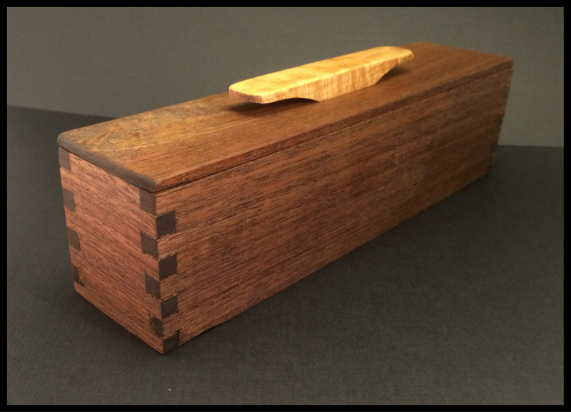

I personally like the box joints.. to me it appears to take much more skill and labor. I think regardless of what you make, they are all AWESOME. I used to make some jewelry boxes with very thin walls and the most difficult seemed to be getting uniform thickness, and reliable joints. Of course that was like 30 years ago and I hope I am more accomplished than I was then.
Regardless... I am impressed
I think the box joints are more unique too.
Maybe have some of each. I think the miters are going to be a little quicker to make but we'll see.

I figured you would likely be way ahead of my thinking and suggestion on the use of splines...and you are. Something else came to mind as I was thinking back on when I used to make boxes quite a bit (This was pre-penturning timeframe for me.) I also enhanced the splines by using a dovetail router bit to make the cut instead of the TS. This produced a nice bowtie or dovetail look to the spline effect, which really dressed up the box. It did take more work, and careful attention to making a nice fitting spline. Whatever you do, have fun! Don't forget to make pens too! :biggrin:You gotta fill up all those boxes!

Is this thickness a little better? This is the maple lidded one.
Yes, thinner is better. When the thickness approaches the pen diameter, the pen gets lost and the box takes over. I think the box sides should be no thicker than 1/4" max. Also, keep the box height fairer low. The box should showcase the pen. The box can be elegant and attractive, but should not steal the show.

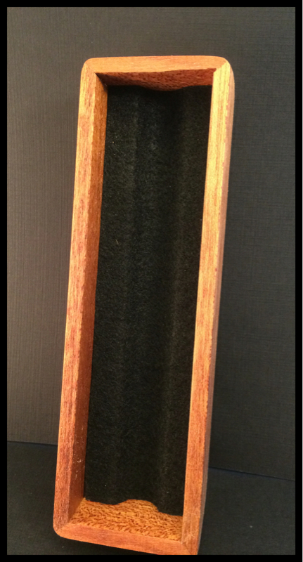

You might also consider a "clamshell" box. It's only two pieces, can be made with thicker wood and has a routed channel to hold the pen. Here's an example:
http://www.szymanskiwoodpens.com/images/single_pen_box_maple2.jpg
Benoît
Yes, thinner is better. When the thickness approaches the pen diameter, the pen gets lost and the box takes over. I think the box sides should be no thicker than 1/4" max. Also, keep the box height fairer low. The box should showcase the pen. The box can be elegant and attractive, but should not steal the show. You might also consider a "clamshell" box. It's only two pieces, can be made with thicker wood and has a routed channel to hold the pen. Here's an example: http://www.szymanskiwoodpens.com/images/single_pen_box_maple2.jpg Benoît
Not really my style. Psi sells those. Pen on wood bugs me for some reason. If I flocked it maybe.

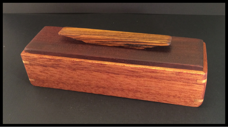

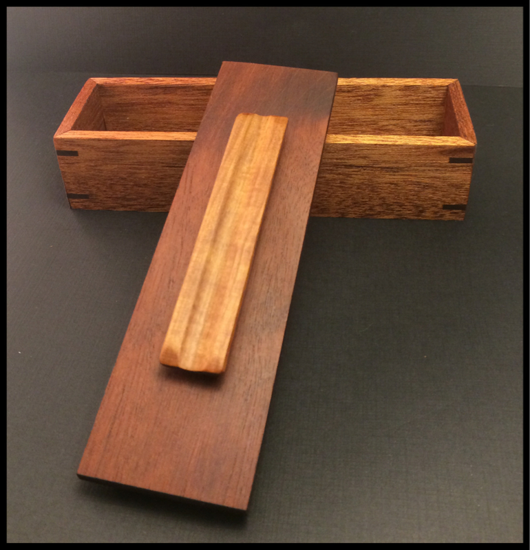

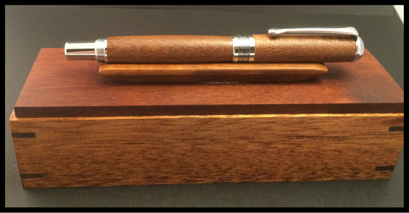

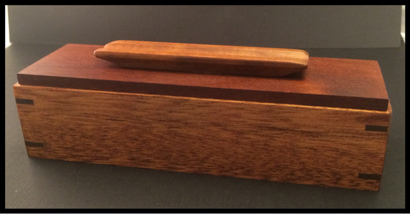

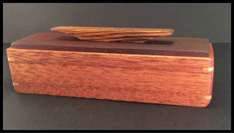

Mahogony with Zebrawood handle. Splined miters. No insert material yet.
