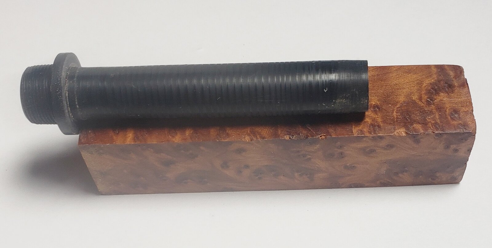

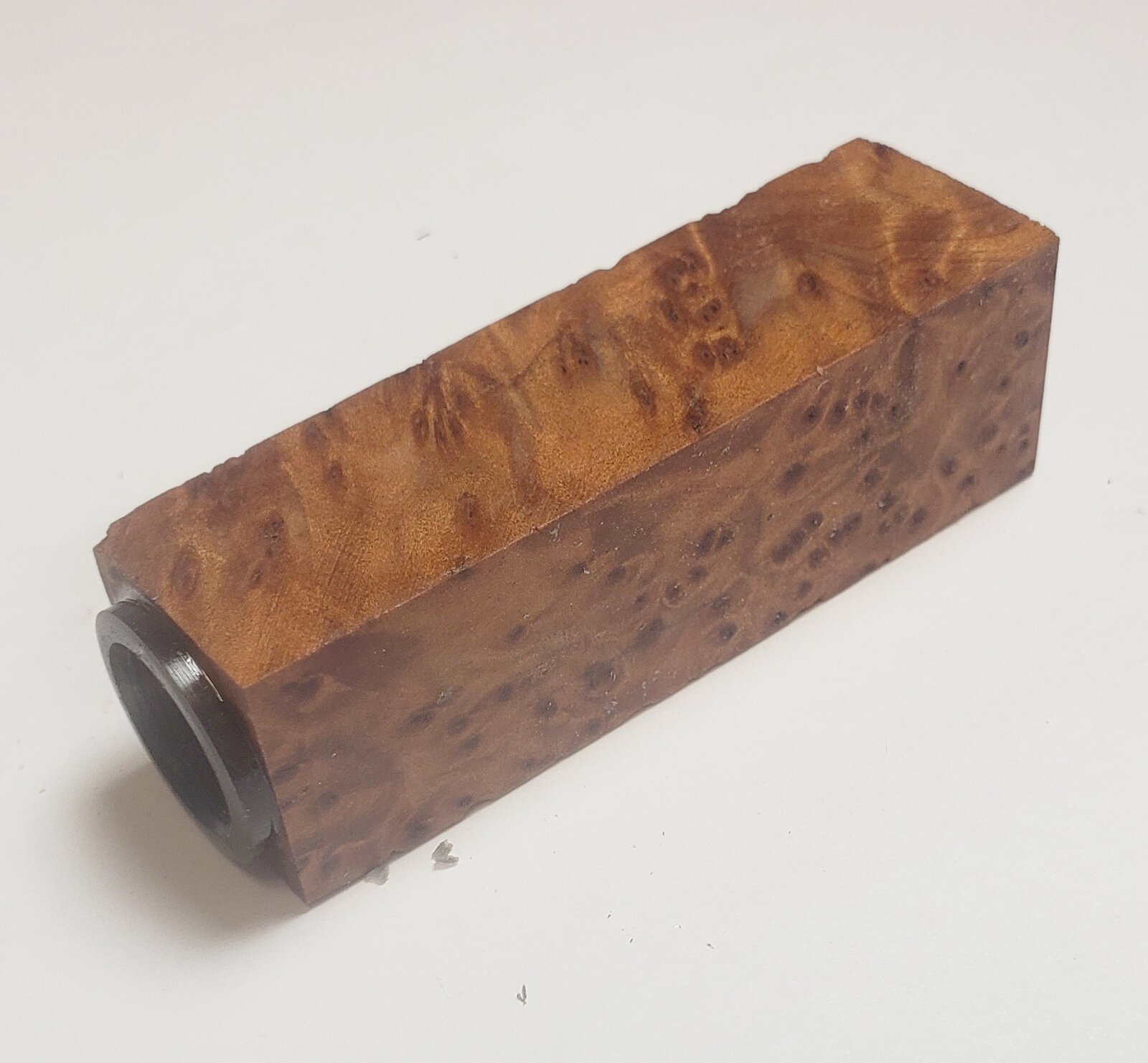

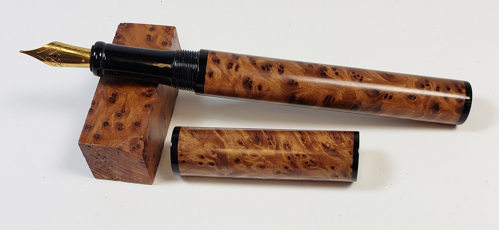

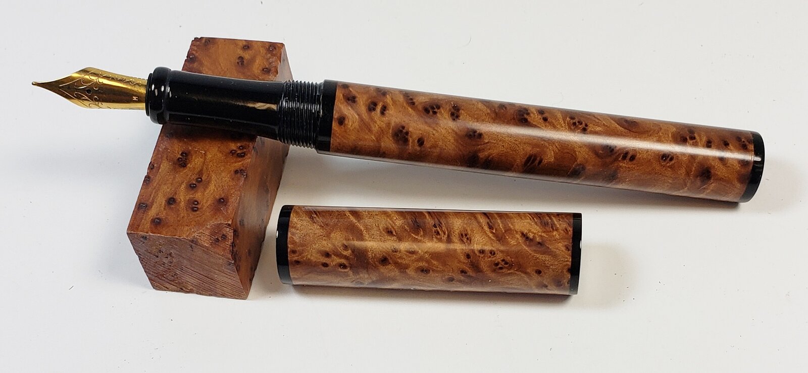

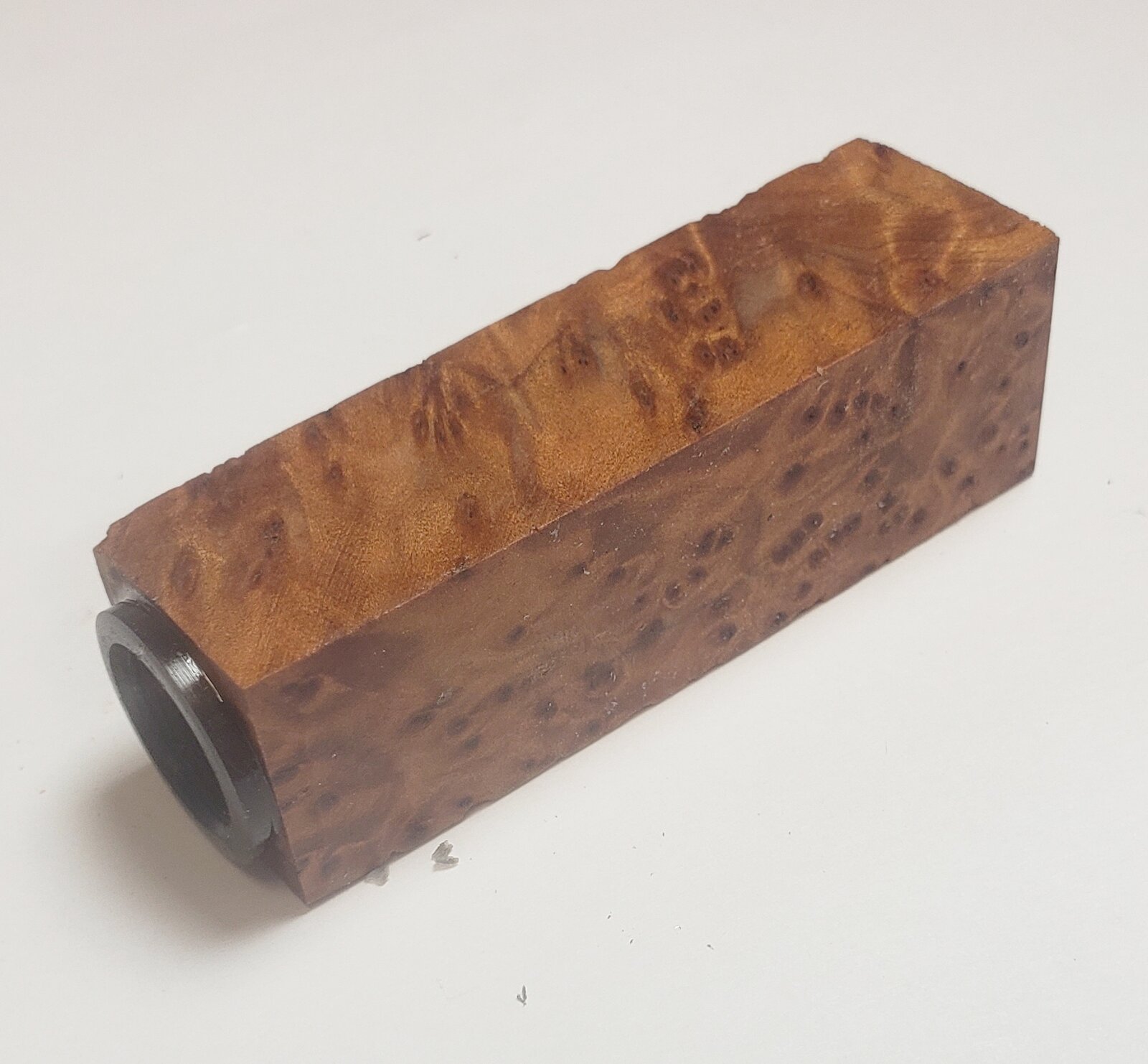

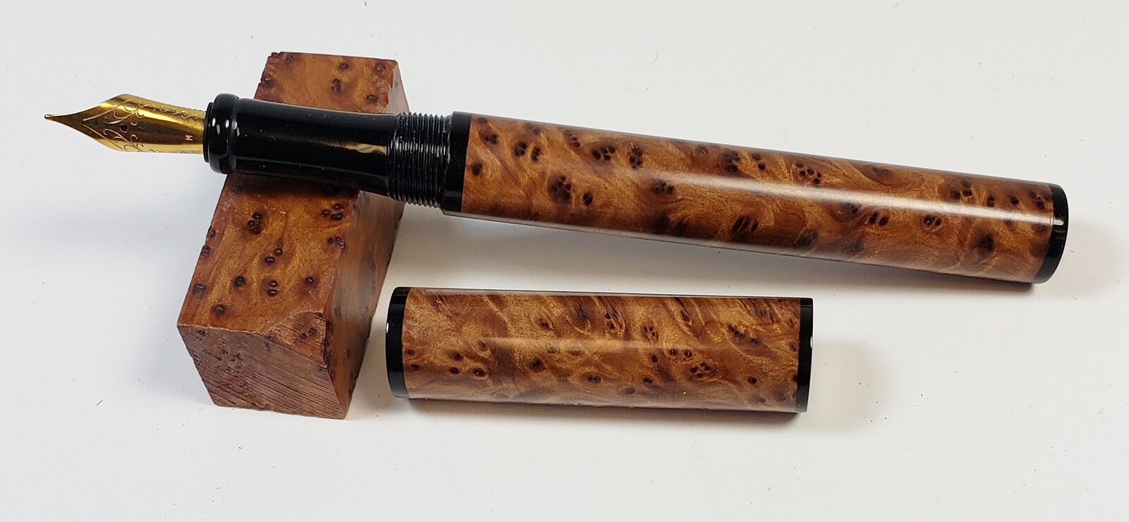

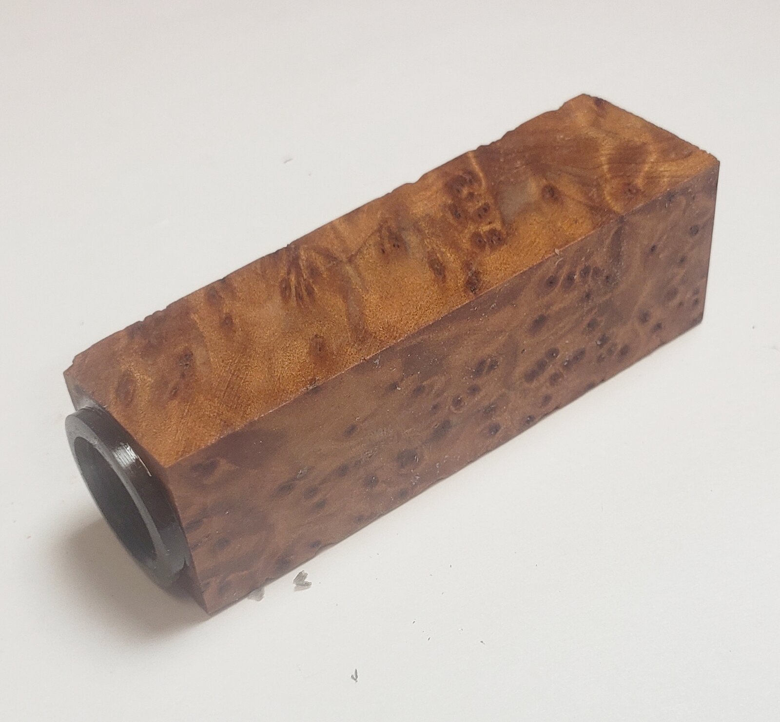

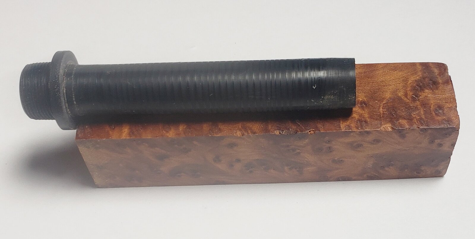

I have made several. I made a sleeve with acrylic acetate as mentioned above. The cap needs to be sleeved to prevent the in the feed from drying. 20220731_123236-01.jpeg20220715_154016-01.jpeg20220715_154854-01.jpeg

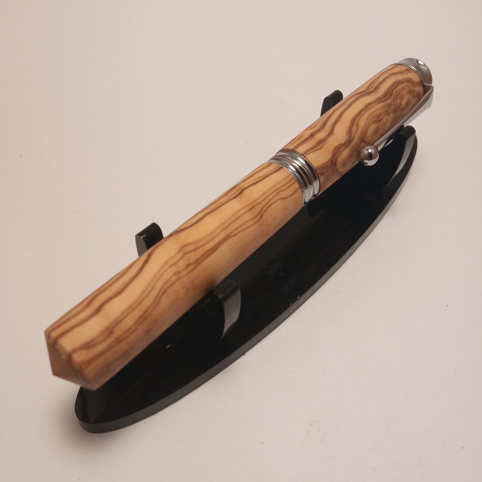

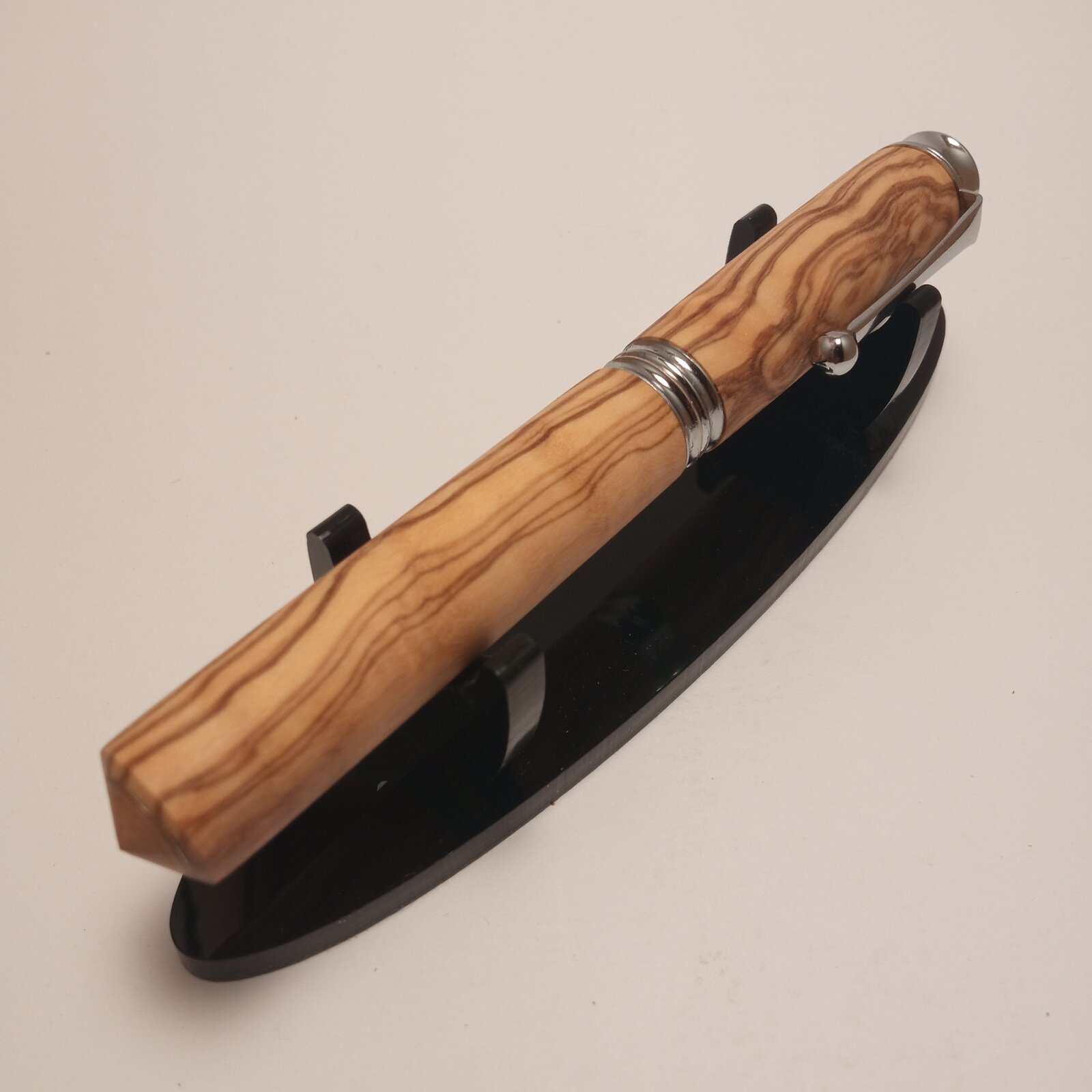

Here is what i made, with a kit however, that is indicative of my goal. Cheers

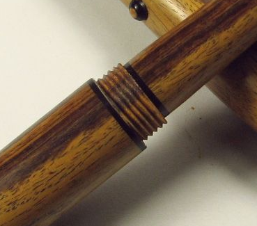

As for threading pens, the best results I got is using a 1 mm pitch (single or double thread) cut with a router running very fast (mine is set on 10 000 rpm); taps work honestly (a good thing for threading the section to receive the nib unit...), but not the dies - except in diameters larger than any pen. The male-female tolerance has to be comfortable to allow a certain change in geometry, so the barrel may wobble a bit in the cap when not completely screwed, this is why a good abutment is important to close them tightly.
As for species, very hard and fine-grained woods usually thread like a charm: boxwood, African blackwood, beefwood, lilac, dogwood are my first choice, threads look like been cut in metal. Most rosewoods, some fruit woods, and many other quite hard woods are not bad. Some hard woods are a bit brittle and thread a bit less perfectly, like snakewood, others have large pores (some rosewoods for instance) that do not help. But the threads are still good. The softer the wood, the crunchier the threads are, results are better if some thin CA is liberally poured before threading, but I do not have a total confidence in CA, so I cannot say anything on the long term.

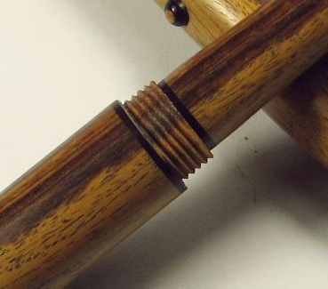

One of the best woods for threading in my opinion, lignum vitae:
