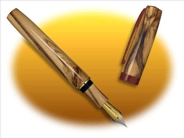

Examples:
Based on El Grande

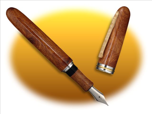

Based on Gentleman

Those are really elegant Rich. I see why you favor the El Grande. Guess we'll have to wait for the spring issue to see how the clips are attached, but it should be worth it. Great craftmanship, selection of materials and overall shape. Both nice but I favor the top. Thanks for sharing.
