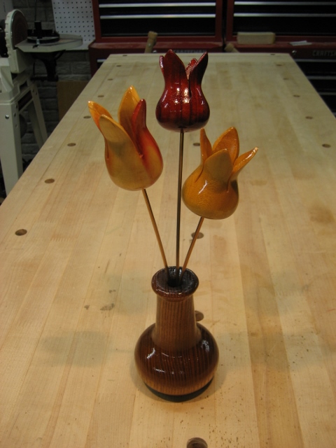

Just finished a new project ... lathe-turned and hand-cut wooden flowers. The flowers are mounted on 1/8 inch dia brass rods and set in a Catalpa vase. The finished project is shown in Photo 1. The wooden flowers are three wood species (L to R): Flaming Box Elder, Padauk, and Yellowheart. They are finished with three coats of True Oil.

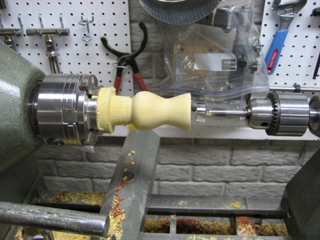

The process starts with a 2x2x4.5 inch turning block mounted between centers to turn a tenon for chuck mounting.

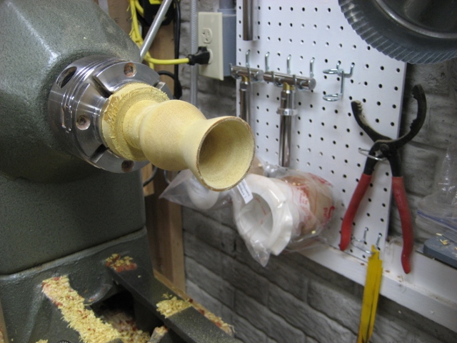

Photo 2: With the tenon mounted in a 4-jaw chuck, the outside flower shape is turned and then a center hole is drilled leaving about 3/8 inch material at the bottom of the flower. The flowers are now 2-3/4 inches long x 1-3/4 inches dia at their base.

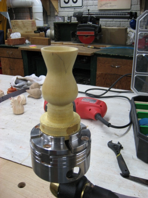

Photo 3: The inside is hollowed out using hand-held hollowing cutters to maintain a wall thickness of 1/16 inch to 3/32 inch to match the outside profile of the wooden flowers.

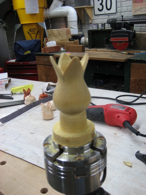

Photo 4: The chuck is remounted on my workbench and the petal outline is penciled in.
Photo 5: The petals are cut to shape using a small flexible handsaw then used 150 grit strips of sandpaper to smooth the petal profiles.
