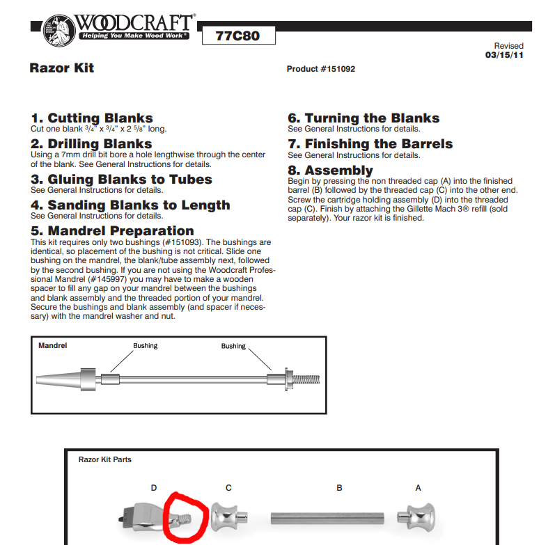

Hi All,
I'm thinking about turning a custom razor with a solid brass "bolster". Would anyone know what is the tread of the fusion attachment here? circled in red, see picture.

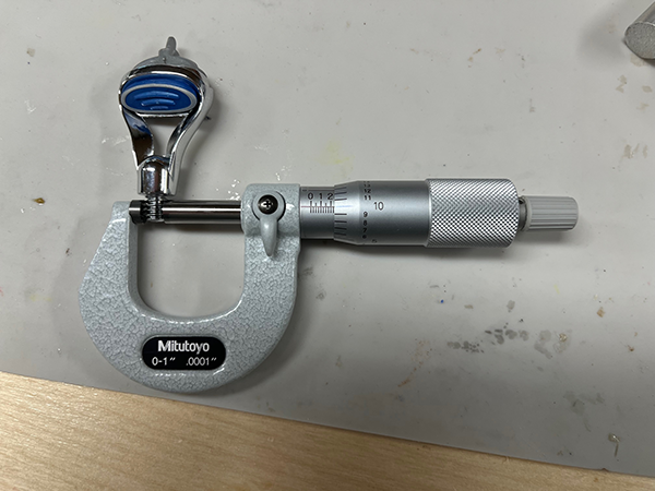

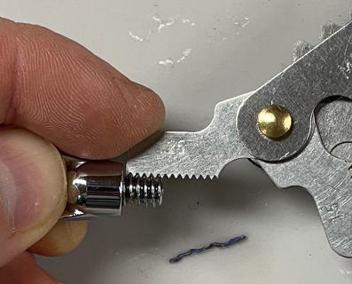

I took a look at one of my kits, and I am measuring a major thread measurement of .235 (5.96mm) and a 1.25 pitch with a thread gauge. I am thinking M6 x 1.25, but wait to see if anyone else knows for sure or chimes in to correct me. I am just learning how to measure threads.
