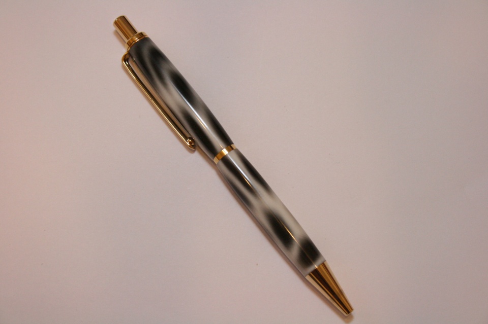

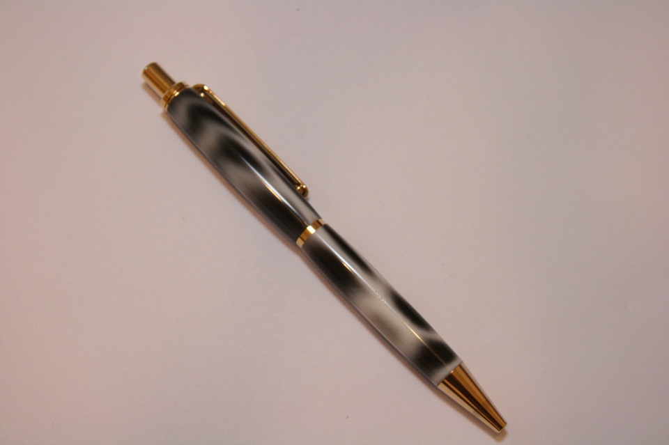

I wanted to turn a pen this morning as I'm not sure what will happen after I see the foot specialist this afternoon. I want to that who ever it was that sent me the Snow Leopard blank it was a joy to turn and finish. I paired it up with a gold Woodcraft click. I wet sanded to 6000 mm and polished with Hut plastic polish. I tried to match up the pattern in the blank as best I could and I think it very close. Any and all C&C welcome.
In the instruction for this and other click pen it say to use a wood block with a hold drilled in t to protect the click button, I found that it easier to use the top bushing it the right side and you don't need a wood block for different size kits.

I saw this kit at my local Woodcraft recently but wasn't really looking for click kits, but I may have to go revisit after seeing your pen. Nice work on the fit and finish and that is a very nice blank. Did you encounter any issues while turning for this? It looks like it would be very similar to a standard slimline.
Michael
Michael; Thanks for the good wishes and nice comments. This kit tubes are about MM it uses a letter O drill bit. I chance one step in the assembly. I thread part D (threaded sleeve) on to part C (center connector) line up the grain and press that assembly in to the upper tube.

That blank is beautiful...... Where did it come from?
And it looks like your fit and finish are right on.
Great looking pen and something that it special there.

Pen looks good. very nice fit and finish.
