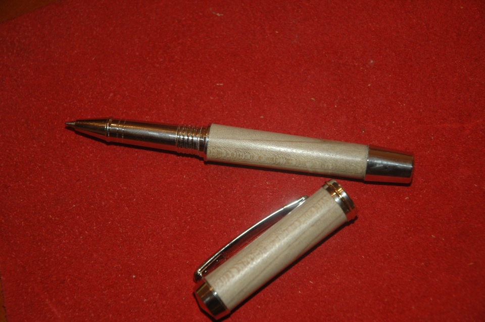

Fair enough. It's a Jr Gents II [rhodium]. The cap is pointing at the problem area. The finial is 0.49" diameter and the barrel is 0.46" diameter. The difference of 0.030" [a 0.015 step] is noticeable to the touch.
I was hoping to salvage the barrel and cap that were turned mistakenly using the Kojent bushings by finding another RB kit [non posting] that called for the Kojent bushings. Failing this, I will have to use a postable Kojent kit.

If you turned the barrel at that point to 0.460, you have definitely overturned it for that series of RB/FP.
Check the part number on your bushings - I suspect that you used Kojent Ballpoint bushings (152728) instead of Kojent Rollerball bushings (151264). If the part number on your bushing bag is correct, then Woodcraft may have labeled it incorrectly at their factory.
The key thing to check is the two bushings for that lower barrel. They are the same size for the ballpoint kit (about 0.480) but different sizes for the rollerball (about 0.510 and 0.480).
I don't think that there is any rollerball that will match the dimensions you wound up with. You may have to get a Kojent ballpoint if you want a better fit for that barrel.

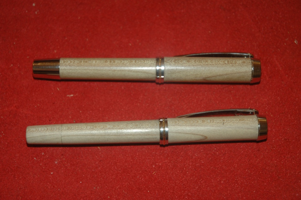

Okay, here's the attempted salvage of the magnolia pen. The grain was impossible to match exactly because of the 3/16" left on the original blank. But it is an obvious "blind cap", and no more obvious than on Sheaffer Touchdowns and Parker Vacumatics, but it doesn't come off.
I turned a 3/16" tenon and drilled a 1/4" hole 3/4" deep in the tenon and blind cap. Then I flipped it end for end and shaped the blind cap. I enlarged the drilled hole slightly to accept the refill, and then glued the blind cap to the barrel.
Have I successfully saved the pen? Opinions appreciated.

Matter of taste, but mine say looks good. If the magnolia has a story with it, it could be a selling feature.
It does have a story: My wife remembers the tree from 50 years ago in her hometown of Pazin, Croatia [on the Istrian peninsula, about 18 kilometers from Mario Andretti's home in Motovun]. It was cut down because it was damaging the hospital foundation. Our friend got the bole and had it cut into planks about three years ago. I got a small piec, enough for four pens. I kept one, one went to my son, and these two will go to my daughter and son-in-law.
Thanks for your opinion, Ken.
