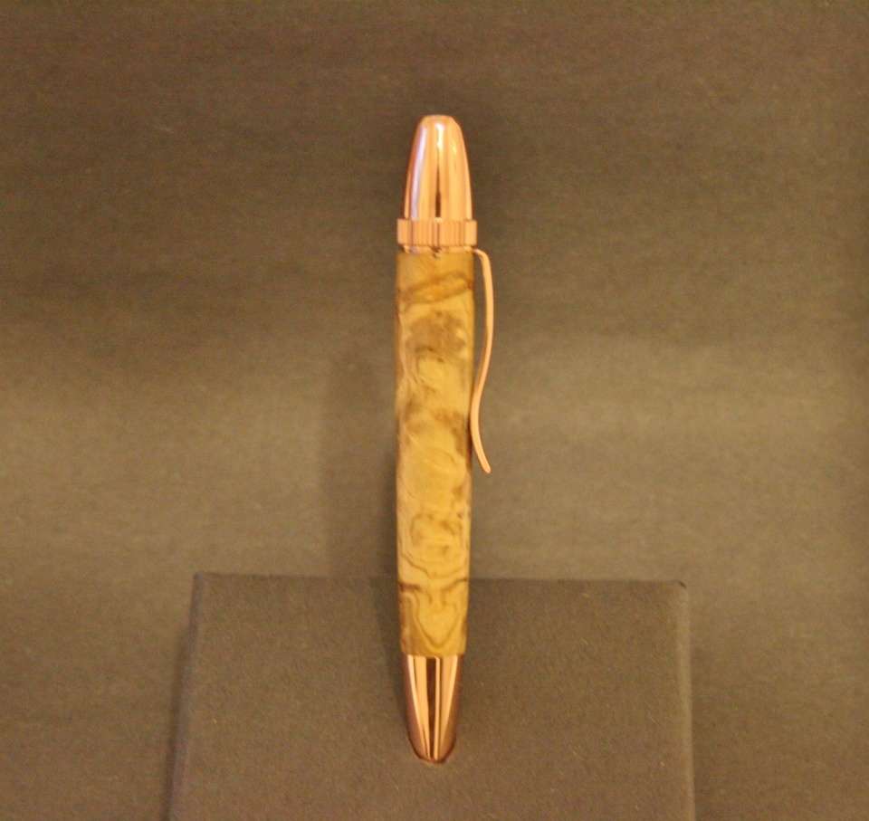

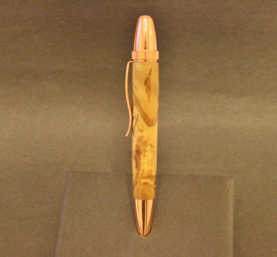

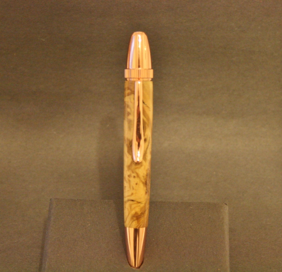

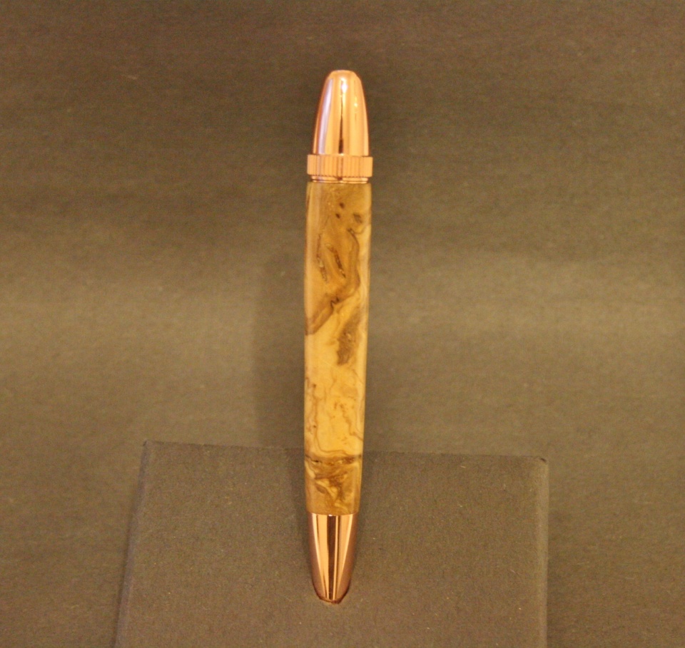

Yet another first. The blank for this pen is Old Olive Root it like burl. I've never heard of it before yesterday. George aka robutacion sent me with my order of banksia pod. Thanks George. I had to fill a few voids (CA and shavings) as I turned but it did turn, sand and finish well. The kit is a Woodcraft Copper Atlas I think the copper is a nice pairing with the blank. Any and all comments are welcome.

Great stuff Dan...!
Those "bits" of Olive wood are as rare as money in my pocket and from the nature of things, where the Olive tree develops these treasures inside of it, are very deep within the wood and often where most of the "movement" will occur when cut out and put to dry.
On the other hand, those "faults" allow for one's imagination to put into practice some of the best features one can add to a beautiful piece of wood like that, there are too many options to consider but, I found that one of the best filling materials to used in these cases, is the crashed precious stones, with turquoise on the top of my list.
There are many places now where these crashed stones can be found for sale, they have various crashing grades, from chunky to fine powder and everything in between however, you find 2 types, the natural rock and the man made stuff, both identical but the natural rock will destroy your HSS tools if the chunks are big so carbide tools are a must.
For effect, the bigger the chunks the better and when possible, use a combination of sizes if the filling whole/crack will allow, the finest the the material the less impressive will be, with not a lot more than just a solid colour showing, while the coarser stuff leaves a great stone effect ...!
Anyway mate, I like what you did whit that blank, thanks for showing and mentioning, from where you got it from...!
Cheers
George

Very nice Dan! Glad to see someone is capable of not destroying the beautiful blanks George sends out..:rolleyes: I really love the looks of his olivewood!
Thanks George for the great idea on filling the voids, I was thinking of using something other then shaving but it was all I had handy and I wanted to finish the pen and thanks for the nice comments. And thanks again for send the blank it great stuff and it help add to my skill level.
Thanks Marko50 and Ambidex for your comments. This blank was one of the more challenging ones I've done. If you do turn one of these take your time and use a light touch as I found a void will up out of no were, I also ran my lathe at about 2200 rpms.
