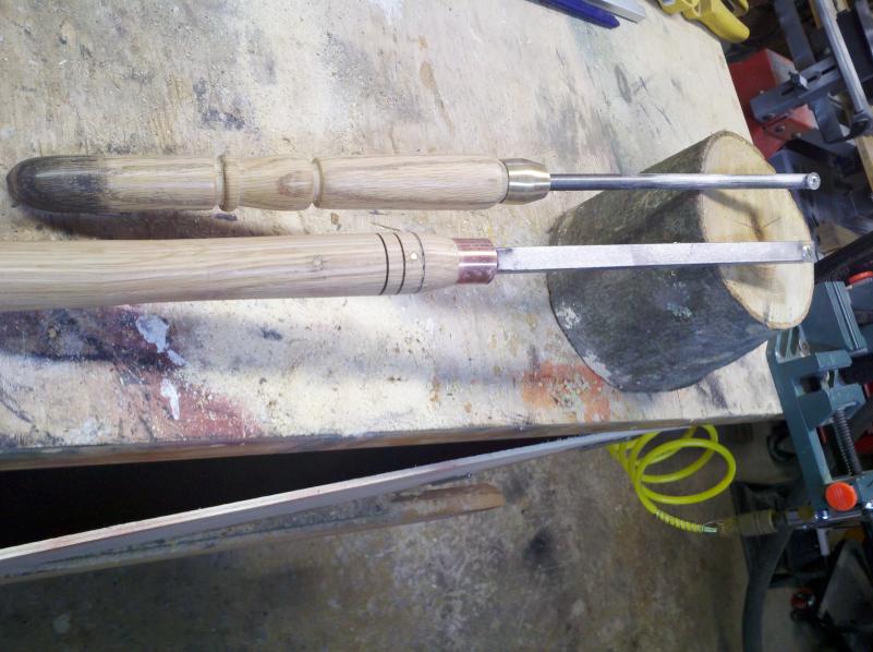

iclight0
Nov 1, 2011
11
waynesburg pa
my tools
Here are the ones I bought from capt. Eddie and the handles I made.
