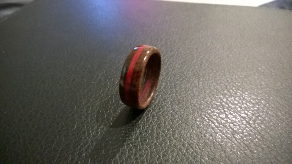

I was asked by our local Jeweler if I could make a wood wedding band for one of his customers, so I gave it a try. Attached is a photo of my prototype. The Jeweler is also wearing one of these now.

That's really cool, Chris !! What type of wood ? .... and other material .... looks to be laminated.
I'd love to see pictures of the process. I was just asked to make a wedding band out of lilac wood.... Especially Like to see how you put the blo/CA on.
I merely followed Capt. Eddie Castelin's U-Tube Video on "Making WoodRings" and finished with CA/BLO in the same way as I do with Pens (spinning on a drop of CA + drop of BLO together, on a piece of paper towel); I think there is a tutorial on this method on this site.
