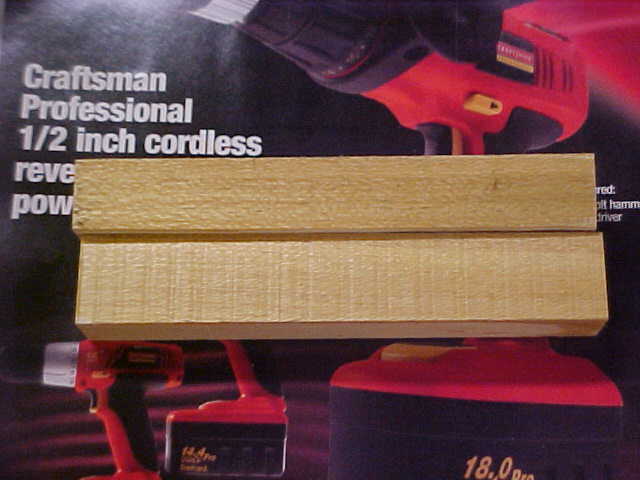

It also grows all over the Yuma Az area. I have made several pens from this wood. Here are a couple of pictures. It was wiped with thin ca.
<br />
