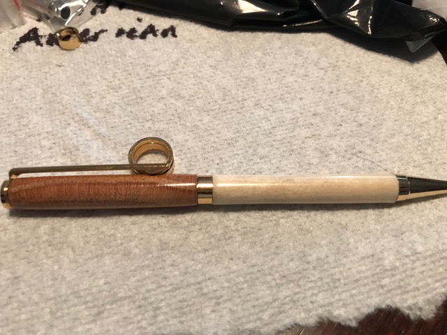

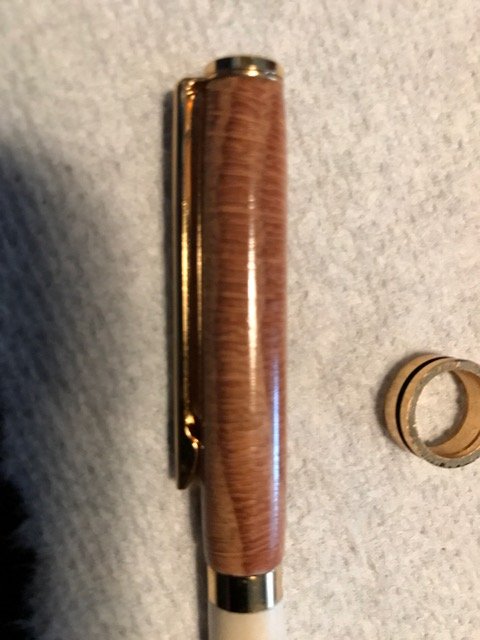

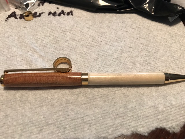

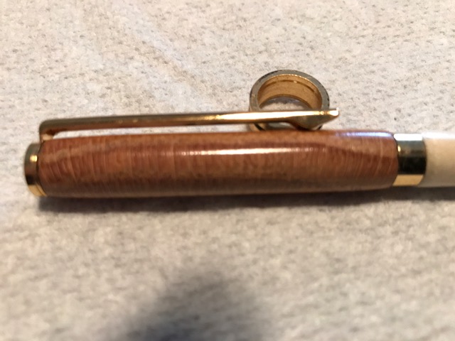

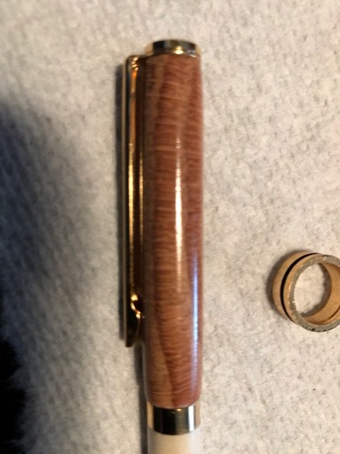

Oh by the way anyone cross cut a blank of 1/2 oak WOW its hard to turn but if you go slow the results are freaking awesome from the straight grain blanks.

Yes, people do crosscut quite often .... but usually it's quite a bit easier turning one that's been stabilized! Try soaking your crosscut oak blanks in thin CA and see if that helps your process (let it cure overnight or longer).
