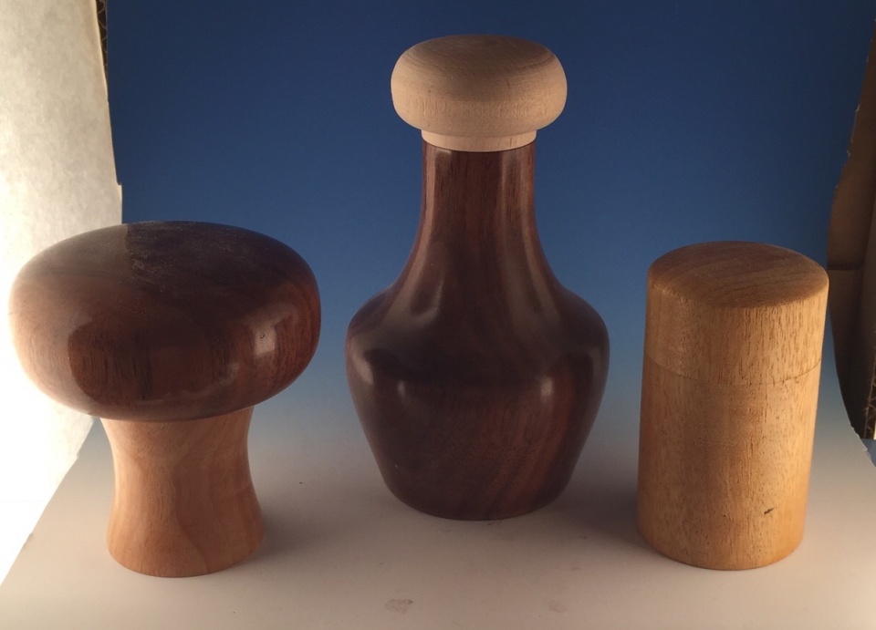

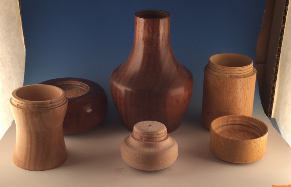

A few pieces other than pens made with my threader awhile ago
