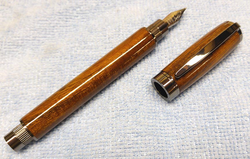

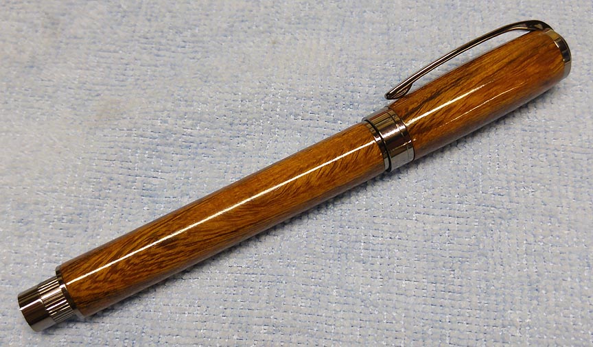

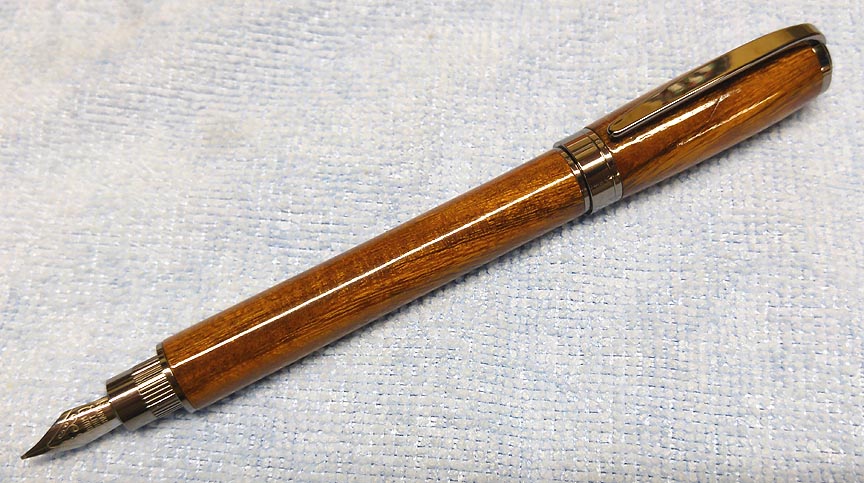

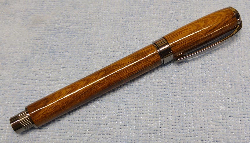

When I started turning pens in 1999, I used the Hut bars on wood. Didn't like it. Went to friction finishes, with better results, including homemade. For the last few years, though, I've been using Krylon triple thick glaze with good results. Usually only takes one coat. Keep in mind, though, that I don't sell my pens. I make them for myself, and friends and family. I don't know how well it holds up with a lot of use. I've never had any complaints, and my personal pens have held up well. But they don't see a lot of use, since I have so many, and switch off almost daily. The photos are of one of my latest, a Magnetic Graduate from PSI, with desert ironwood.
Triple-Thick Crystal Clear Glaze - | Krylon
