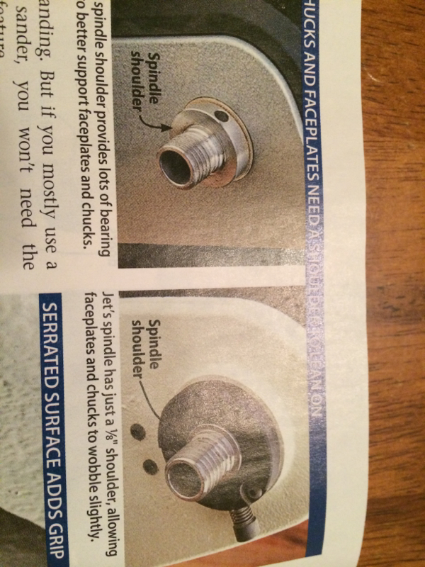

I am reading the recent Wood Magazine that came in the mail (issue 230) and there is a review of 12" midi lathes.
The reviewer claims that he experienced significant vibration with the 1221 when using a chuck or faceplate. He believes that the cause is a narrow shoulder on the spindle threads comparative to others. He was apparently told by jet that they will widen it in the future.
He claims that moving the chuck to another lathe solved the vibration.
I was surprised to read this as I've found my lathe very smooth.
Has anybody else found this? I'm wondering whether his test lathe had an issue.

I was surprised also when I read that. I have had the opportunity to work on 5 different Jet 1221s and I have never experienced that problem. I found that article very interesting.

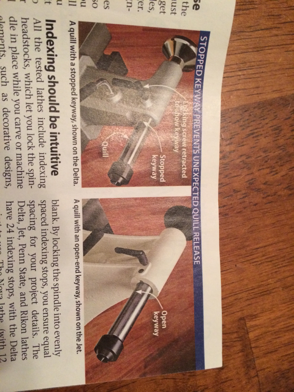

One interesting small 'knock' on the Jet was well was that it doesn't have a stopped key way on the quill to prevent it from being overextended and possibly coming out while drilling.
This seems to be a valid point.
Otherwise they gave the jet high marks for all the other categories. They gave the top pick to Delta and Rikon which Het being edges out only because of those two factors.

It sounds to me that the chuck on the 1221 had a cheap adapter insert. I've had one like this and have read that several others have had the same issue and had to replace them with Technatool insert. I've had my 1221VS for over a year now and haven't had an issue with vibration at any speed unless I put an unbalanced chunk of wood on it! ;>)
The author claims moving the chuck to another lathe eliminated the vibration.

Jet 1221VS vibration
Absolutely, yes. The vibration comes in at 800RPM and dissipates away around 850RPM. This happened with it new when I got it in December 2013. Spring of 2014 I called Jet and their tech support sent a local tech out to replace the headstock bearings, upper and lower pulleys, and the spindle. No joy.
They then authorized a replacement and it, too, exhibits the same vibration issue at the same RPM range.
The tech who did the work is well known and recognized in my area. His opinion was that the electronic control unit was pulsing the motor which becomes noticeable as vibration. I avoid the RPM range when using the 1221VS. Other than that I'm good for now with its capabilities given the price paid.

Absolutely, yes. The vibration comes in at 800RPM and dissipates away around 850RPM. This happened with it new when I got it in December 2013. Spring of 2014 I called Jet and their tech support sent a local tech out to replace the headstock bearings, upper and lower pulleys, and the spindle. No joy. They then authorized a replacement and it, too, exhibits the same vibration issue at the same RPM range. The tech who did the work is well known and recognized in my area. His opinion was that the electronic control unit was pulsing the motor which becomes noticeable as vibration. I avoid the RPM range when using the 1221VS. Other than that I'm good for now with its capabilities given the price paid. My hope is that when I move up to a metal lathe, the one I choose turns out to be well designed, well engineered, well built, of high quality, and exacting, accurate, and problem-free in its operation. Of course, I will ask for opinions of IAP member first. All comments welcome. Hugh
interesting. Only in that 50 rpm range? For pens too or only with chuck?
I'm wondering if your prob is the sane as the reviewer or a little different.
Dan, the vibration is present with and without Nova G3 or Beall collet chucks installed.
