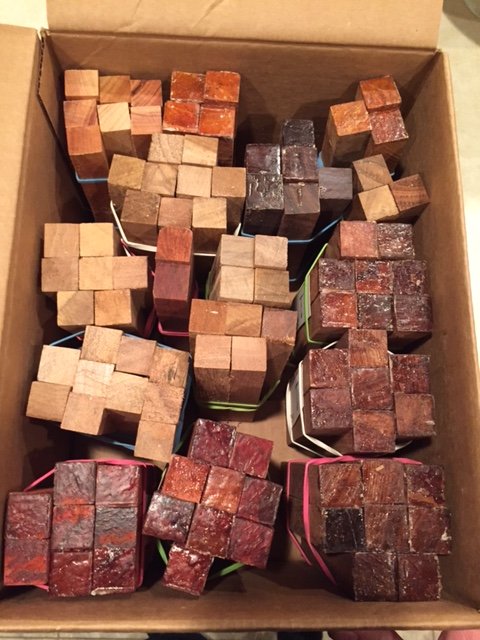

Tried to categorize as best I could last night and at .40c per blank I didn't think it was too bad for a beginning turner. Not sure I would pay full price of $100 but $39 seemed reasonable to me.

Looking at that box full, you may have gotten the better end of the deal...
lower left middle and middle ... looks like you might have some olivewood in there. Probably spanish, but there might be some bethlehem mixed in.
Bottom right and center right ... looks like that might be 2 packs of cocobolo.
Anything packed with wax (all that darker colored stuff) is probably an exotic hardwood from another country, so you've got yourself about a 50/50 mix.
Bottom center looks like poplar, and I see a few other sticks of what may be poplar or maple, possibly beech wood or even camphor.
Dead center there's one dark stick that wasn't wax coated ... looks like purpleheart.
Top left quadrand, lower right towards the middle, there"s a bunch of really dark wood .... possibly gabboon ebony, massacar ebony, or african blackwood.
Top middle to top right, 3 packs of similar wood .... they look like rosewood to me. May be burmese rosewood, yucutan rosewood, or another type.
You'll have to clean the wax off of a few of each and get us some more pics so we can make more definitive identifications .... side view, top view (grain patterns from adjacent sides) and end views.
