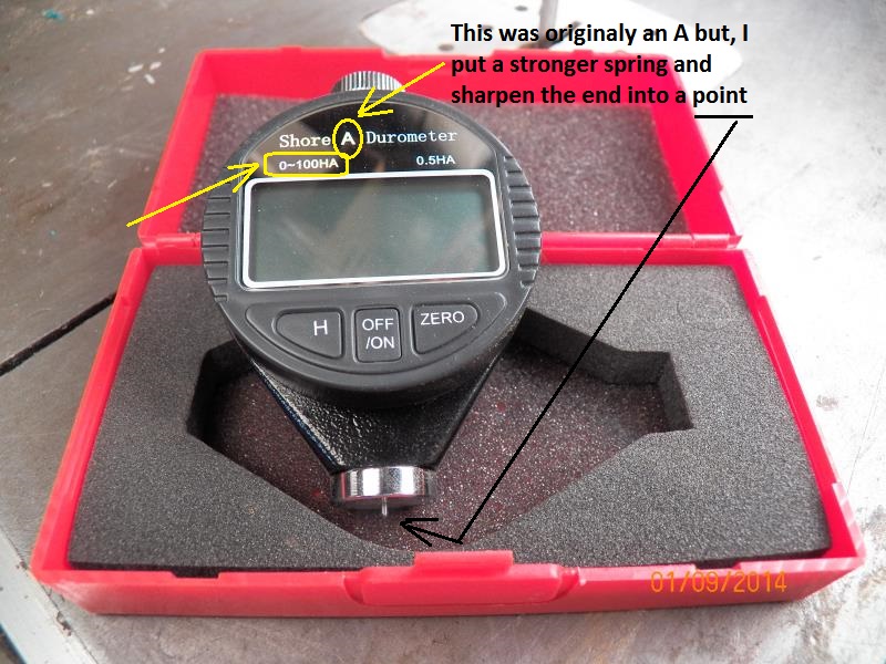

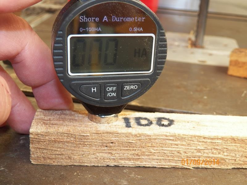

With this in mind, I come across an instrument on eBay that got my attention, first for what it was made to do and secondly, the very affordable price of under $50.00 shipped, such as this one (this was not from where I order mine but is the same thing and has more details about the items than the sire I got it from, a little cheaper too...!)

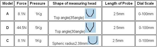

There are 3 types, A, C and D, I didn't realise that until I got mine and searched a little more, as I didn't like the tip and the softness of the spring. I then found out that, I should have got the "D" type, as shown below.

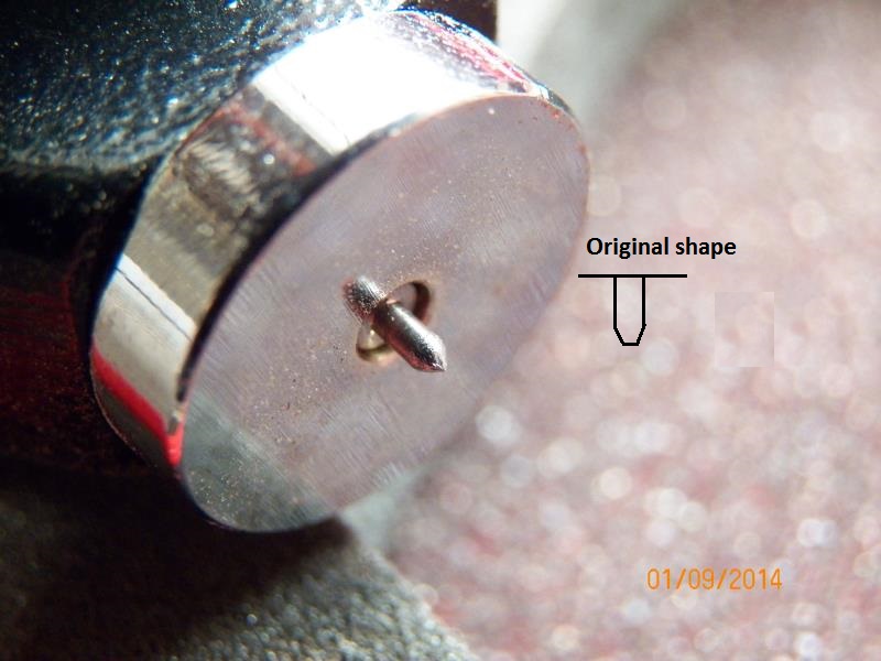

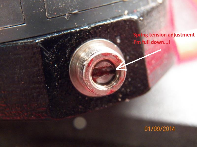

I decided to pull it appart and make a few modifications, one was to sharpen the probe end into a point and second was to, replace the spring with a much stronger one.
I have never used these gauges before but, I'm certain that I made it very similar to the "D" type and therefore a lot more suitable for the intended purpose...!
The final adjustment was made on the screw at the top of the instrument and under the top "T" knob, screwing it in or out, I manage to get the low readings on the soft wood as I wanted and at the same time, have better readings on the harder woods. I doubt that the "official calibration" of the instrument is off however, I don't know that for sure and it doesn't really matter to me...!

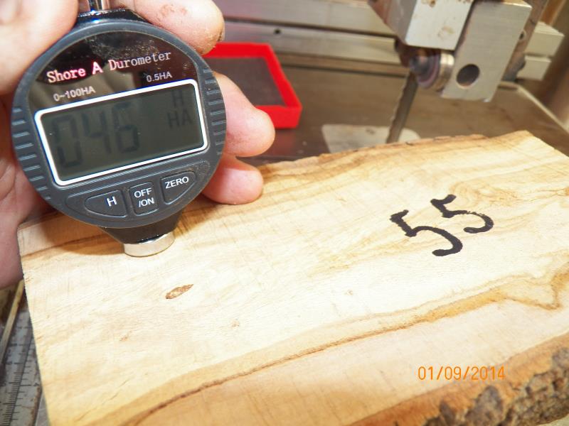

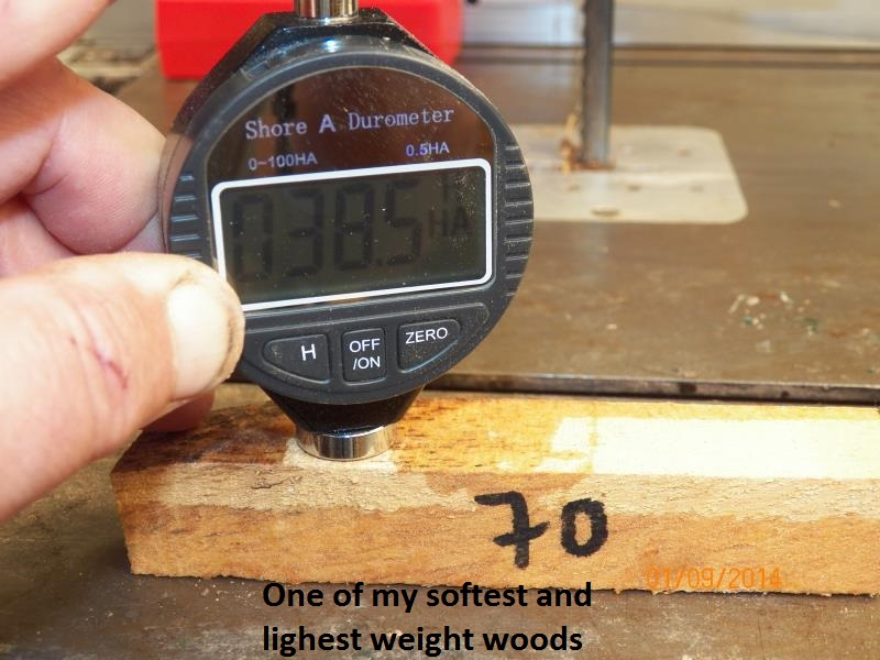

OK so, with the gauge reading the way I wanted, I started to do some testings and see what would happen/say. Next are some pics of the instrument after modified and a test that I done to confirm if I could still read the 100% the unit was made for, I used the metal bandsaw table and the results are very close, at 94% so that is the hardest it will read, on totally solid steel, wood has to read lower than that...!

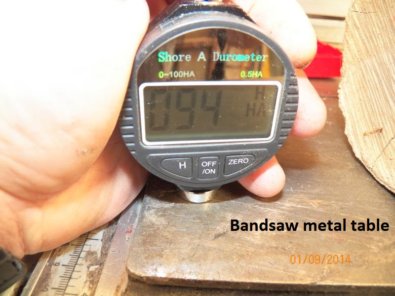

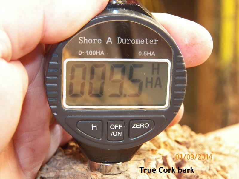

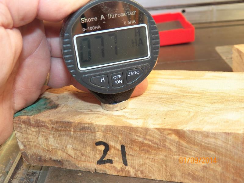

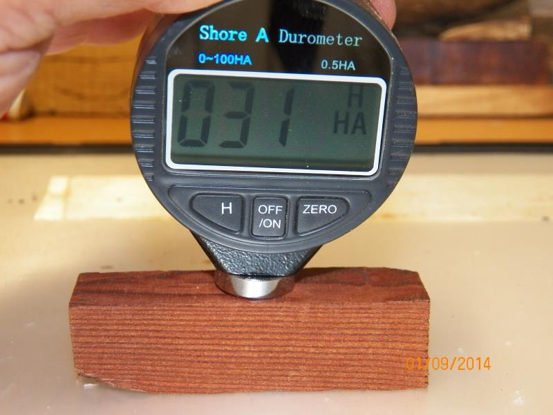

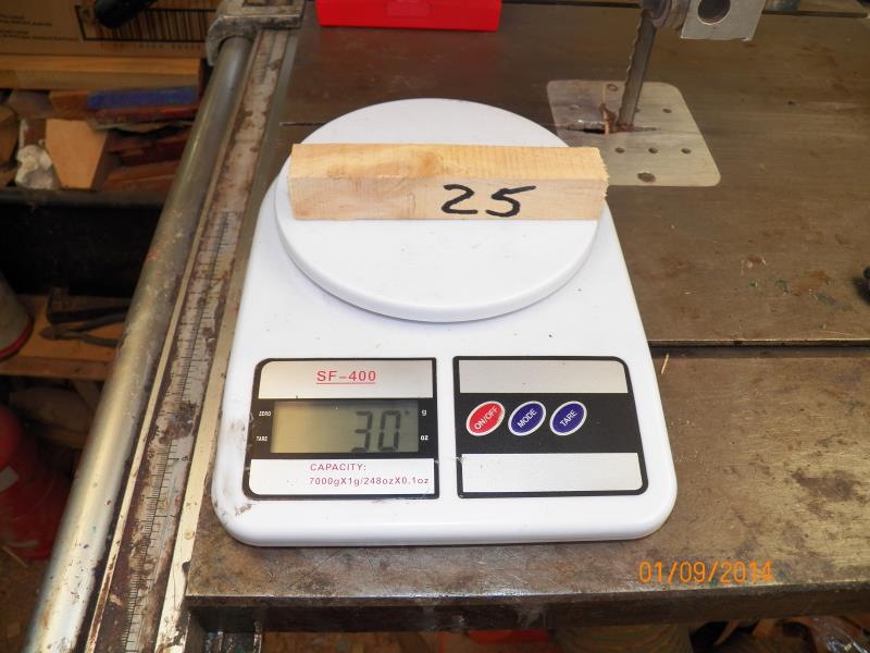

After I got the maximum reading calibrated, I decided to make some readings on materials that we all recognize as soft, and everything in between. My benchmark was to see what the readings would be with some true Cork (bark), not the softest but surely one that we are all familiar with...!

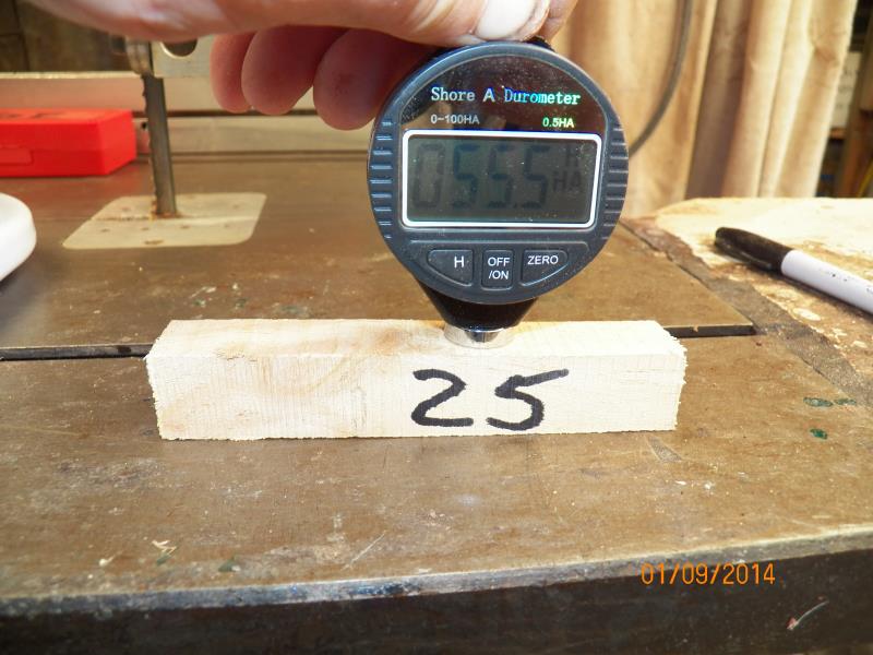

I have only one other wood/plant type material, that is softer than the Coral tree, View attachment 121570 View attachment 121571 and that is the "Century Plant", that I cut from this area a few years ago, not the one is the pic below (I got this on Google) but mine was a lot bigger, I got 7 pieces of my height (approx 170cm/67") that made it about 12 meters tall...!:eek:
This material has the same consistency and weight to the Polystyrene even though at the time, and before I got my stabilization gear, I made pen blanks and pens out of it however, I done a lot more work with this material, after I started stabilizing...!

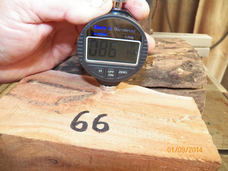

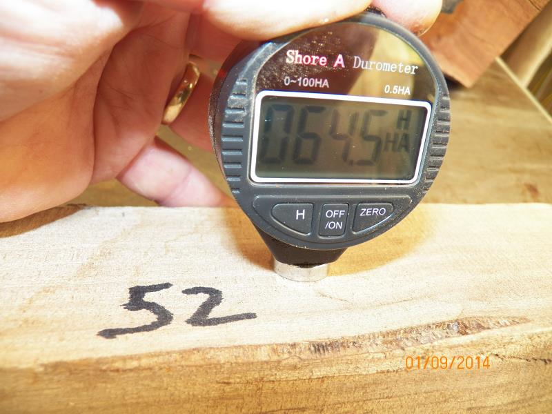

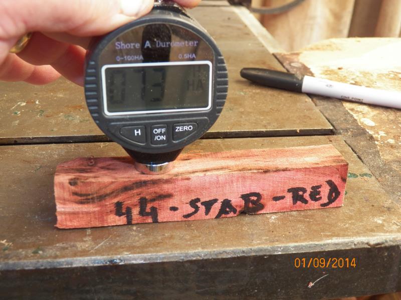

My hardest wood, is the #66 Australian Swamp Mallet Gum, that I have growing in the area, as the name indicates, this is a tough wood when properly dried.

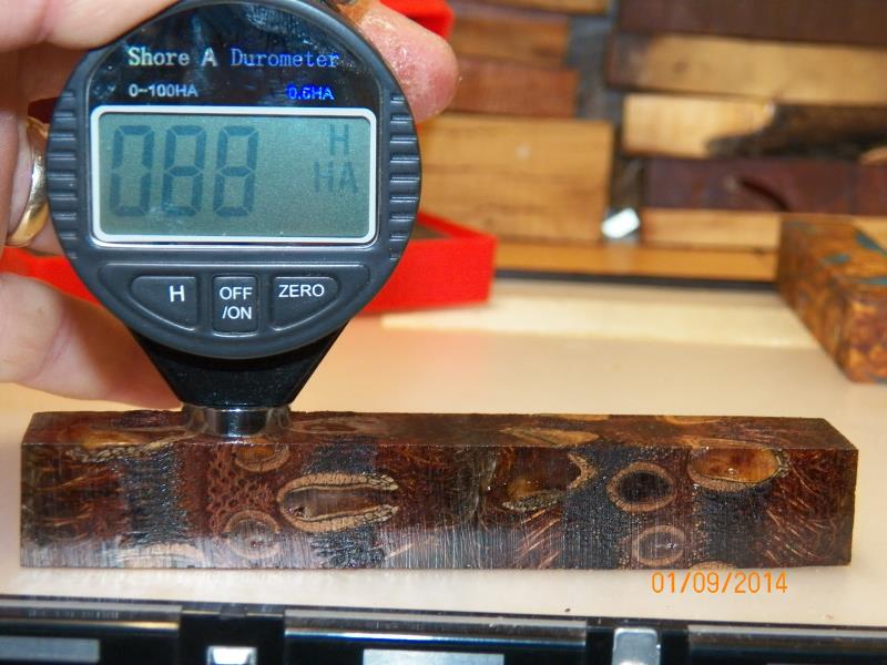

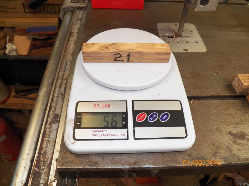

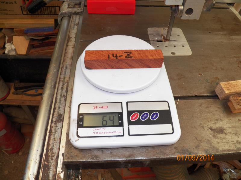

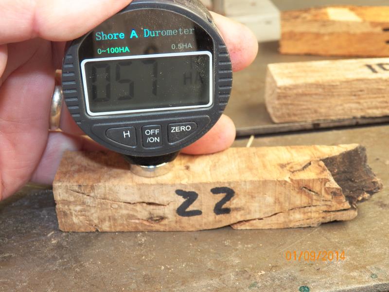

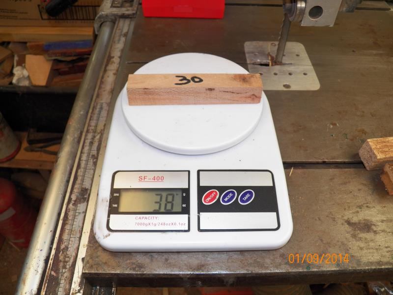

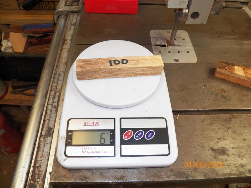

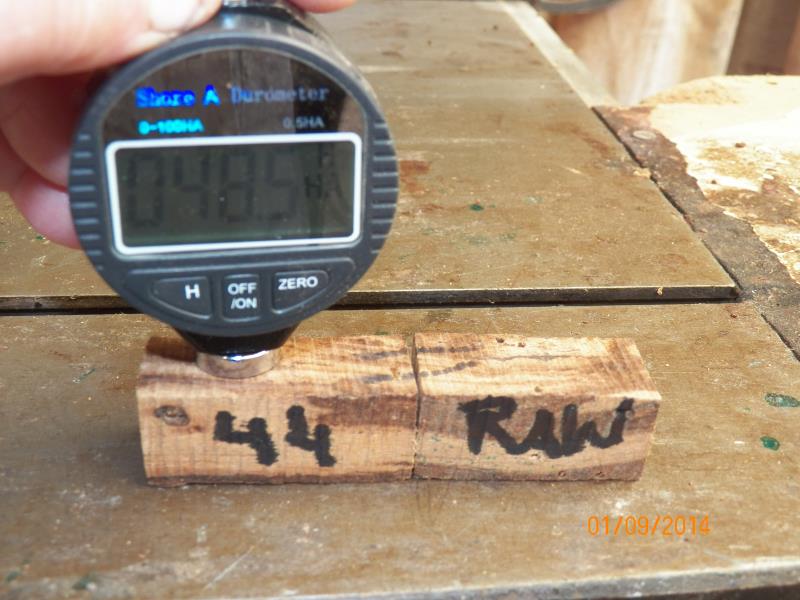

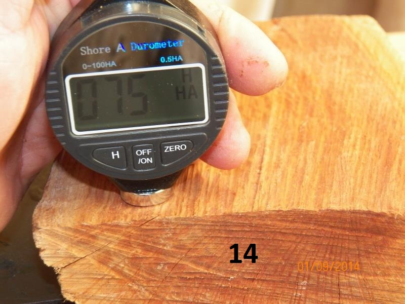

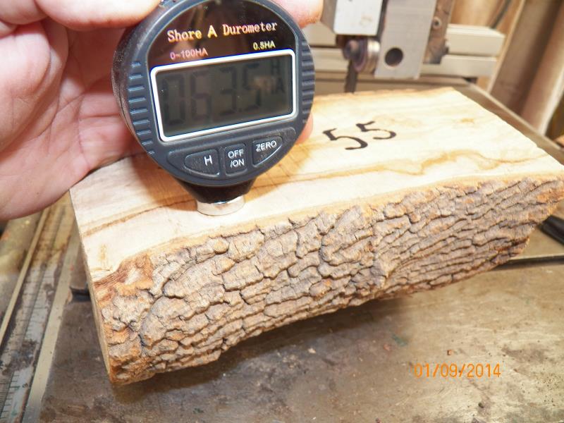

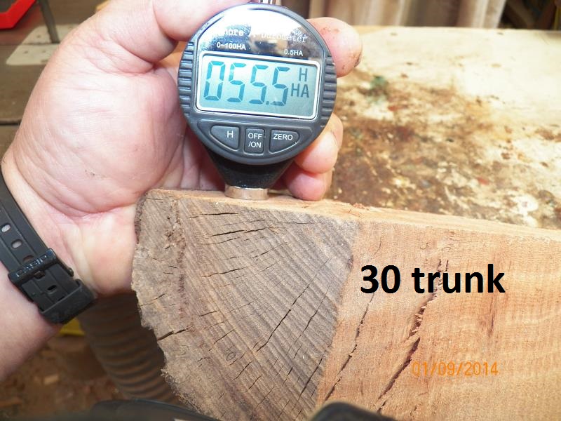

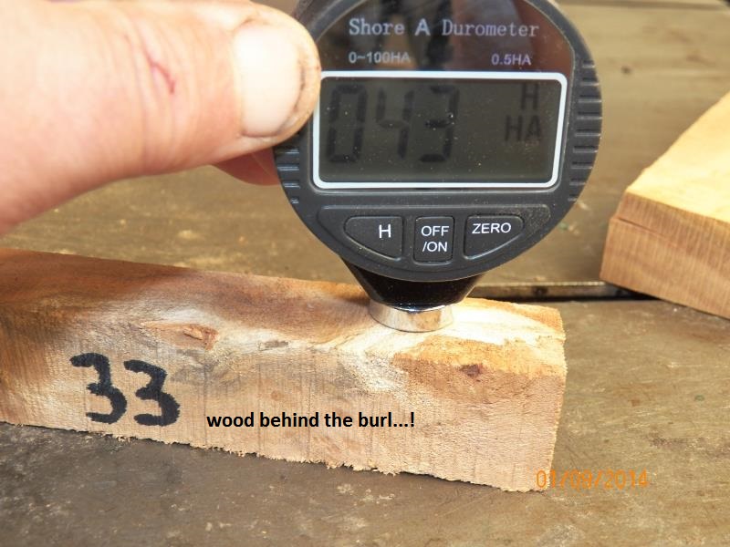

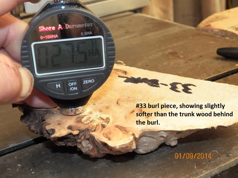

Next, is a series of pics of different of my woods tested for hardness and compared with its weight, against the hardest and heaviest woods and to the softest and lightest woods. My apologies if the digital numbers are a little difficult to read on some samples, was the position I had to put the camera to avoid the flash blindness/witness that caused it, the instrument shown the digits very clearly and vividly...!
View attachment 121590 View attachment 121591

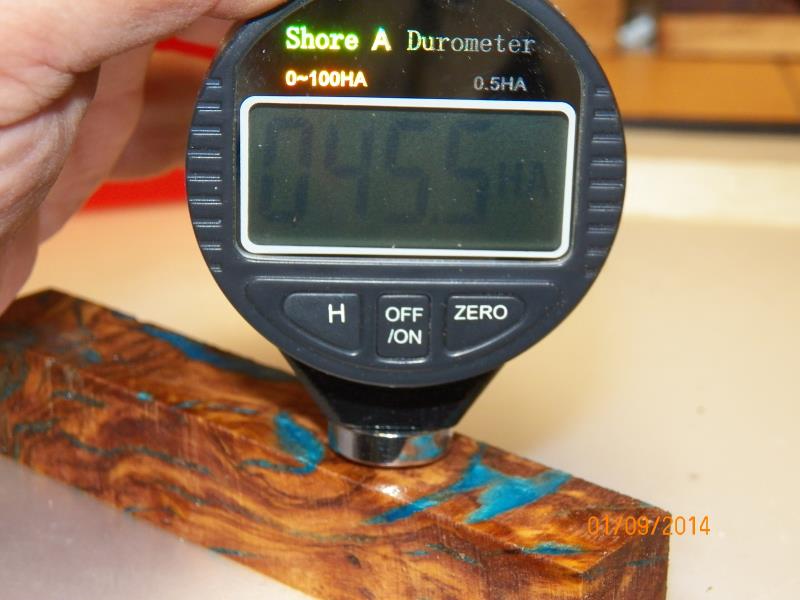

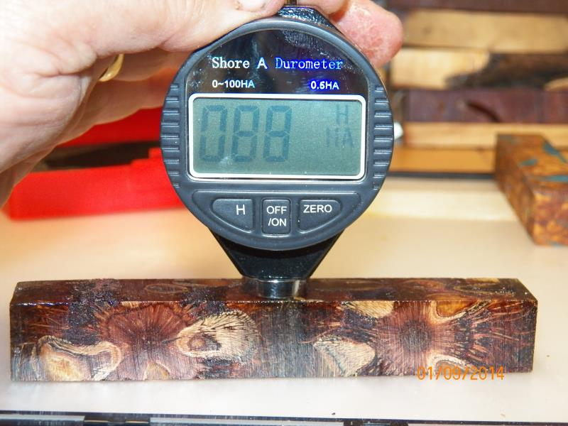

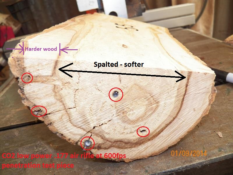

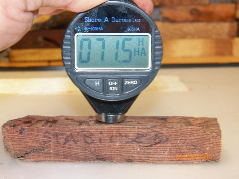

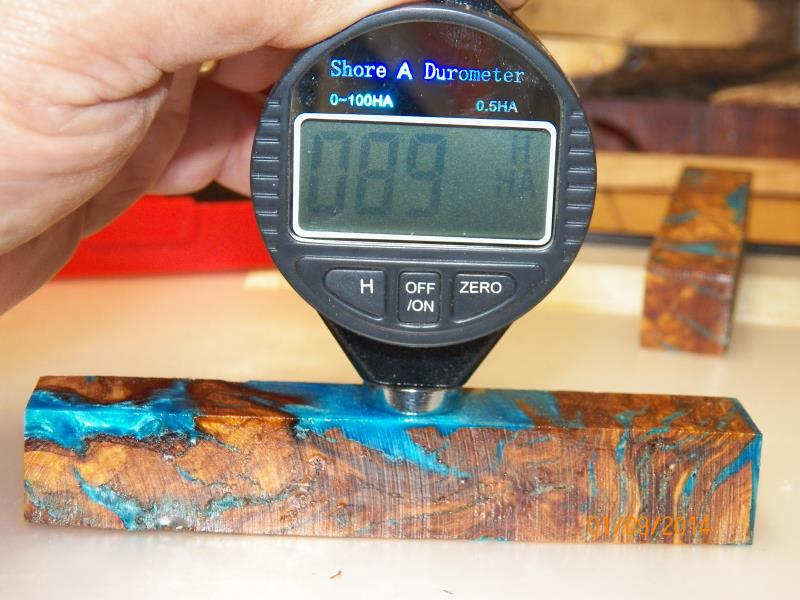

Often, the question is asked, how hard does a wood become after stabilized...???
I decided to show you this example of something that is not really wood, is 100% buoyant like cork, is not the best soaking materials, (by the contrary) however, it shows a considerable/significant hardness difference between raw and stabilized, and this is the Pine bark...!
One other common question is also, why do I have so much trouble with blanks that are made with a combination of wood(other) and resin (polyester but not only), they keep exploding on me..???
Well, one of the biggest culprits is, the hardness difference in between the materials used in that blank. Even when these blanks are made with wood and resin, various things should be considered, not all woods have the same hardness and not all acrylics/resins have the same hardness, also.
So, why do they blow appart...??? simply look at the 2 pics below, the wood used in that Resifill (cast) blank is my #22 Olive root, a very medium to soft wood, compared with the readings you see on the resin patch on that same blank so, and unless your tools are very sharp, you have the right cutting techniques or use the flap disc, any minimal catch from the transaction of the softer to the hardest material, will result in a bad chip, some separation or the blanks disintegrates in front of you and that, is not the blanks fault...!

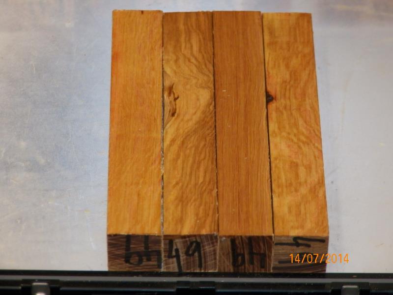

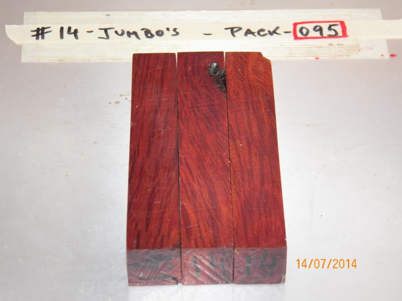

As for the She/Bull-Oak of mine being acclaimed to be the, Australian Buloke, or Allocasuarina luehmannii (buloke or bull-oak), I wish that was correct, I would be making some good money out of my stock, as I have almost weekly requests for the Buloke and I make always very clear to everyone that, even though the wood is tremendously similar in colour and grain/rays, and a relative to Buloke, the one that I sell and have in stock, is a combination of the Australian She-Oak and the Australian Buloke (Bull-Oak), and this was done buy generically mixing the 2 genes in a lab in the attempt to introduce into a specific area of the Adelaide Hills highway rest area and along the highway in that area, a tree species that had the characteristics of the She-Oak and the durability/hardness of the Bull-Oak in an attempt to make it more resistance to the Termites and other wood borers that do devore all the she-Oaks that grow naturally in this area, and they are lots of, while the Bull-Oak is more a desert tree and not natural or seen in this area/State.
The results looked promising for the first 10 or so years but, and as the trees started to reach maturity, they got badly infested with the damn bugs and Termites that have develop a way to get around the new wood characteristics, after that, they started to die and the new trees that generated amazingly from its seeds, never had much of a chance and they have been eaten faster that I can salvage some and share it to the word BUT, and even though one of my preferred woods, it does not have the hardness of the Buloke (Bull-Oak), not even close.
Possibly, a little harder than the common She-Oak from around here but never the same hardness as the Buloke.
Anyone that has worked with common She-Oak will verify that, what I've got here, is not what they are used to, if the memory doesn't fail me, this very issue was discussed extensively in the Australian Woodworkers forum, 8, 9, years ago...???
The wood in reference is the #14 on my timbers list while another relative, the Australian Casuarina that was recently (couple of years back) given its own species name, as it was found that, this one had its own gene pool and therefore a species of its own, the Australian Rock-Oak that is still call Casuarina and is #49 on my timbers list...!
Here are 2 pics of each of both these woods, enjoy...! :wink:

Whether rely on Janka hardness test chart or durometer designed to measure wood harness.
Not to keep beating the dead horse, but I am not aware of any Durometer "designed to measure wood hardness". This is after dong a LOT of research on it over the years and even going to far as to speak to the manufacturer of the durometer I do happen to own. I have even checked into buying a machine for testing Janka Hardness but they are just too far out of reach for me. They start at around $2,000!
Durometers give you Shore ratings in various different scales based on the general hardness of the group of materials you plan to measure. I am not aware of any Shore scale for wood. I ended up with a Shore D durometer because Shore D is for the hardest of the plastics and rubbers out there.

Hold on your horses gentleman, this is not a dispute on what Janka wood tests are, and what durometer shore type gauges tests on wood are or should be, nor is a case of mine is bigger than yours, type thing...!
I don't give a rat's arse on the Janka wood hardness readings, they are not something that do me any good or, resolve any of the issues that made me buy a durometer and take some readings of everyday woods I work with and that show signs of all sorts of ageing, spalting, rotting and everything in between.
Even if some of my woods have a Janka reading, that information is irrelevant to me, as by simply processing the wood on the bandsaw, I know if is hard, medium, soft, or very soft.
A single small log of many of my woods, can produce half a dozen types of wood hardness, spalting stages, rotting stages and everything in between, and this was the very reason why I thought that a durometer type D could be very useful in giving some readings that I can compare with something that I and most of us is familiar with.
Regardless of how the instrument was calibrated and to what for, the benefits are very clear to me, not some much on what the digits represent in an official or wood industry related data, to me, what I wanted to achieve with this is very simple.
If I calibrate the instrument to start reading something that I decide being the low benchmark, that being a piece of true cork, as one material that we all recognise as spongy/soft, and the instrument reads 9.5 of something, who cares what the HA stands for, it could say nothing after the digits, it would serve me no different as, are the numbers that I'm interested in, and then got to the other extreme and test the wood I know is my hardest, regardless if it has a Janka reading or not, totally irrelevant here, and the readings show 86, knowing that, that same gauge reads 96 on a flat steel surface and 89 on a patch of solid Polyester resin, I have just covered all the hardnesses I'm interested about in the woods/materials I handle/work with that are also, the same materials that many other turners around the world, have to work with from me so, the answer is very simple.
My tests are not to be compared with anything, unless, compared with other people that may have or want to have the same instrument to check their woods hardness, in a language that has nothing to do with Janka, but has a lot more to do with durometer shore D type, regardless what these instruments were originally invented for, who cares...??? really...?:wink:
Someone would ask, and about those woods that are so soft that, the durometer can't get any readings...??? Well, I made sure that I showed one example of that also, with the test on the Centenary tree #100, it doesn't need to be rotten to be that soft, this "wood" was very alive/green when I cut it and, had no resistance at all to the gauge pointed probe, I'm yet to try many other soft woods, such as the dry #31 Palm "wood".
Accuracy...?, what is accuracy is this case...??? if I'm testing a blank/board that I see has soft patches, and I don't want to put a screw driver on it or any other sharp pointed object and spoil it, is a lot easier to make the decision on what I will need to do, so that becomes "workable" to me and particular/specially to others, with my own wood stabilization gear, I see no point is offering for sale blanks that most people can't handle, sure they can be lightweight so, I can fit lots of blanks in a bag/box, and they are cheaper than the rest however, I know exactly what will happen, before I could stabilize my own blanks, I would restrain myself to put any of them on sale and when I did, I did so with lots of warnings about it but still, I had a lot of complains from people that only did look to the price and the number of blanks they could get in a 500gr parcel...!
Anyways, lets RECAP and make a few things clear, it may have been better it I had used on the thread title the word "softness" than "hardness", and again, may not have made any difference so, let me repeat this again, this thread of mine, has absolutely nothing to do with Janka wood tests and the data that is available about wood species that have been tested with such instrument, my readings have nothing to do with Janka and as far as I'm concerned, I have heard the word Janka mentioned enough times so, that's enough of it...!
Secondly, the thread was/is intended to exemplify of how very cheaply, anyone can get an instrument that is a good tool and "ACCESSORY" to use, to determine with sufficient accuracy, what I wanted to use it for and that is, have my own data of what I have to work with and then have something that can measure and determine the results of the work/processes, you put into place, such as compare the before and after.
It doesn't matter, if you don't see a need for one or not, that is entirely up to you however, if you didn't know what a durometer was, the various types, its suggested uses and the many uses the instrument can be suitable to, I believe my thread may give you some answers that you always wanted to know but you didn't know how, easy to understand, huh...!:wink::biggrin:
So, anyone that actually has questions and would like to talk a little more about the instrument that I used on my demonstration, and keep it within of what it really means, is most welcome to do so...!:)

George, that explains a problem I have...in reverse! I inlay turquoise into fragile mulberry crown wood. When turning, the wood often shatters at the join with the stone.
robutacion
Aug 6, 2009
6,514
Australia - SA Adelaide Hills
That's not really in reverse Sharon, depending of the hardness/softness of the wood you use of that cast, it may have needed some stabilizing before cast.
Depending upon the way the blanks was positioned on the lathe, will determine which material (wood or resin) the gouge will cut/touch first, the transition of hard too soft is no less damaging than the other way around, those 2 very differents densities get punished in different ways and sometimes things fall appart...!
It makes good sense to soak some super thin CA at the materials joints, even if you don't see any crack or separation, believe me, they can be there and you won't see it...!
Repeat on every joint of each blank, let it dry overnight if possible and then proceed..!
If the wood is too soft, have it stabilized first, it will save you lots of troubles later on...!
Another piece of advice is that, when you cast certain woods, 2 things can happen, if the wood was stabilized first, and the wood wasn't cooked bone dry, when you cast it with PR (the one I know of) you can get a sticky layer in between the juice surface and the resin, this layer will not allow the resin to adhere properly and later on, the 2 materials will separate partially or totally however, if you see that happening, you need to get the blanks in the oven under 70° celsius for a couple of hours. What it happens is that, that sticky layer formed if let to dry normally it will do so but it won't bond the 2 materials but, putting the blank under this medium temp for 2 hours, it cooks the sticky surface into the wood surface without altering too much the PR brittleness so, you endup with a very strong bond as a result.
The second suggestion is that, with PR casting, if the wood is row but has the slightest amount of natural oils, when you take the molds out of the pot, the resin may seem hard/solid but, when you start cutting them appart (if a block is the result), you will notice a similar sticky layer between the wood and resin, similar to the stabilized blanks, in that case, waste no time and do the same cooking process as explained before, that sticky layer from the PR, it only stays there for a short period of time , it will start to harden as soon as air get to it but, it won't improve the adhesion between the 2 materials if you let the air dry it while, if put under the suggested temp, the resin will slightly soften and expand towards the wood when that temp is reached, from then on, the 2 materials stay together without the need to be clamped, only in a few occasions clamping is necessary and unless you have all metal clamps, you will need to sandwich the casting between 2 solid boards and screw them together while in the oven...!
Well, there is a lot more to it but, I hope these few "clues"/suggestions can be of some use to you and others...!:wink::biggrin:
