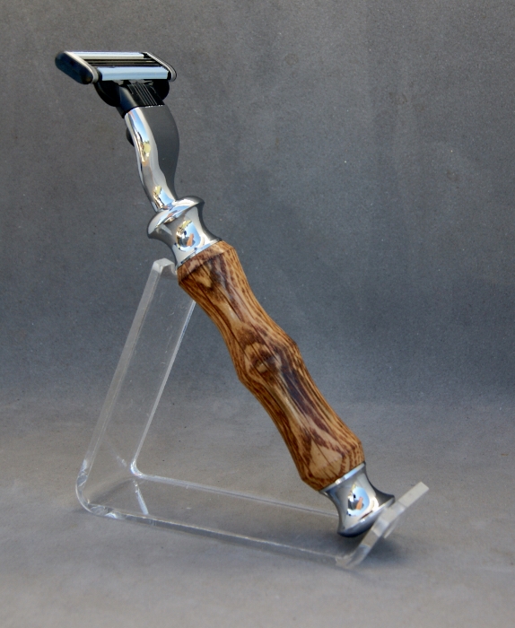

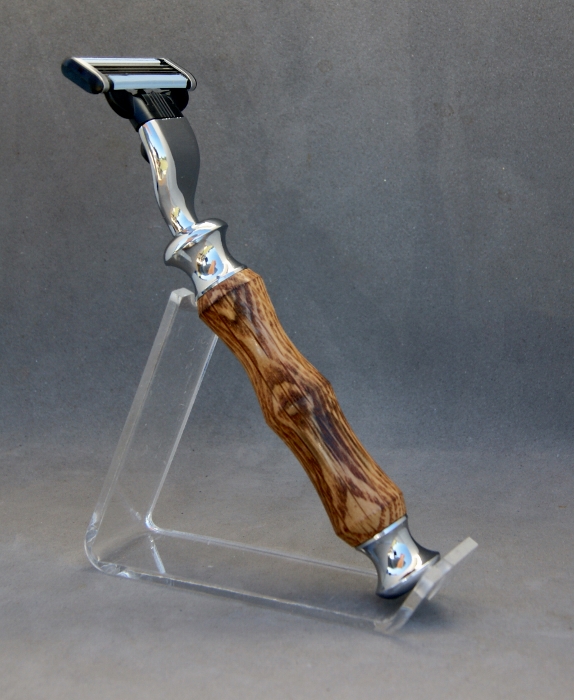

I think it was Brooks that posted a razor set using white oak. I had asked about using wood for a razor and was told that the white oak is what they use in barrels and that it wood be ok.
Yup...it was me. As a safety net I also applied a couple coats of TruOil finish. Just to make sure any of the softer grain was filled in.
If you are planning on using wood just make sure it's either stabilized, or a wood with very tight grain. Also apply a little CA to the ends of the barrels after trimming to seal them. That'll help keep water from being absorbed, and with expansion in the humidity.
