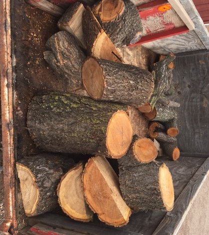

Has anyone tried using white wood glue (like Elmer's or tri bond) to seal the ends of logs. I was given a load of apricot logs that I want to cut and seal. I was told that the glue would work better than latex paint (I am out of anchor seal). Any experience with this?
I cut a few logs in half and rough turned a few bowls, beautiful wood.

I think wood glue would work although it seems like overkill and more expensive than a wood sealer. If you have the latex paint I would use some of that until you can get some wood sealer. I use the rockler green wood sealer but an luck enough to have a store 5 mins away so no trouble if I run out. That said a gallon lasts quite a while.

How soon do you want to work it. If just a few weeks, fill a garbage can with water and submerge them. No cracking loss at all. All other options, especially in Az this time of year, will result in cracking.

This is a good use for old wood glue. Have had better success with it than with latex paint. Latex interior is little better than nothing, and exterior latex is better than interior. Wax (or wax emulsion) is better than glue. I have used cradt style white glue and old titebond (thinned a little for spresding) and could not see the difference between the glues.
Melted paraffin was better than glue.
Saw a paper on the different coatings several years back --AAW Journal perhaps--- that had similar outcomes.
Then there is the boiling approach......
