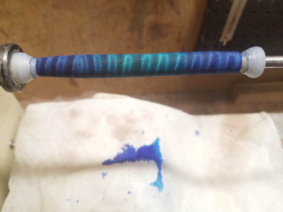

I had to dye some wood purple the other day . Found nothing online .
I ended up using clothing dyes ....
I mix the dyes in denature alcohol .
I have been using a lot of water based dyes that I get from woodcraft. Water based dyes are great and you can do a lot of crazy colors. The key is it must be closer to the final diameter because even though the dyes are thin and they soak in way better than stain, they still don't penetrate.
But, if you're doing thin slices and dye them once sliced I think they will penetrate thoroughly from the end grain because it is very absorbent.
Lewis
