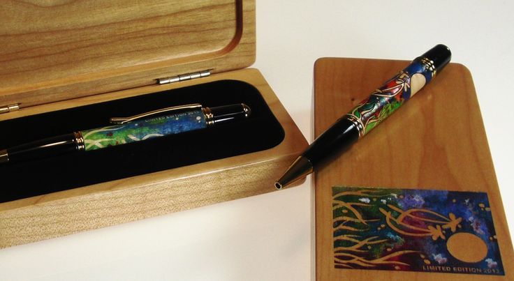

If you search for "Binh Pho pen" you might find a few more besides this image. I've seen a pen that was made by Jerry Sambrook and then decorated by Binh Pho (woodburning and airbrushing), I don't remember seeing this pen and box before.
I think that Binh Pho was featured in a past issue of the AAW magazine. Can do wood burning (wife's job) and airbrushing. Need to brush up on my skills (no pun intended but it did sound cute).
Yes he was featured in American Woodturner magazine.
I had the good fortune to see him demonstrate a couple of times at the Fuller Craft Museum and to take a hands-on class with him. I took with me a small lidded box (some random wood, perhaps apple) and asked him if he thought it was suitable for the decorating methods he used - he said "Let's see" and took it from me. It has pride of place on my display shelf - my crappy little box with a panel that has two dragonflies by the master.
