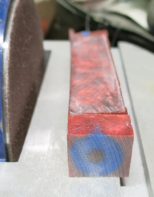

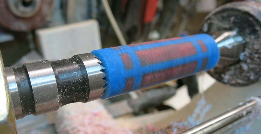

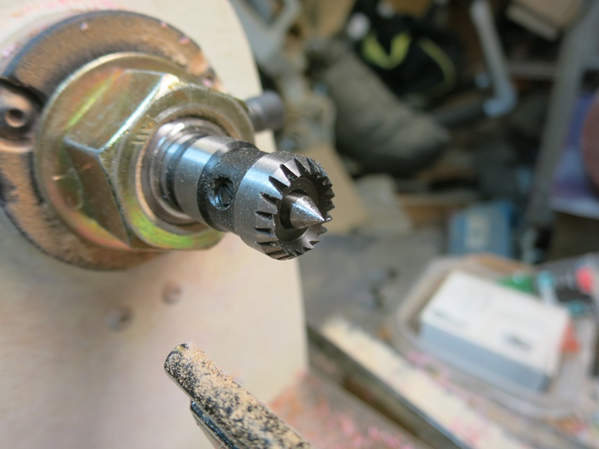

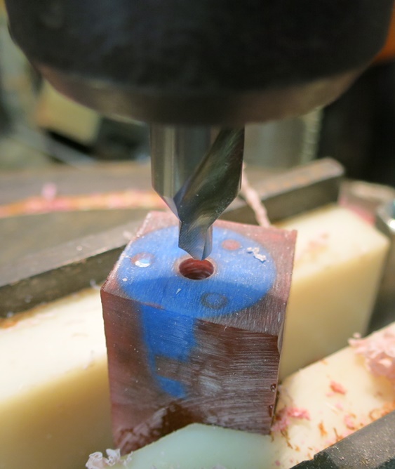

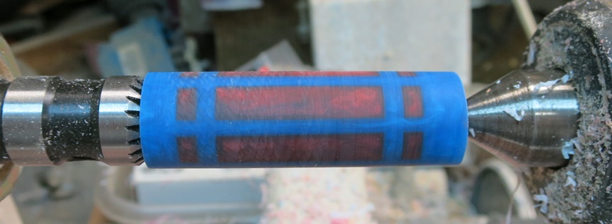

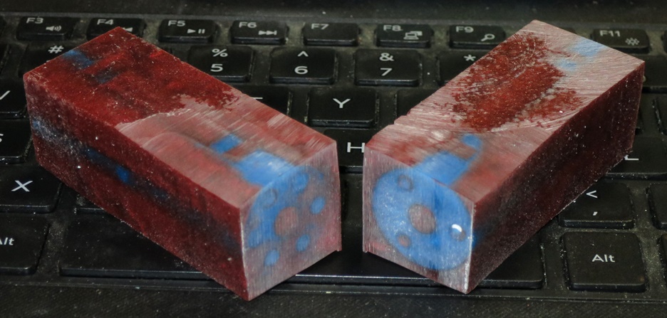

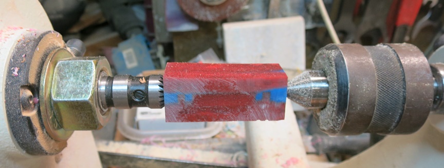

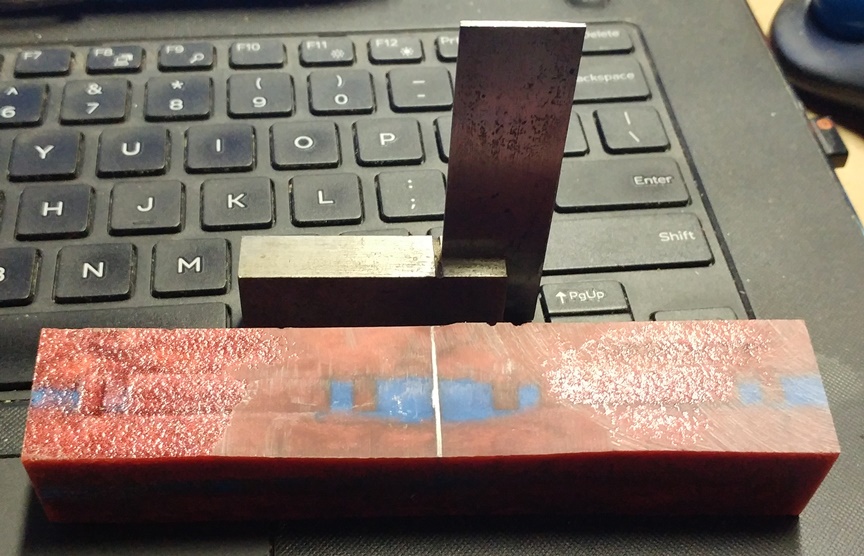

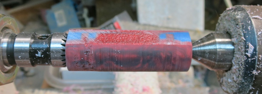

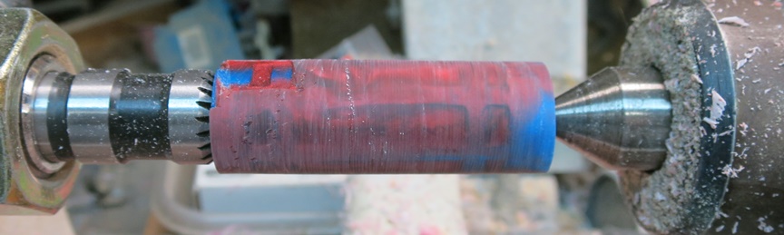

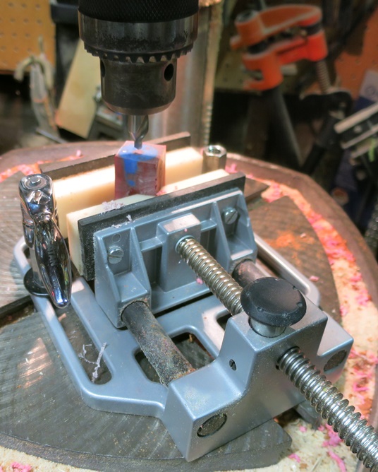

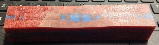

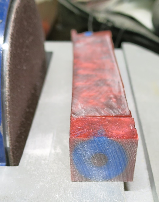

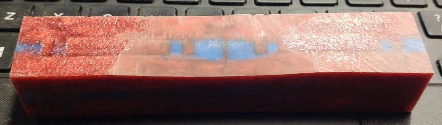

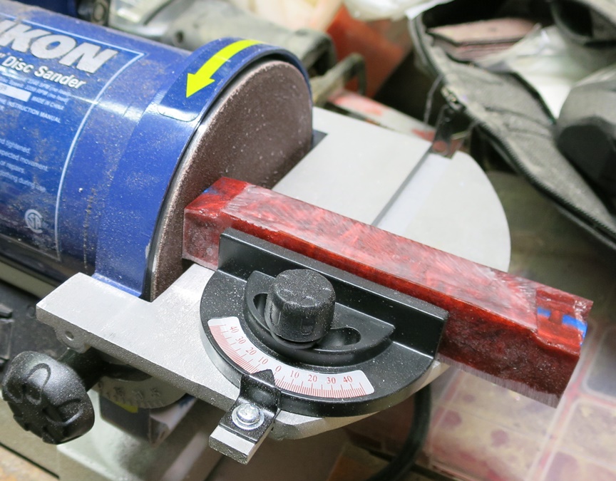

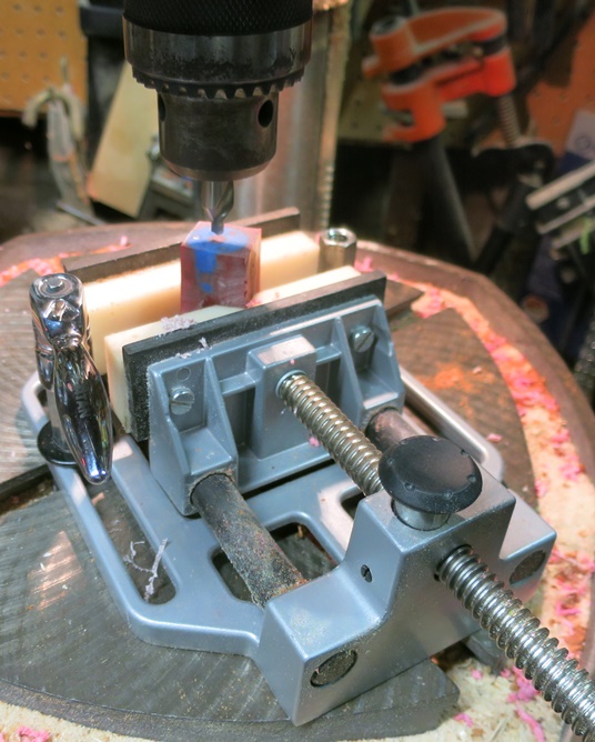

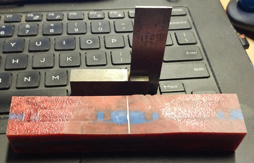

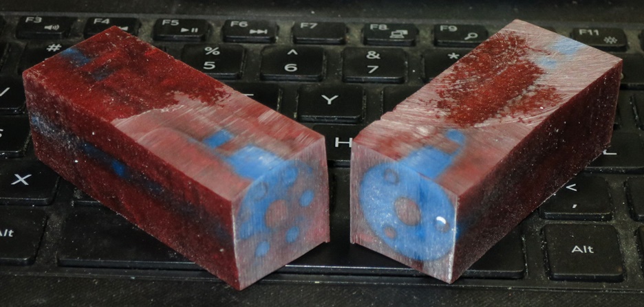

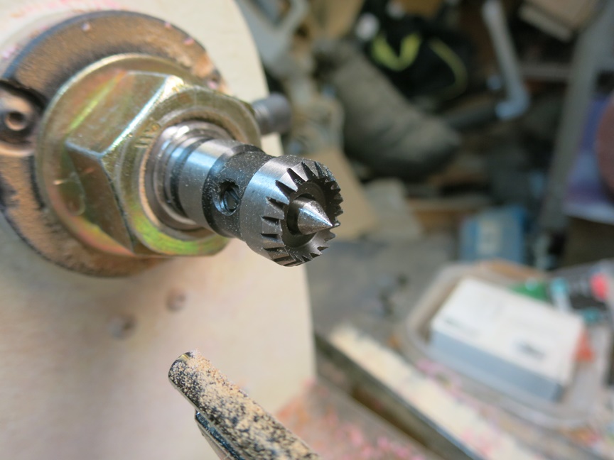

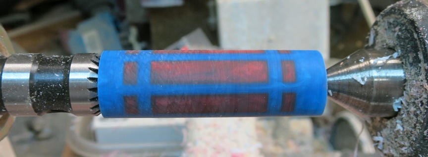

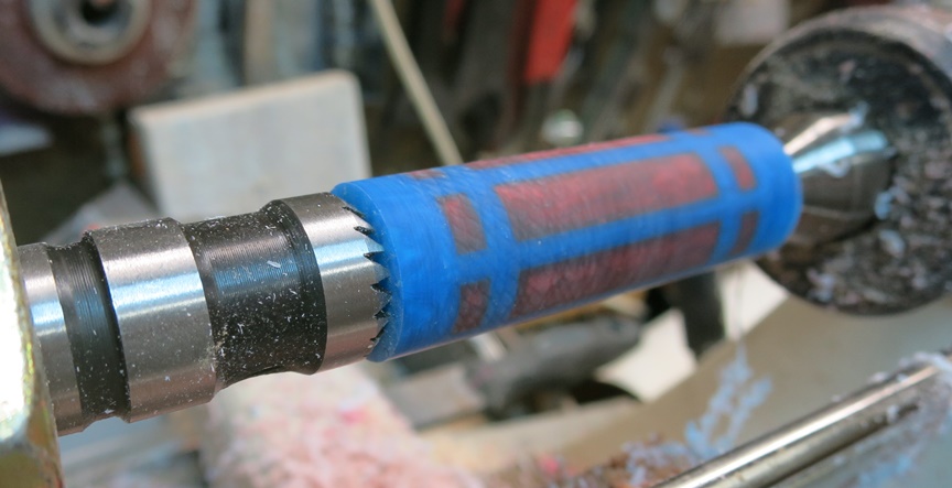

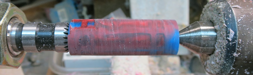

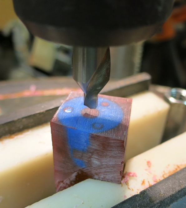

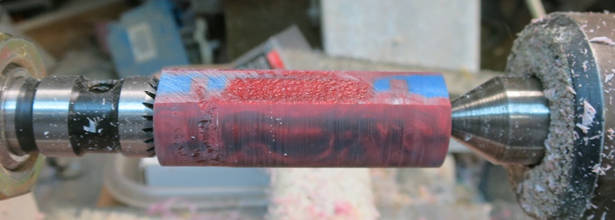

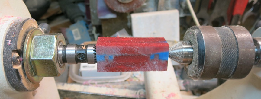

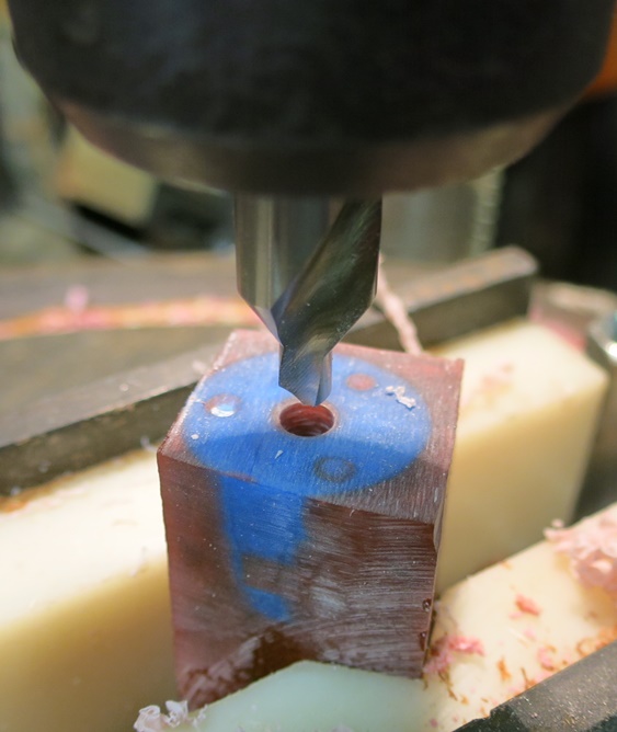

Last year, a friend of mine commissioned me to make him a Chicago Cubs pen. He chose a Wonder Windows blue and red blank. Life got in the way, but I'm finally getting to it. I trimmed the blank so I could see the centers of the pattern, and drilled pilot holes with a center drill. I used a Steb Center style drive from CSUSA, which worked surprisingly well. I took very, very light cuts, first with a roughing gouge, then with a carbide chisel. So now I have it turned relatively round, but have to figure out how to drill it completely centered. I'm open to suggestions.

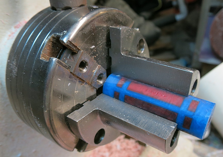

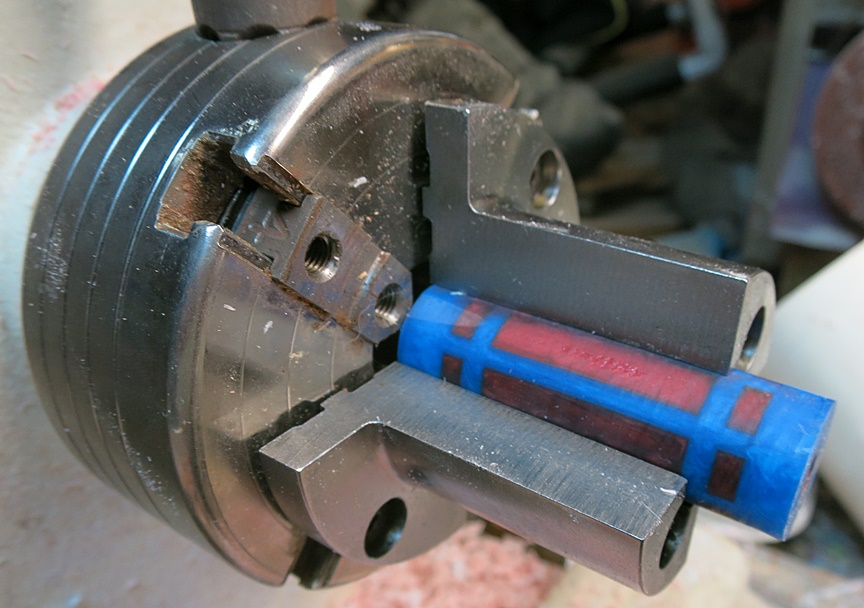

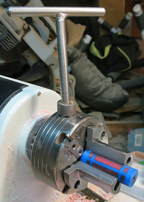

I thought about that, but the pen drilling jaws are a lot longer than the standard jaws. To my way of thinking, it will hold the blank straighter during drilling.

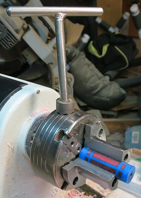

It did come with instructions. That's where I got the idea of cutting it in half to see the center of the pattern and using the center drill. It's as round and centered as I can get it. I'm confident that it can be drilled accurately with the Nova chuck jaws that I ordered. You're right, it is an expensive, as well as complex blank. I didn't realize it would be this difficult when my friend chose it. The pen kit he chose is a magnetic Vertex rollerball with one turned body, so I have two chances to get it right.

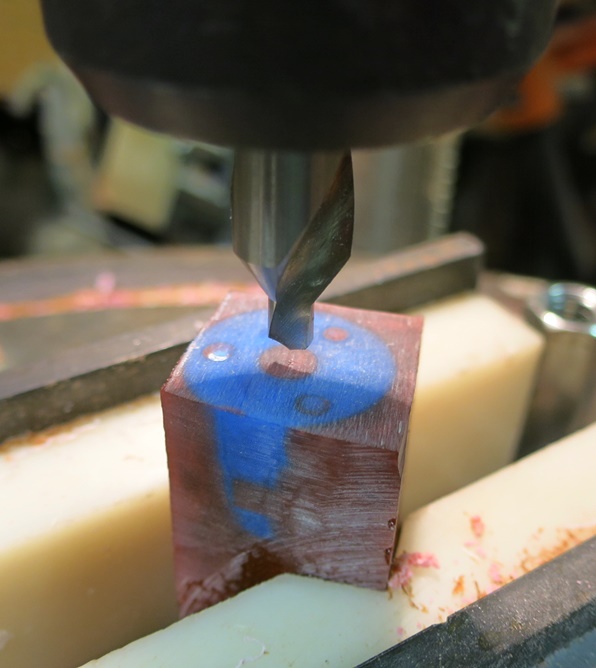

I drill antler in exactly the same way you do because it allows you to see the entrance and exit points. You might be right about it being the way to do it.

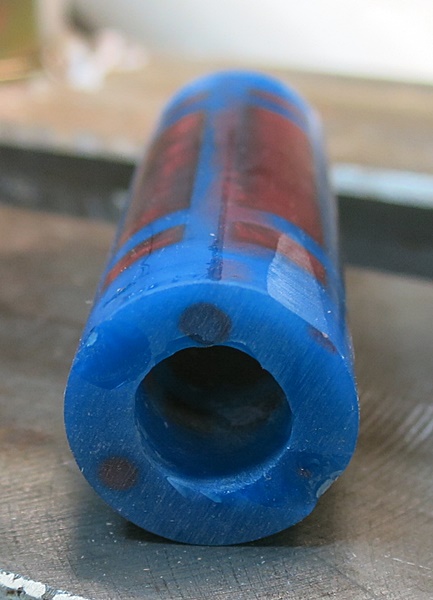

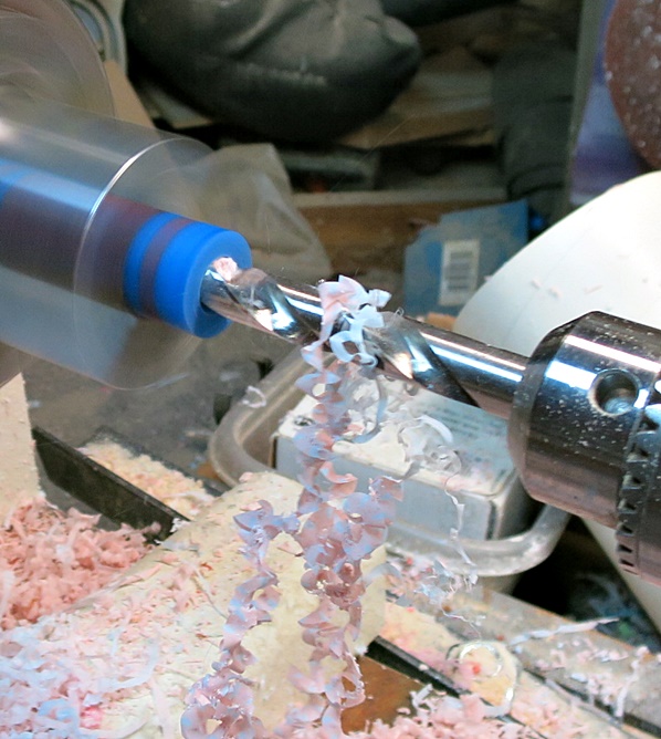

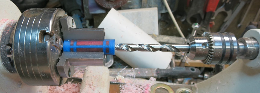

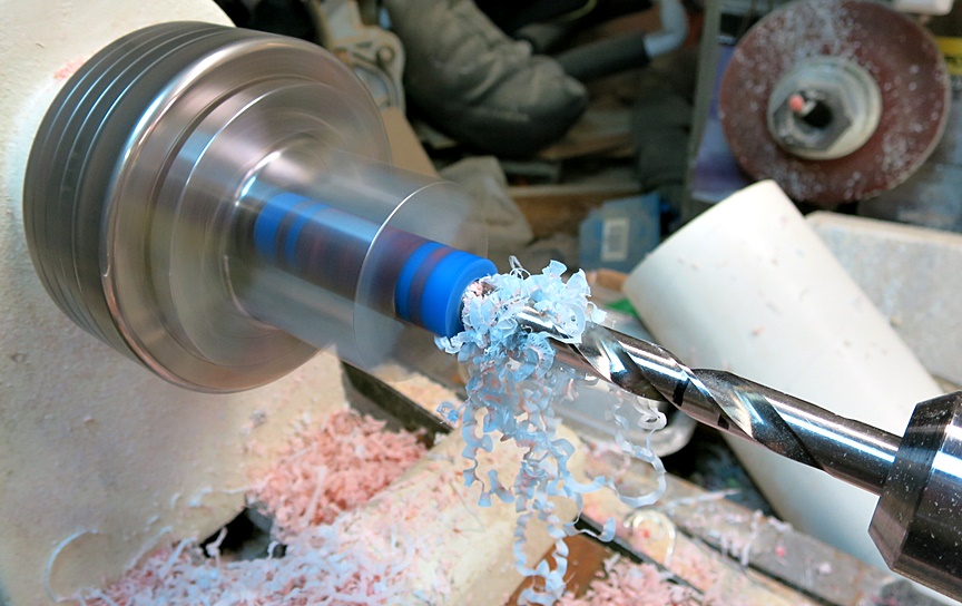

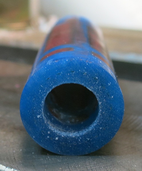

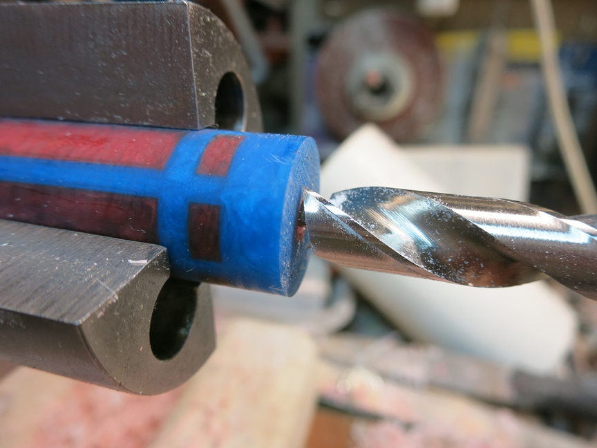

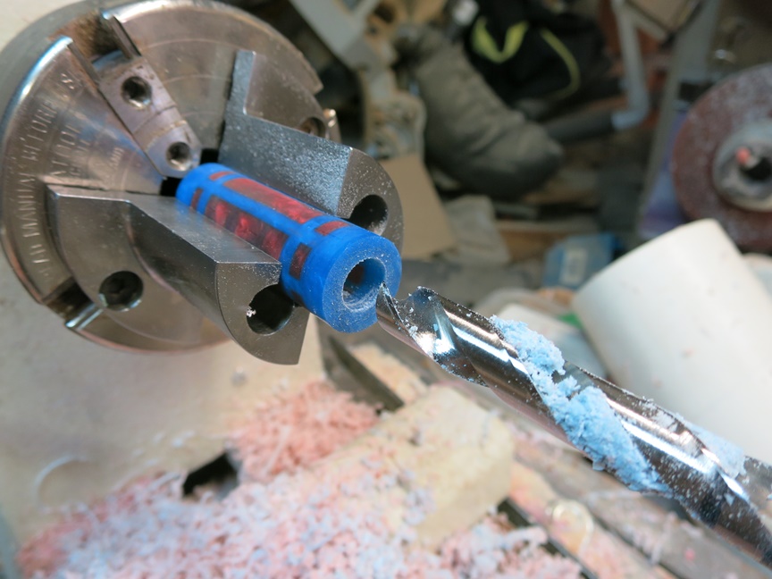

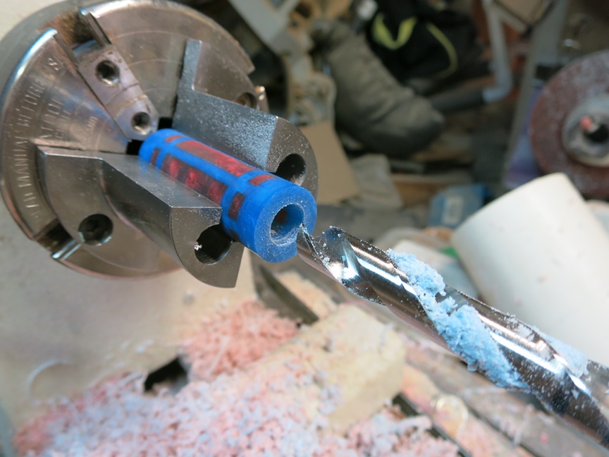

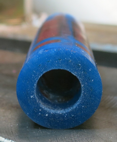

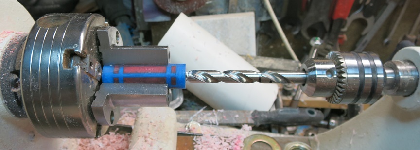

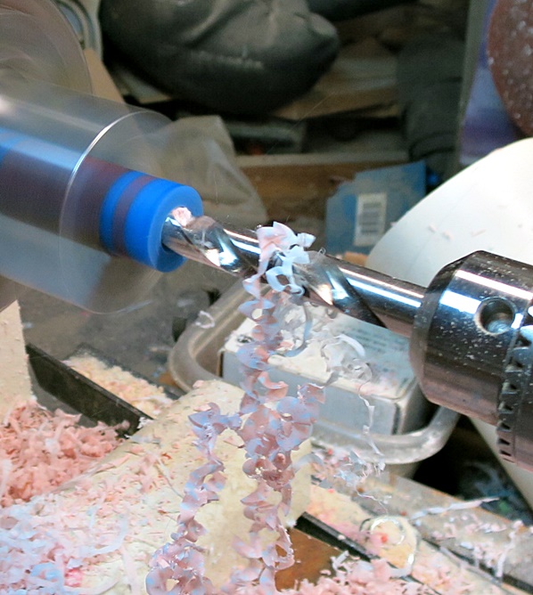

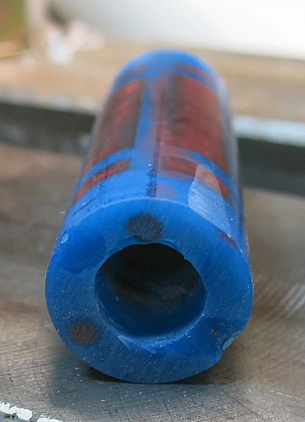

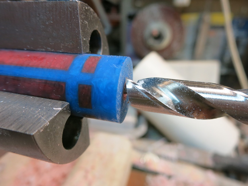

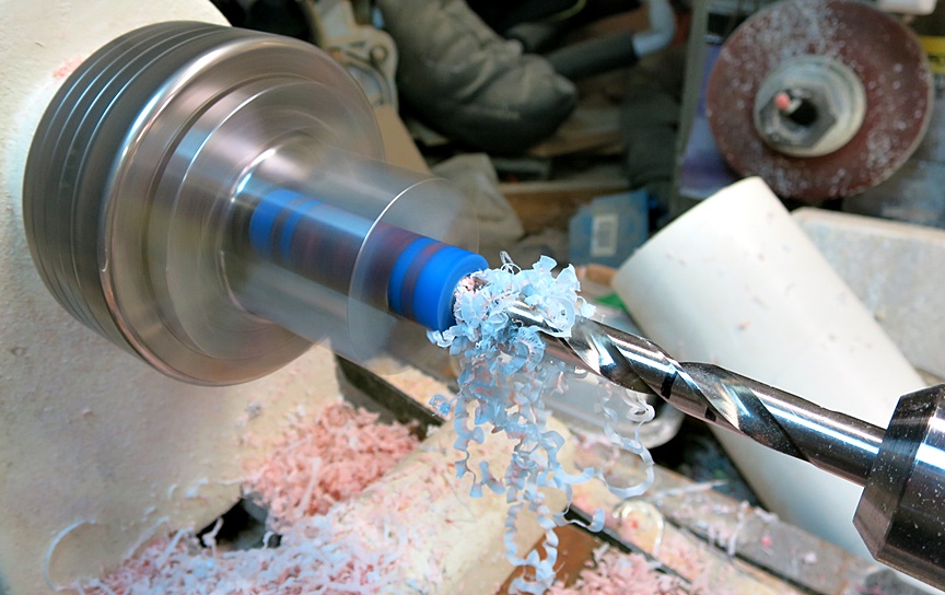

The blank drilling jaws worked better than I hoped.
