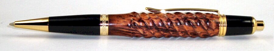

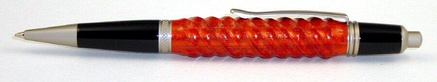

Here are a couple new shapes, at least for me, fresh off the Beall Pen Wizard...can you guess what the Wiz setup looked like?
Padauk:
Cocobolo:
Munsterlander

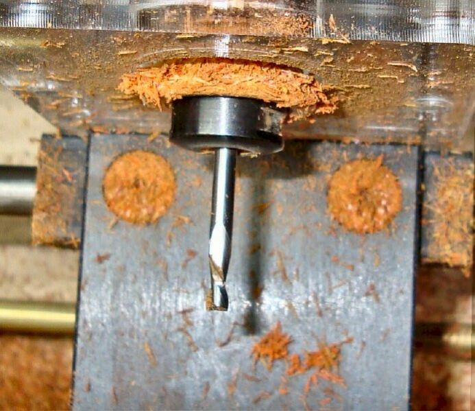

Thanks everyone. Here's a photo of the bur I'm using. It's the 1/8" square-end mill sold by Beall. The setup and process is exactly as JR shows in his YouTube video on making a six sided (polygonal) pen (cut from the side, not the top). except he has disengaged the spiraling gears and I did not.
The trick with this twist pattern is getting down in the groves to sand. There is a real easy way to do this - use cloth backed sandpaper, tear a strip off about 1/4" wide and 6" long, then twist the sandpaper into a long tube. Think of toweling your back dry after a shower - that's the process.
Think I need to make a video on this, huh...?

I'm a little lost here Ed..I posted a pen a week ago or so doing the bit the same way, except mine came out a spiral flat...how deep is that bit down? Is the square end doing the work? I have made spirals like that on a legacy with a different bit and can't sell one..people believe it will be uncomfortable to use...
Towel my back dry??? Isn't that what the wife is for!?:biggrin:
Looks great...I was going to say you had it mounted on the side and at an angle, like maybe 60 degrees from the pen. I am wrong..guess now you have to try that!
