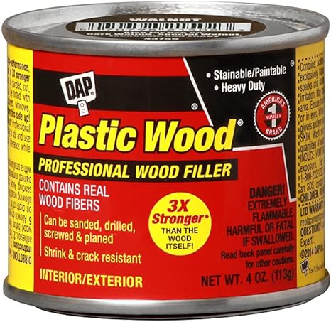

So this is my weapon of choice for wood filler, that will not show. MY whole life, I use a little and by next time its dried out to the point I just throw it away and buy new. There's tiny little print on the can saying if it dries out, just add a little acetone to the can and voila, good as new, I tried it, and it worked fine My other perplexing question regarding this product....... Why do they print the cans upside down?

Storing upside down the product creates a seal
In a way. The product in the can is not liquid but when it comes the can is actually not full. It is about 3/4 full. If you open a new can and push the product down into the can you will see there is alot of air in it. To prevent the product from drying in the can it is stored upside down and the air is now trapped at the opposite end of can which is the bottom and the product oozes to the lid. Basically how you would store paint cans but it is not as liquid.
One tip is after you take out what you need, immediately close the lid and if you have enough product do not put any leftover in can because you now introduced more air. The air bubble things only works as long as there is enough to seal the can. best to buy in small cans. waste less.
I remember my father adding light weight motor oil in it to loosen up. Just a couple drops. Not sure if the product has changed over the years but that tip worked.
The idea was good but you need to scrape the sides to get the product to the center of can again because the shear weight of it is what they depend on to reseal the can again when you flip it over. But if there is a big hole in the center than that seal will not work and yes it dries out. But boy does that stuff dry hard and never cracks.
