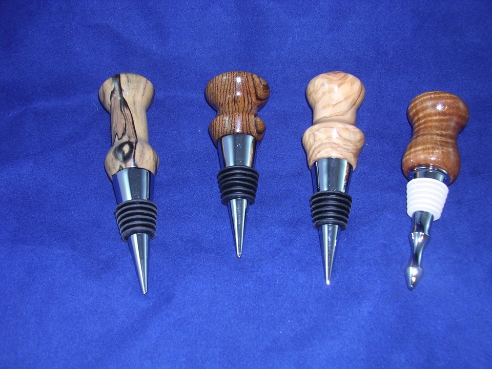

Even though I don't drink wine I have made several of these. I enjoy making them and have give many away.
