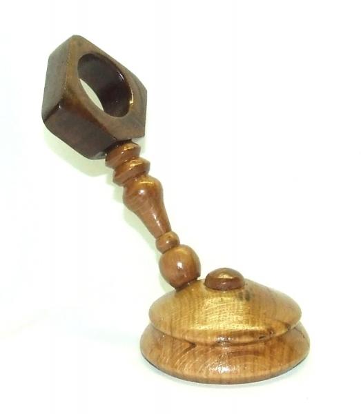

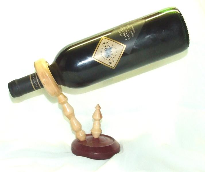

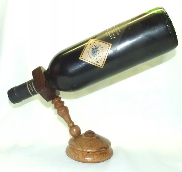

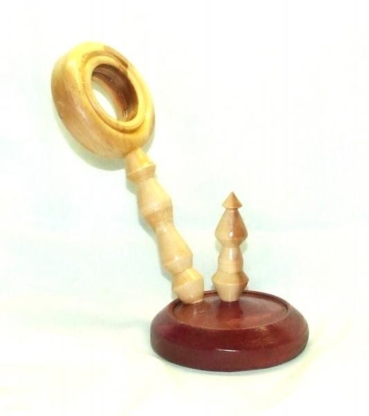

I make mine at a 45 degree angle...
glennw
Nov 15, 2005
187
WAYCROSS, GA
landfiller I was going to ask the very question you stated my answer I needed before I could ask.But I will ask anyway because some one else may have a different way. On what angle if any do i drill the hole for the bottle i did it straight down but i cant get it to stand I did cut the bottom on a 40 degree angle.
Jul 9, 2007
1,706
warren, michigan, USA.
I cut mine at 45 degrees that may make it stand better?i have had no issues balancing about any wine bottle on mine that are 9-13" long x just under 3" wide.I do use thicker then 3/4" stock though I know it can be done,but I use 7/8-1" thick for the most part.The hole is only about two inches from the top.Hope that helps out,Victor
