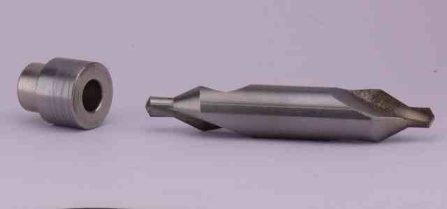

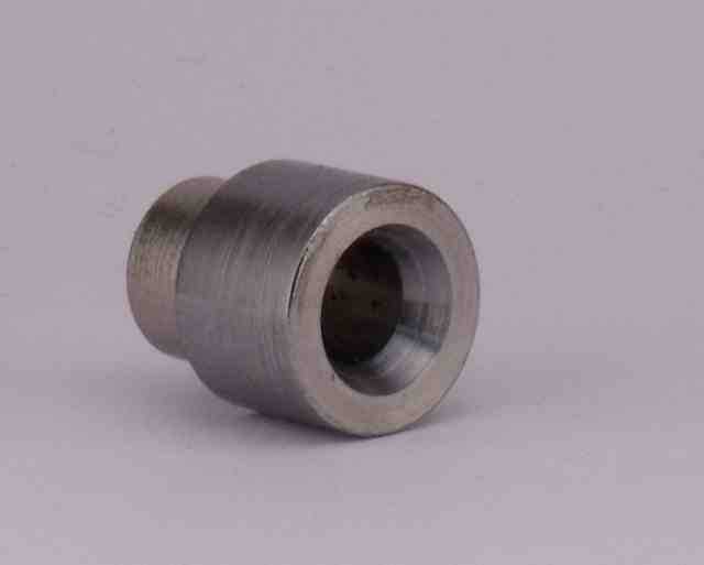

Just use your existing bushings and use a centre drill on the outside end.
Dead centre in the headstock and a live centre in the tailstock and Bob's your uncle!!:wink:
